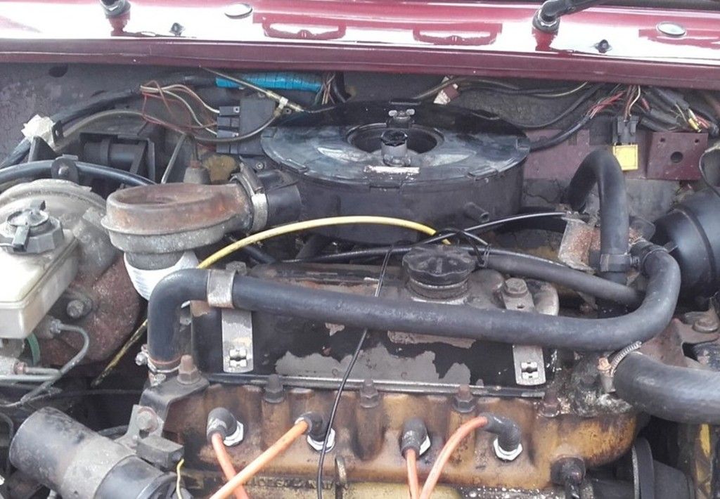

*Thread resurection*
Anyone ever tried this?
I'm bored of the 'snorkel' - and of the airbox sucking hot air directely from the radiator's surface. The snorkel is not ideal, nor is the position of the actual airbox inlet. So turning it by about 90° should give some improvements (if only illusive ones >_<). Anyone ever done it? >_<
Cheers,
Jan
PS: remeber - on '59 Minis it was the same situation... The turned the airbox intake away from the rad - and all following airboxes did saty the same way, except the Cooper RSP 'box which came from the Metro - which had a front rad.
Edited by Asphalt, 04 June 2009 - 05:42 PM.

Posted 04 June 2016 - 06:27 AM
I
Another thread resurection, how is it possible to turn it like this?:P
#14 THE ANORAK
THE ANORAK
  • 3,946 posts
  • Location: rugby
Posted 04 June 2016 - 08:21 AM
wow, old thread, cant remember any of it !!!!
dont know how thats been turned like that. not sure how its possible without serious mods. but it is now looking more like the standard 998box. that valve sticking out on the cooper box is just a really over engineered hot air valve and pointless. considering the price of these cooper boxes and trunks these days i would get one of the 998 ones and see if that fits. again, remove the silly hot air valve (bed pan thing)
Edited by THE ANORAK, 04 June 2016 - 08:22 AM.
