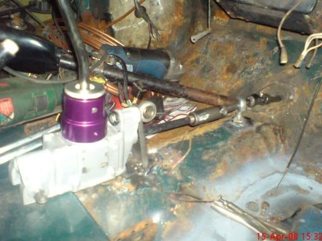

The center pipe normally kicks down under(around) gear linkage on a road car, on the miglia`s they run it high up into the two rear boxes then out where the rear valence was as this is also cut out, rear subframe is modded with rear section cut out and replaced with box section set further back
This how i`ve done my internal linkage

Do you not have a steady bar? Any gear change problems?
