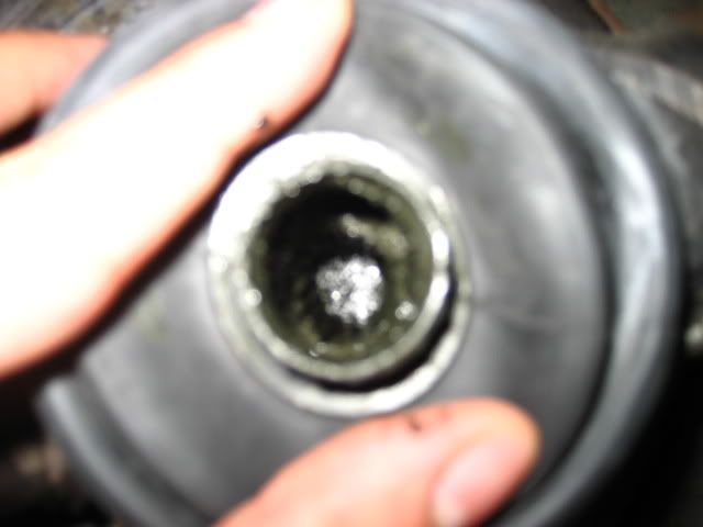

Posted 08 April 2008 - 03:52 AM
Ok i took it out and this is the best pics i could get..
Does it look like from the image that the drive shaft looks ok? it does to me??
Also what is the split ring retainer?? And how do i make it free ?
Thanks Ethel
Cheers Adam

Posted 09 April 2008 - 09:23 PM
in the groove thats 5-10mm from the end of the shaft there should be a "C" clip that will retain the shaft in the CV joint
http://www.minispare....aspx?pid=33154
it will be worth removing the gaiter from the cv joint and cleaning all the grease out incase the original clip has broken and is still inside the joint
