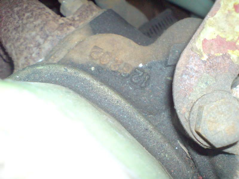

Hi guys ive taken the pic this is the only stamp i could find on the front right other than on the gearbox....
Is this right??
If you cant read it that says 306 not 506
Also i found a stamp on the back of the engine
Let me know cause i dont want to bother working wtih this engine if its not the 1100.
Thanks ;)

Hi my friend told me that 306 is way to short to be a engine number so i went back downstairs and attacked my engine further with degreaser and a rag. I couldnt see any other numbers stamped into the engine other than on the bakc of the engine.
So where i found the 306 is shown in this image to give an idea of location its circled in red...
Then i found one other number stamped on the back this is shown in this next image. Which seems to me to say c2-h2
And the c2h2 stamp's location is shown in this next image circled in red and the 12a497 stamp that was found previously is shown with a blue circle.
Is this enough to distinguish what engine i have???

It's certainly an oldie judging by the oil filter. the engine number should be on a little aluminium strip below No 1 cylinder spark plug - the wrong end of your arrow in the first piccy.

Yer looks like a 1098 if you ask me, must of been transplanted on to wet suspension.
