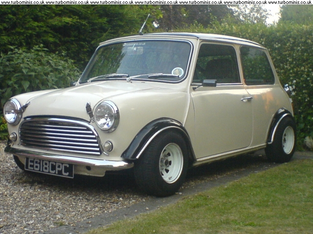

This was mine a year ago...can't get much more stealth than that...lol
Posted Image
