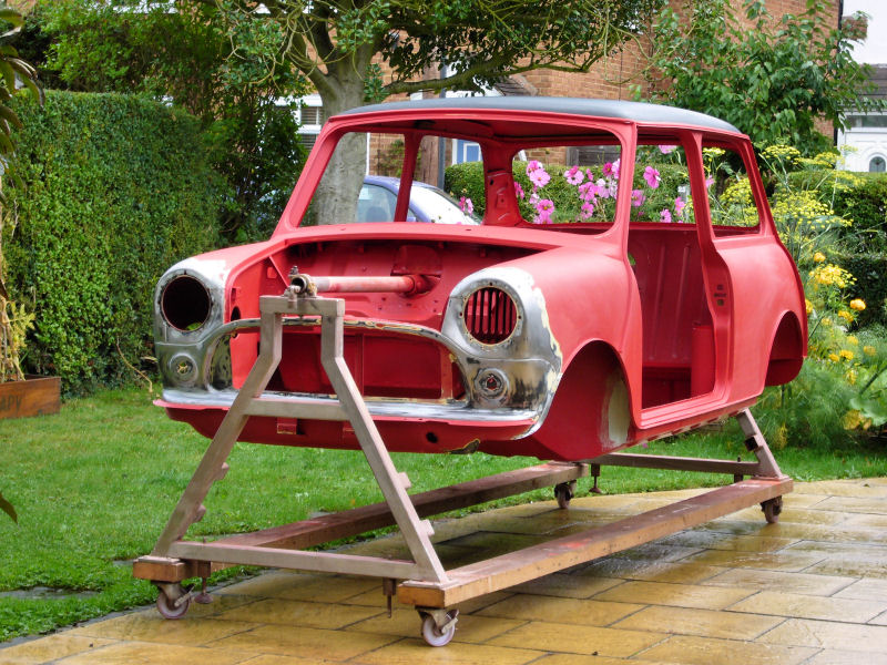

You can make our own for far less than a ready built example and if you are contemplating work or restoration requiring a roll over jig then you already have the skills required.
For my jig the A frames were being thrown out at work, 4 castors and two scaffold clamps from eBay and the planks and scaffold tube I already had.
By the way, I think castors are a must of any roll over jig.
Once finished with I sold it on to someone starting their own restoration.
