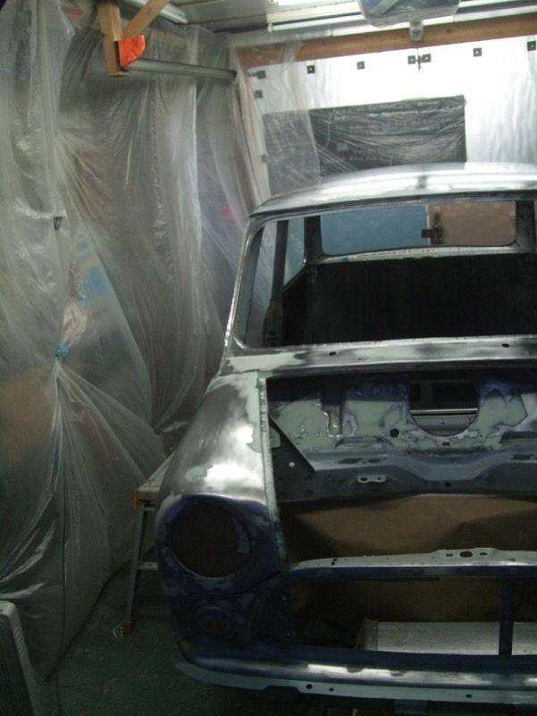

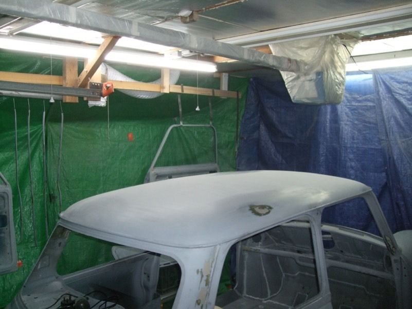

I did similar, but I built a wooden frame inside the garage as a booth, made a door from cardboard and one panel in each end contained a filter, the inlet filter in picture on right I placed a fan behind and made it positive pressure, the booth filter at other end vented outside when door was opened , I used a oil filled radiator to get a good temperature then took it out before painting, worked very well, the plastic dust sheet for lining is cheap and being static helps attract the dust and overspray,
