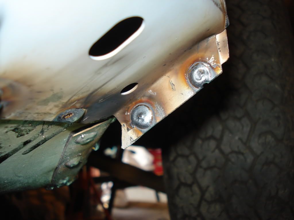

I'm having problems finding a stock photo of this area.    I replaced my outer sills with MiniSpares parts and it has a flange that points outwards.   Anyone have a good photo of how it's supposed to look and be finished off?
Thanks Sonik for the photo.
It's in the far right of this photo.
close up in the second pic.      How is it supposed to look when complete?

It’s as per my picture, clean up the plug welds or not if you use a spot welder. Trim back the pointed section where it overlaps and job done.
