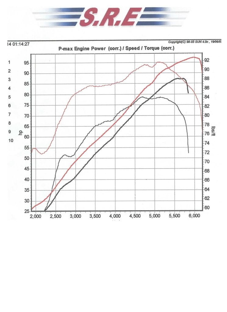

Unfortunately the scope to radically improve the A-series cam is seriously limited by the cam follower diameter, and many of the improvements in A-series cam profiles were developed over 30 years ago...
Which 30 year old cam does this with a smooth idle (red curves)?
90f915739d80eb591e2715beb4a2fa5405807e6d
what cam is it and what cc engine
#11 hhhh
hhhh
  • 422 posts
Posted 11 May 2018 - 06:47 PM
Not sure, but it's a big bore with AC Dodd's RS cam, 1.3 rockers. The other curve is a 544.
#12 racingbob
racingbob
  • 3,061 posts
  • Location: Hampshire
Posted 11 May 2018 - 08:03 PM
imagine bit more than 1275. also rs or rs plus
RS and it may be a 1330.
is it slarks when at amsebury or new dyno at Bristol
