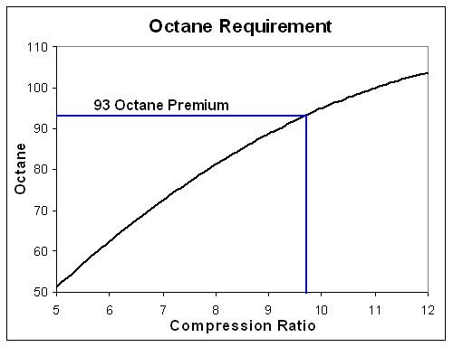

This is one reason why I'm unsure about which fuel to use,   because on the threads where I have found some advice,  I'm not sure whether they're referring to static ratio or dynamic ratio.
For example,  I found this graph on another thread (I've just realised it's from one of your posts so I guess you're familiar with it!   :D  ) but the recommended minimum octane for 9.5 is very different from that for 10.6
(Bit unsure whether it refers to UK-style octane ratings)

  9.5:1     I think this is the dynamic ratio which he's worked out from the compression test results.    It's written right underneath the compression test figures so this would make sense.
  10.6:1    He calls this "calculated compression ratio" so I think this is the static ratio calculated from the combustion chamber volume etc.
If this is right, then at 9.5:1 DCR it is Sky High, well past 'Hand-grenade' territory. I doubt you'd even on that on 100 RON.
8.8:1 DCR is as far as I'm 'happy' to go and that's with fresh 98 RON Fuels, but I feel much happier at 8.4:1 DCR.
I don't have a lot of time right now, but off hand, I feel given your Cam Profile, these are two figures (the SCR and DCR) are in error.
