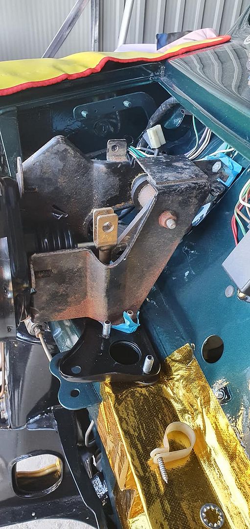

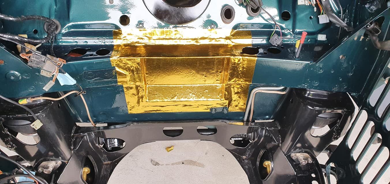

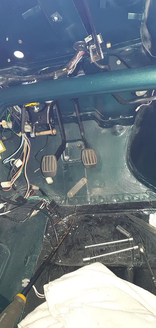

good evening Peeps today I fitted hrat reflective to Turbo box
ERA_rebuild_22.jpg?width=1920&height=108
and then fitted pedal box
ERA_rebuild_21.jpg?width=1920&height=108

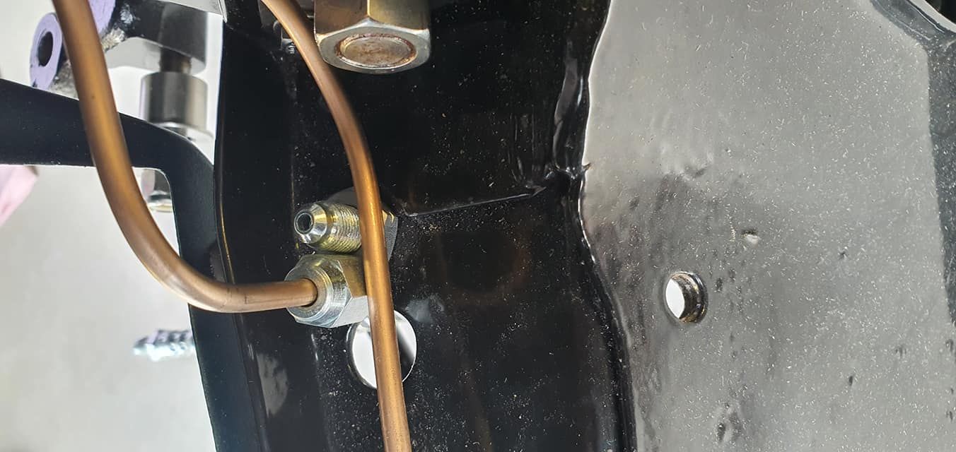

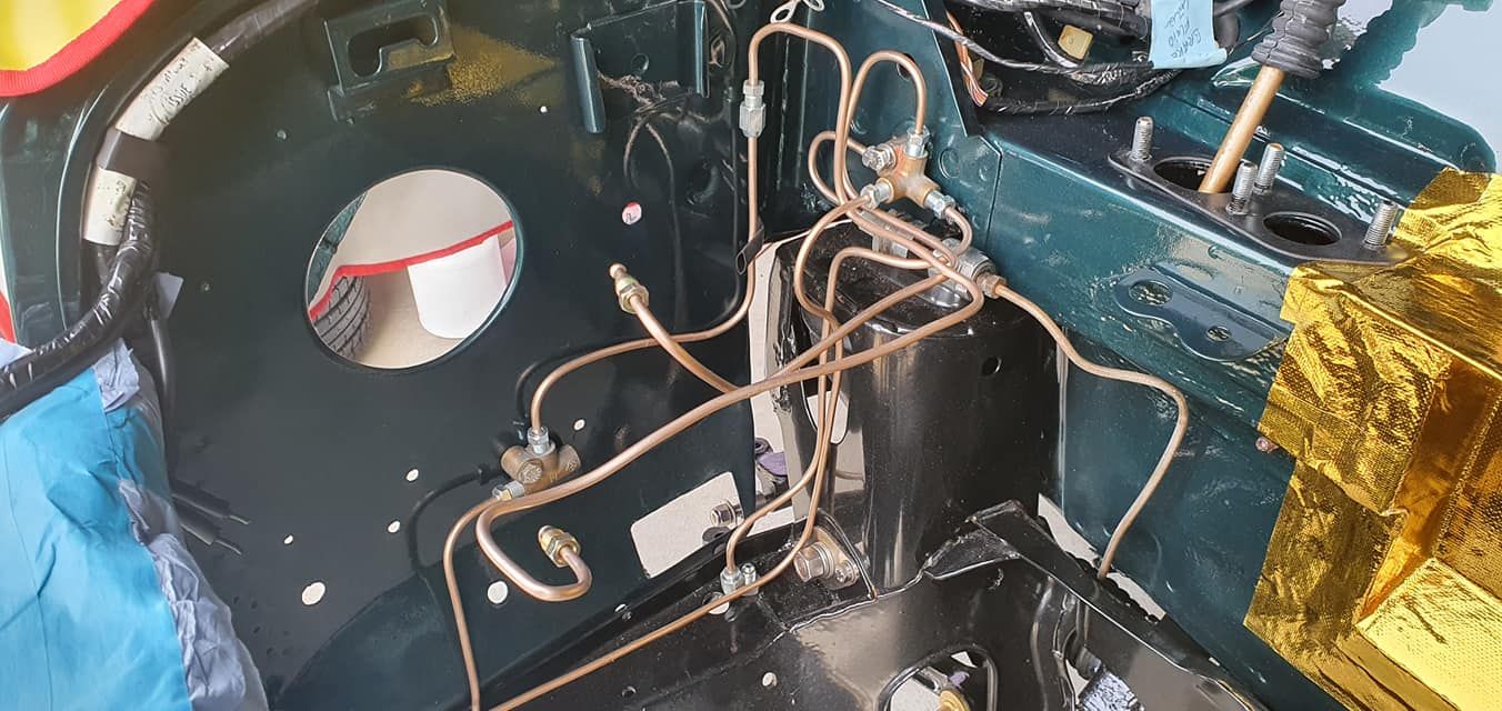

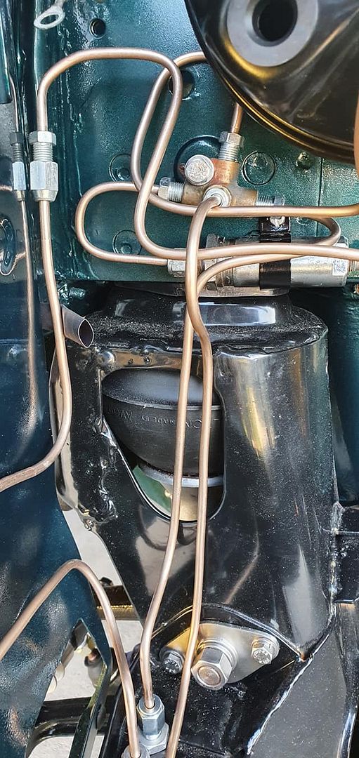

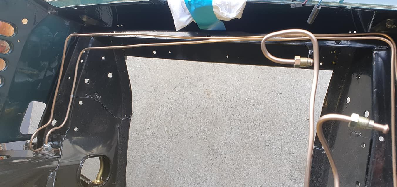

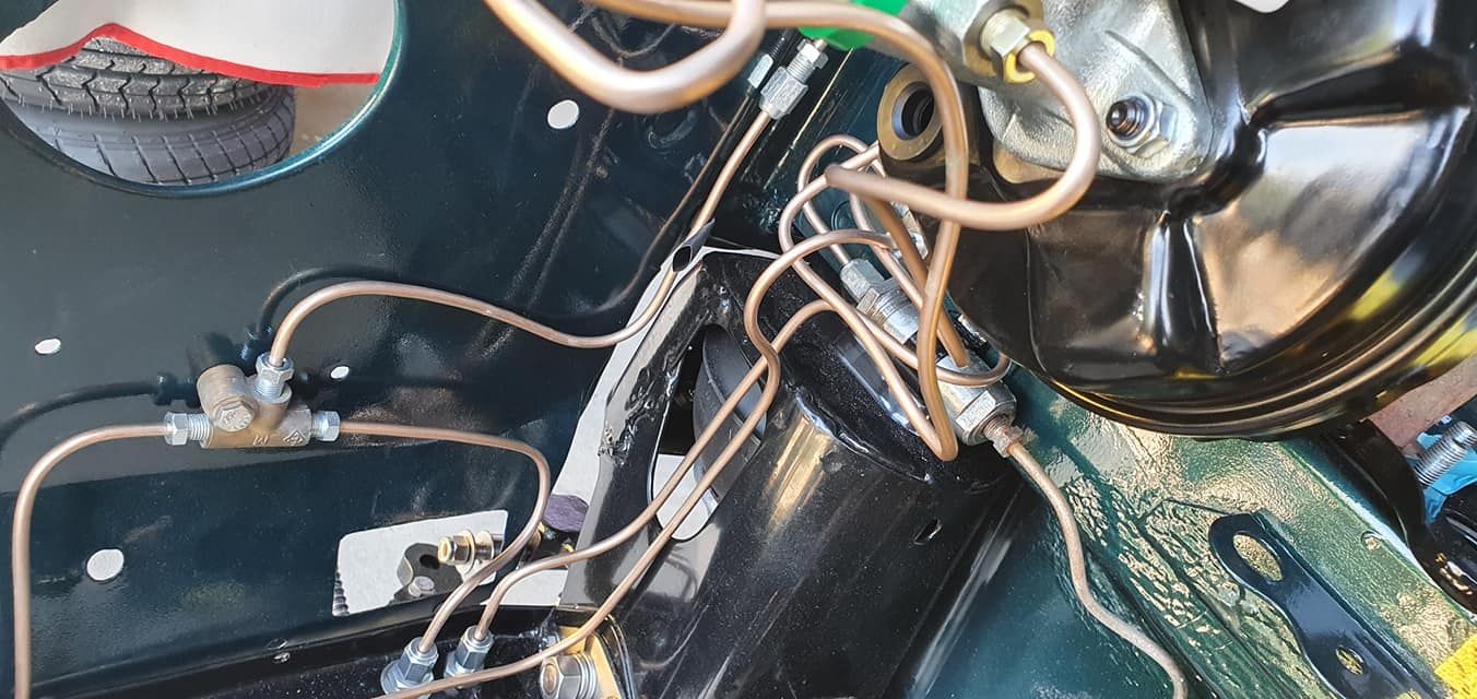

Good afternoon peeps a bit of a frustrating day sorting out the spaghetti brake pipe system as some parts are English thread and some metric so the 4 Disc caliper ends are wrong and need 10mm female ends and 2 servo require metric ends so another ebay order lol
ERA_rebuild_23.jpg?width=1920&height=108
ERA_rebuild_24.jpg?width=1920&height=108
ERA_rebuild_25.jpg?width=1920&height=108

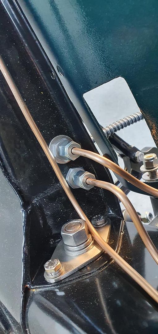

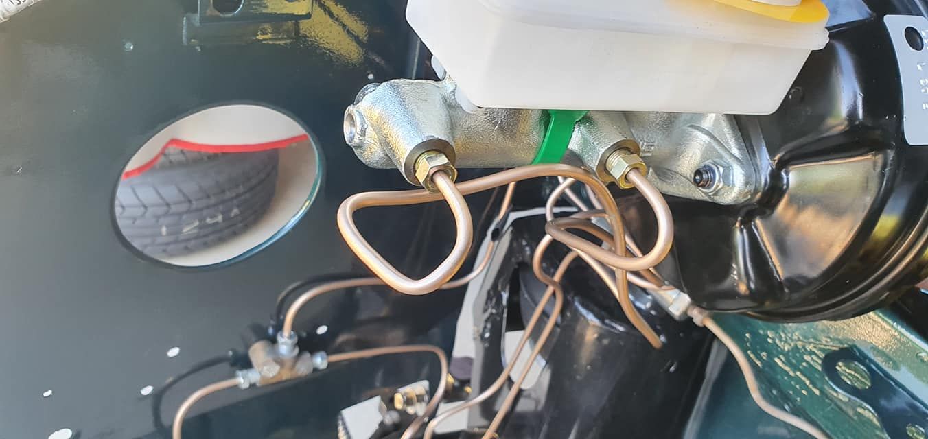

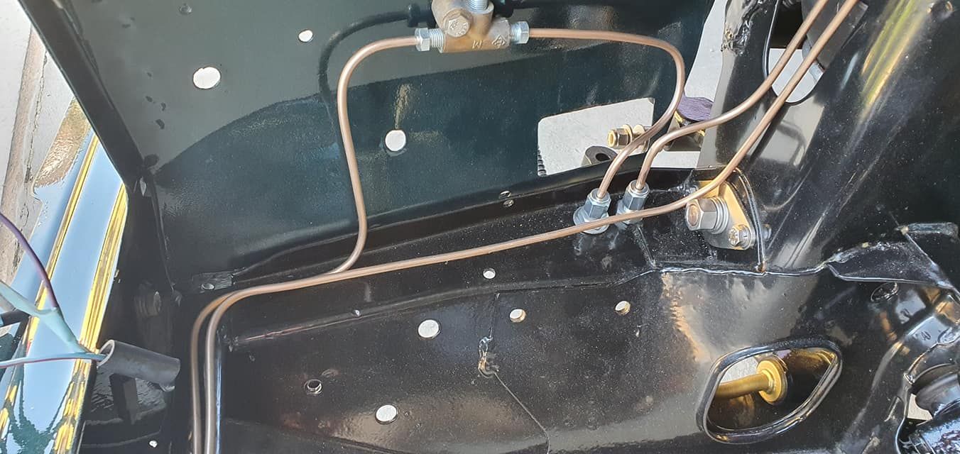

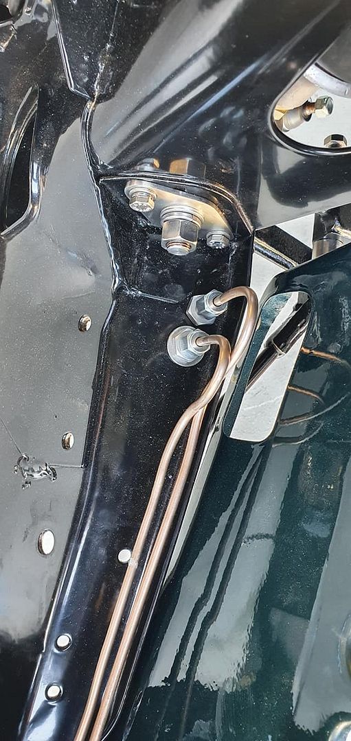

Good evening peeps so the spaghetti saga continues managed to get metric female connections locally and remade some pipes got it all temporarily fitted and I thought I had servo mounting bracket cleaned and painted but no so temporary fitted it and new servo and master cylinder all look good very pleased so far.
ERA_rebuild_28.jpg?width=1920&height=108
managed to fine some SS washers
ERA_rebuild_26.jpg?width=1920&height=108
ERA_rebuild_27.jpg?width=1920&height=108
ERA_rebuild_29.jpg?width=1920&height=108
ERA_rebuild_30.jpg?width=1920&height=108
ERA_rebuild_31.jpg?width=1920&height=108
ERA_rebuild_32.jpg?width=1920&height=108
This is a temport fitment as I need to sort out Discs, Hubs, CVs, deiveshafts and callipers

Posted 16 April 2022 - 07:37 PM
Involved pipework.I am not criticising but I am not keen on the male to female connection near the servo.There are double female connectors to do this.Steve,
PS you are going to paint the brake pedal servo bracket aren't you?Looking good.

Posted 17 April 2022 - 10:22 PM
That's some pipework! I'd make sure that the pipes clear everything. In the 4th from last pic the pipe looks a bit too close to the upper arm nut. I know it's only a temporary fitment but brakes have to be right.
Looking good, it's not easy custom fabrication
Pete

Posted 17 April 2022 - 10:43 PM
this is all tempory fitted as need to get hubs Discs and calipart fitted then I will fix properly

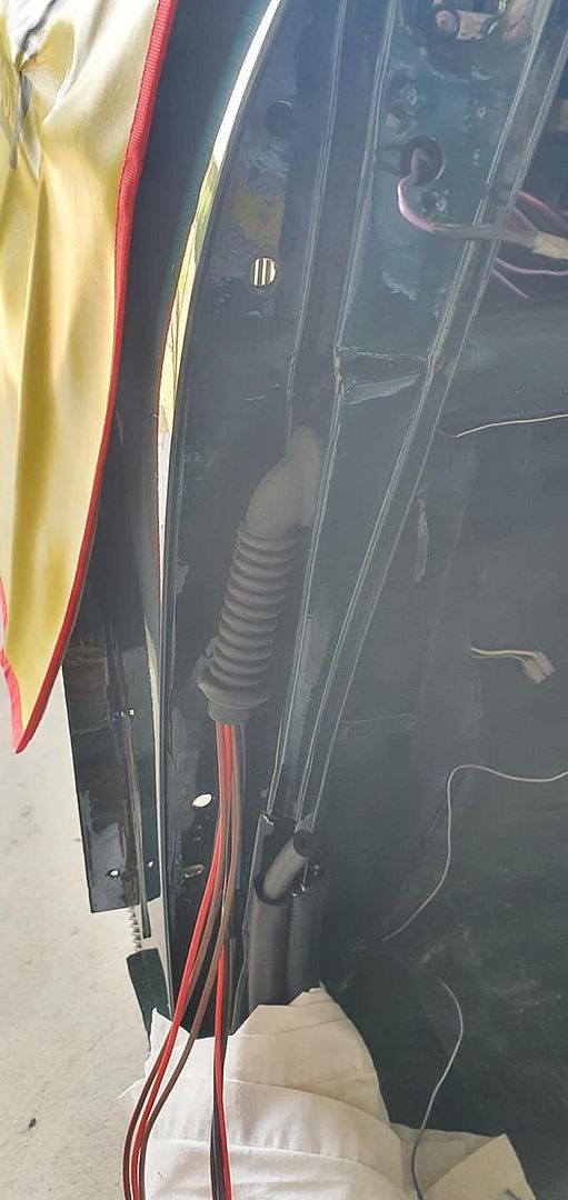

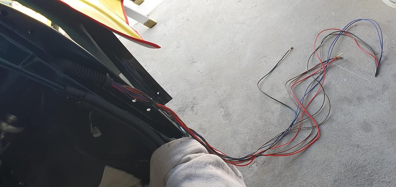

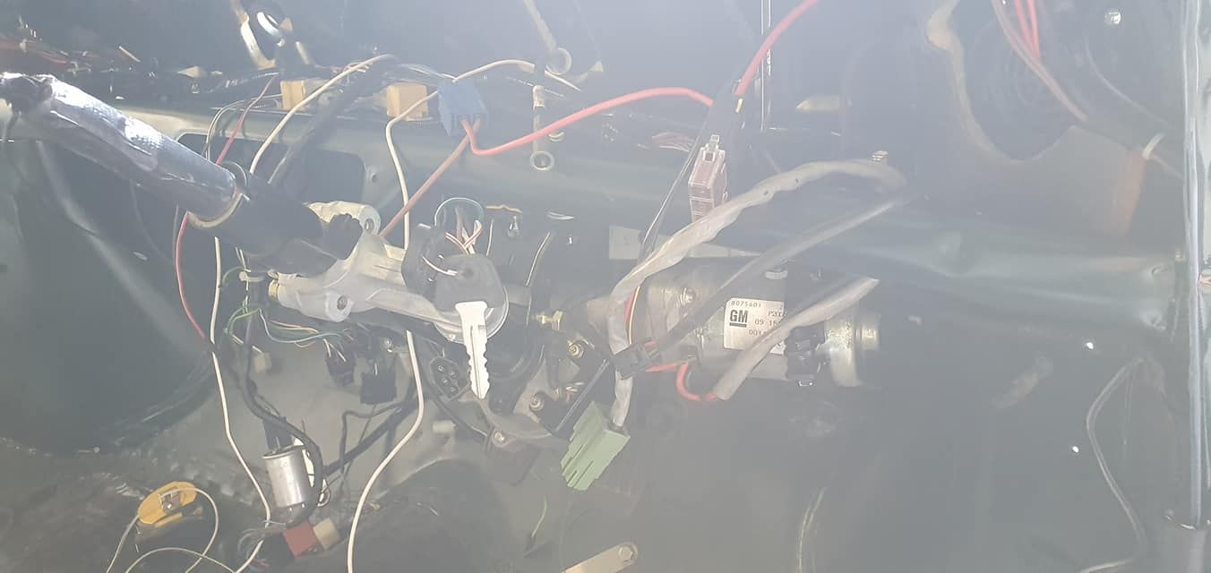

Good evening Peeps a little more done over the Bank holiday 1st sort out some wiring for Power steering, electric windows and central locking wires through door hinge panels.
ERA_rebuild_38.jpg?width=1920&height=108
ERA_rebuild_37.jpg?width=1920&height=108
ERA_rebuild_40.jpg?width=1920&height=108

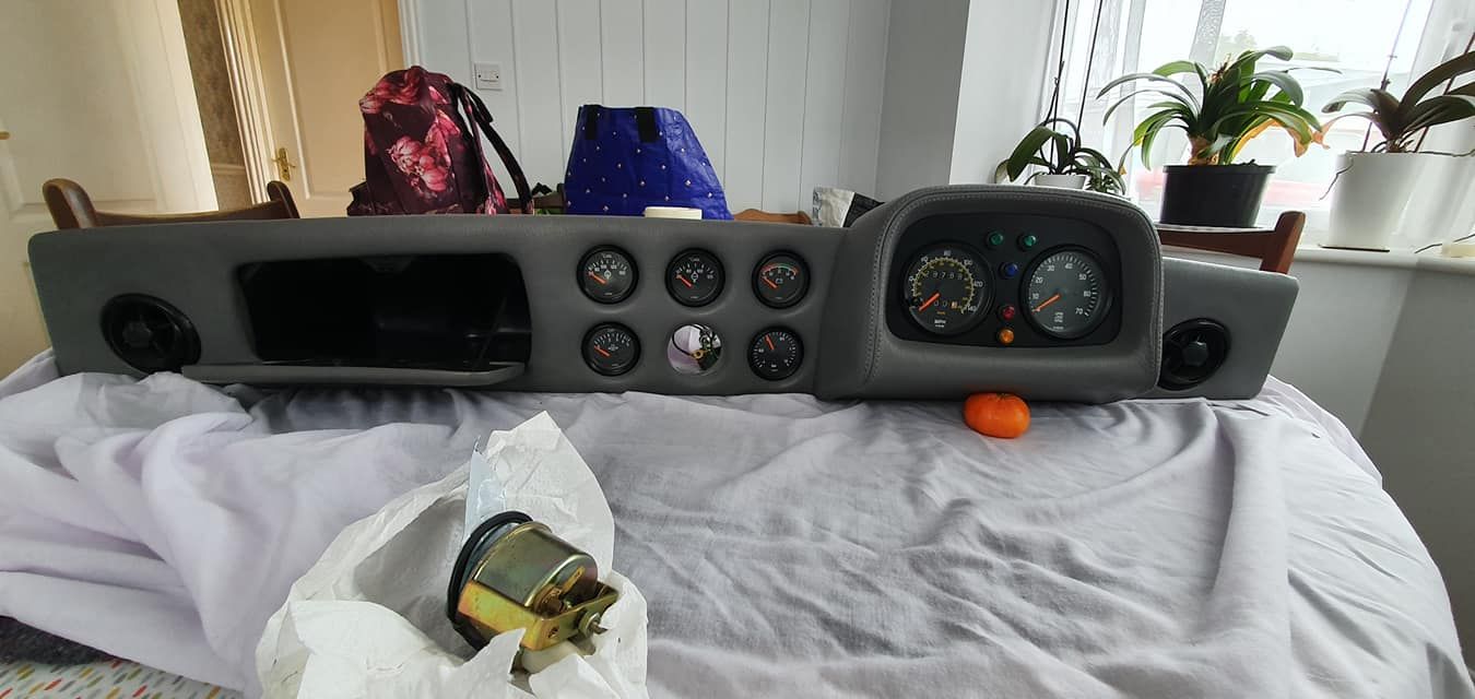

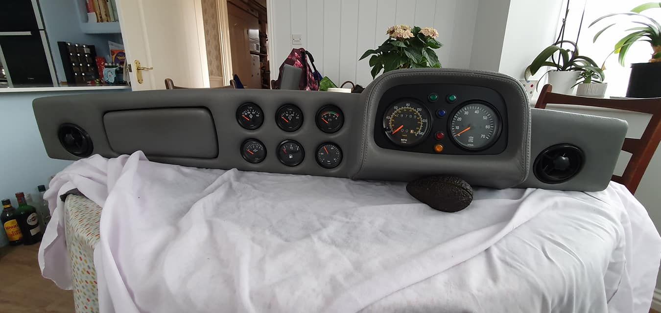

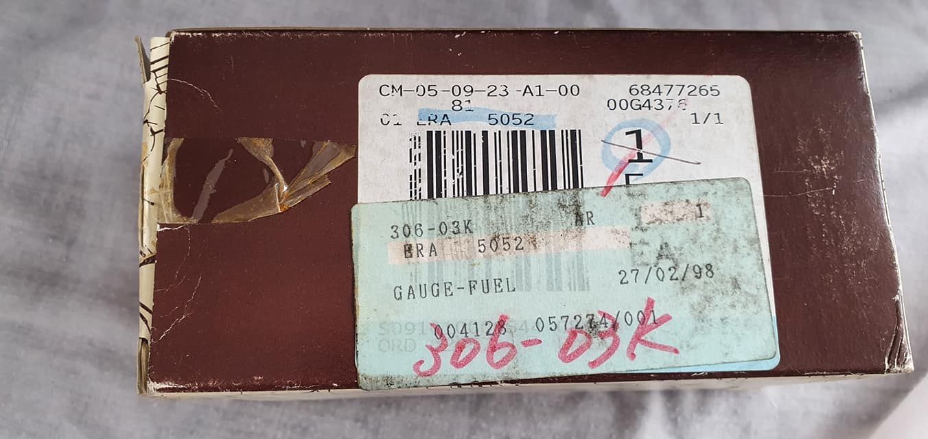

Got the dashboard out of Hibernation lol and replaced the fuel gauge with an NOS item from Japan
ERA_rebuild_41.jpg?width=1920&height=108
ERA_rebuild_42.jpg?width=1920&height=108
ERA_rebuild_43.jpg?width=1920&height=108

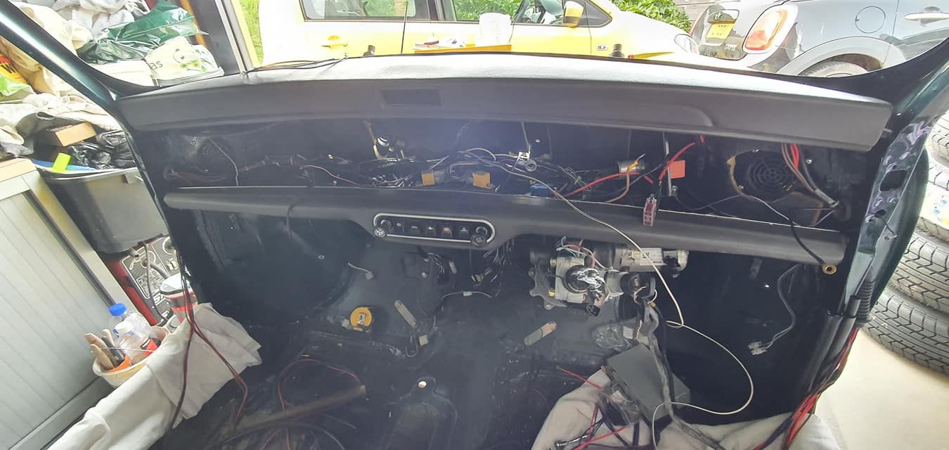

and struggled fitting the bottom rail and then the switch panel several attempts of on and off adjusting the small brackets to align with the holes for the nuts lol
ERA_rebuild_44.jpg?width=1920&height=108
getting there slowly

Posted 03 May 2022 - 10:06 PM
Magnificent dash,looking good.Steve..
#178 johnR
johnR
  • 2,297 posts
  • Location: Dorset
Posted 04 May 2022 - 06:49 PM
What is the fruitbowl for if it's not providing supports for a Mini dash?
