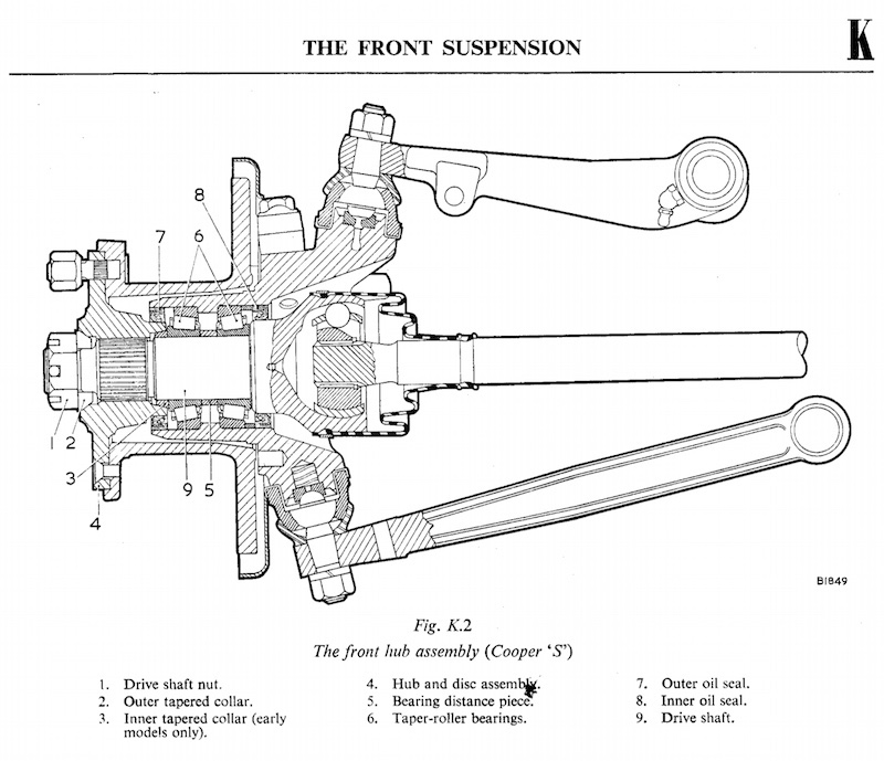

Essentially you need the hub assembly complete with cv joint/bearings/drive flange in order to have a safe rolling assembly. This picture from the BMC Workshop Manual should help explain why:
I say safe as my friend had a 'rolling shell' delivered which had no CV's fitted and instead had the drive flange slotted in to the hub and the only thing stopping the flange from backing out and the wheel falling off was the brake disc interfering with the caliper. When I realised, I had a horrifying moment imagining what happens when a Mini's front panel is suddenly seeking the concrete and all that stands in its path are your toes.

This picture from the BMC Workshop Manual should help explain why:mini-front-susp.jpg
Thanks Deathrow!!
