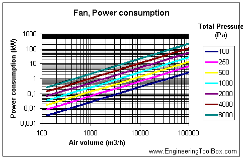

I found this graph which maybe of interest
VentilationFanPowerConsumption_zpsn0stox
