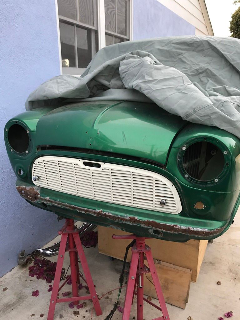

So over the weekend, I scored a MK1 stamped grille in old english white. The question I have is if it is would be blasphemy to paint it matte black since the car itself will be painted old english white? My goal is to make the car white and black themed and have the body be white and the trim be matte black. But is this something that will have the purists up in arms or is it socially acceptable? I know its my car to do as I wish, but I also want to keep the car in a state of OEM+. It looks original.... except it doesn't. Does that make sense?

Mate i am glad that yours is in better condition than my mk1... The radiator and the 7.5 brakes are the most expensive i have paid so far!!! the spare wheel (the white ) is a cromondora i got a set of there :D Keep it up

Posted 01 December 2016 - 07:33 PM
Thanks! At the moment it doesn't look like much but it should turn out pretty well after the respray. It is a dream come true. I just can't wait to drive it again.

You do what ever you want to your car, every Mini is different and vive la difference, who wants to be driving something the same as someone else. I think it would look great matte black. If you don't like it change it back or paint it another colour - it all helps keep the rust at bay :D Just don't put sportspack arches on it :shy:
There will always be those who hold there hand up in horror at a car that doesn't comply with factory spec, but do you really care - I dont think so ;D

Looks good in white. Should look just as good in black too :)

Thanks guys. It's going to be powder coated semi gloss black like most of the parts I restored. It's a great finish. Mostly, it's just nice to see it finally taking shape. With the white grille on, my wife has taken to calling it my frog. Hahaha I'm just hoping I don't screw up the body too much welding up holes/replacing rusted out sections.
