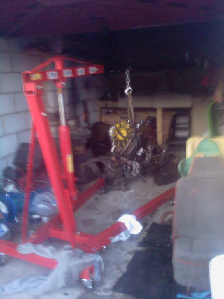

Well what a day, really please with the progress i made, i feel i have learn so much about minis over the time i have owned them :P
Well this was the start of my new secret project ill make a new project thread about midway through next month. Well i needed to raise runds for my next project, so the 1380 had to go, and eventually ill be fitting a K-series in a custom frame.
The reason the project is so called secret is because i will not be telling my rents that ill be buying it, and the plan is to get it finished then just turn up home with a new mini lol.
So today i had to remove the engine and replace with another engine then drive it home without the rents knowing lol.
So i set off down to my garage this morning telling them im going to my friends house, i got everything dissconected and had the engine lifted out withing 2 hours :shifty: but as i was lifting it out although i had split the pot joints the drivers side one had slipped back on about 5mm, so i then lifted the engine out and the pot joint stayed connected and ripped its way through the inner CV gaiter :P but that was the only problem i came accross when removing it, so i feel it was prety good going really as this was done on my own and only me second proper engine conversion.
Dom then turned up to give me and hand. So we headed over to the mini place and got a new gaiter, got back and i got that fitted. when then got the engine fitted and bolted in place, this would have been prety tricky withough dom's help, cheers mate, so everything was then bolted on fluides were replaced and i gave it a service. I forgot to connect up the linkage thought, so i went to do this, but i couldnt get the bolt through the top linkage arm thingy as the manifold was in the way, so i had to dissconect all them again and i got the linkage fitted. We then put everything back in place and turned the key, and it fied up straight away >_< Did have a fiar amount of white smoke though, but that cleared up after a couple of minutes >_< i think its just from where its been sitting outside for a while so it was burning of the condensed water... Getting it fitted took us 3 hours, so not bad really concidering we had a few problems, i think we could do this closer to 2 hours if no problems occured :P
So overall im prety pleased, the only problem i have is whenever i go in to 3rd gear either going up or down, i get a small crunch, but to be honest im not bothered about that as the engine is only going to be temperary. And the best thing of all the rents didnt have a clue when i turned up home :P it is a bit gutting loesing all the power though ;)
Heres a quick snap i got of its new heart. :)

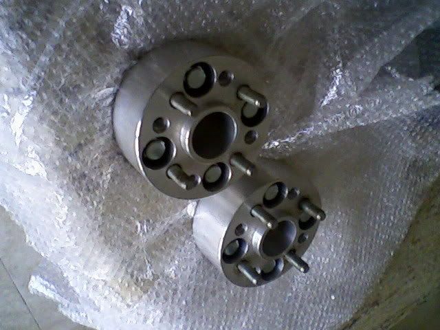

Well as i had the cash i brought some watson rear spacers, that also convert the PDC to the metro stud patten.

Posted 12 November 2008 - 05:03 PM
They turne up today >_< cant wait to start on this conversion, and yet i know its still going to be ages till i get my teeth into in again >_<
