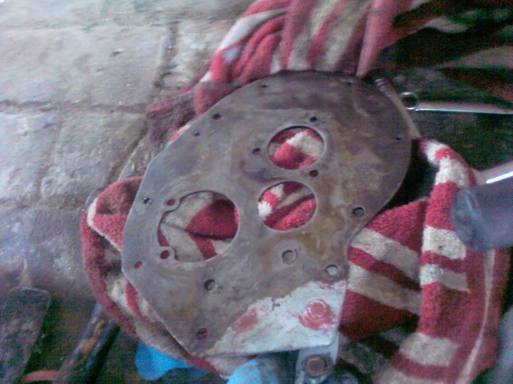

Also after changing the seal that was leaking, i had a look under the engine today and found there was still oil leaking off the bottom of the engine in exactly the same place so this annoyed me a bit, but i fied the engine up and there was defonately no oil coming though the seal, so i had a good look over the whole engine and saw the oil was coming out between the timing cover backplate and the block... well when re-building the engine i didnt take the back plate off, so this confused me a bit, so ill make a post up on here and ask what people think could be the problem as i cant see how oild would be coimg out here, although it is the other side of where the cam meets the timing chain... so i might not have torqued the three nuts up the go on the triangle bit.... i dont know im sure ill have it all aprt agin tomorrow, just a shame i didnt realise there was oil also coming out of here when i changed the seal as ill be doing the same process when i sort out this leak :genius:...
hopefully this will just be something simple like the bolts not being fully torqued up or have come a bit loose...
Also when looking here i realised the pot joint isnt located properly in the diff, so ill have to find out whats going on there aswell, what do these little problems have to crop up now :)

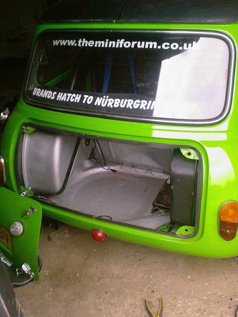

Oooo i almost forgot, i went and picked up a fuel tank today, that ill be chopping, welding and hammering to try and make fit in the drives side.
I also recived the fuel hoses, T-piece and clips to fit the tank today and i got the finishing trim to finish off the rear seat :genius:

Then i took the timing gear set off, then i undid the three bolts round the cam and the two hex screws either side of the crank, then i took the back plate off to find a bit of a surprise, there was no gasket even fitted, there was a bit of the silicon gasket stuff there, but that looked a state, so no wonder it was leaking through there.
So i cleaned up the face of the block:
I then cleaned up both faces on the backplate:
wacked some blue gasket stuff on the gasket and put it in glace, then put the blue gasket stuff on the other side:
I then fitted the backplate back and torgued the bolts up, cleaned up the exess blue gasket stuff, i then went to fit the duplex timing set, and relised that two of the teeth on the small sear were shagged >_< i dont know when this happened, as i didnt really look them over when i fitted them as they were on the engine when i got it:

Well i had a quick play with my extra tank today to see how hard it would be to make fit the drivers side and to be honest it is a hell of a lot easier that i thought it would be...
I had to do a very little bit of hammering to the part that sits above the wheel arch. but thats all i needed to do to get it to fit like this, ill have a bit more fine adjustment to see if i can get it to sit any closer to give a bit more clearance on the battery, then ill just cut a hole and weld a new neck in, and cut the old neck off and put a patch over that.
