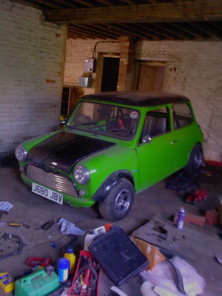

Tom, how comes Dom can take decent pics and you cant? :) Bonnet is looking really good. Also How comes your boot looks so ill fitting?

The bonnet pin isnt in is it? I think so:)

Tom, how comes Dom can take decent pics and you cant? :D Bonnet is looking really good. Also How comes your boot looks so ill fitting?
Look because im always to buisy working so i rush the pics, where as dom does photography so when hes not working he takes time taking pics and he knows how to get a good pic lol.
Yea your right the boot pin isnt fitted thats why the boot doesnt look right...

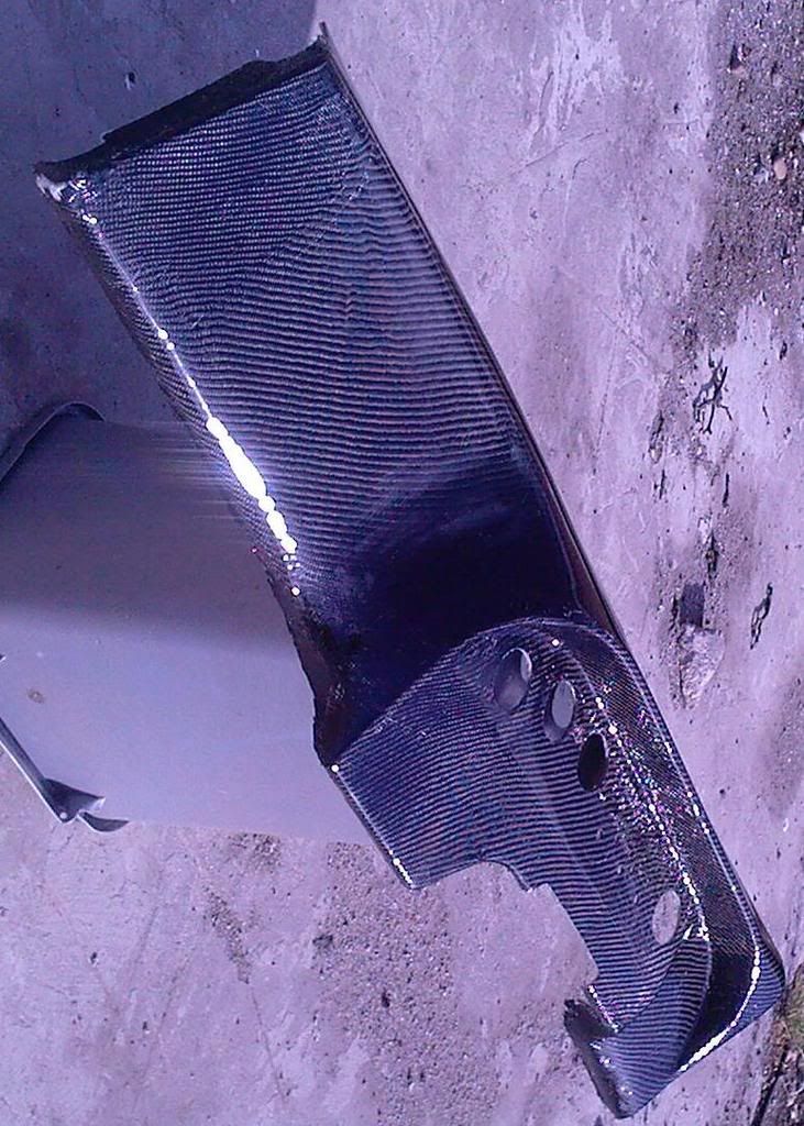

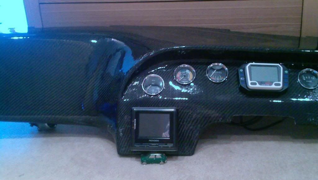

Not got anything really done today, but i did fit the gauges to the dash, iv still got loads of flatting back of the carbon fiber to do, but it should look nice when its finished :)

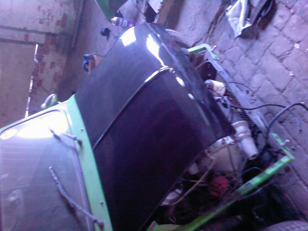

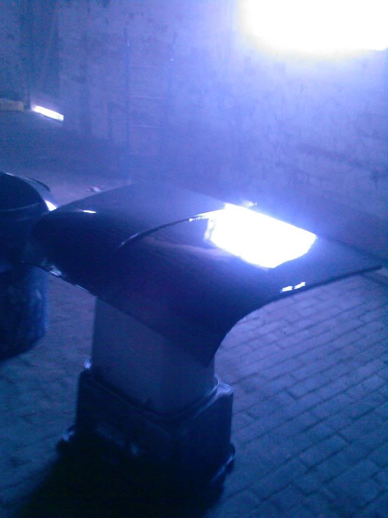

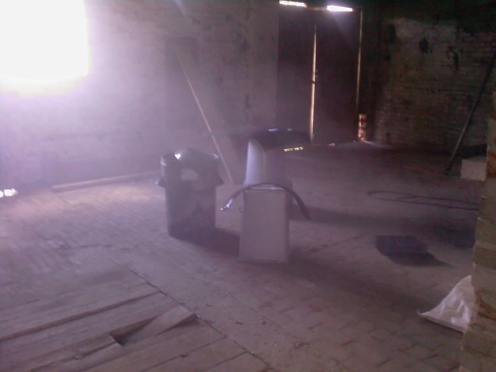

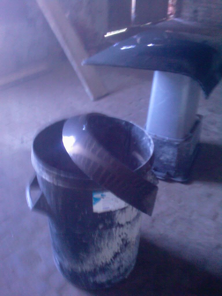

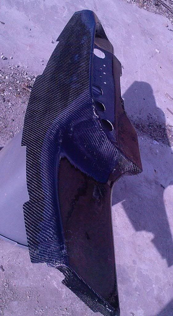

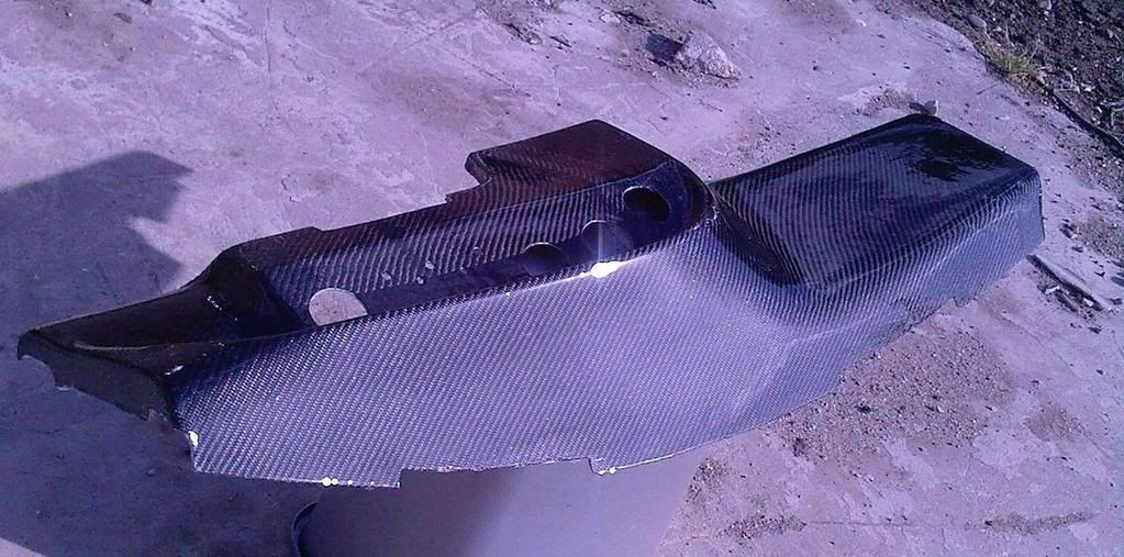

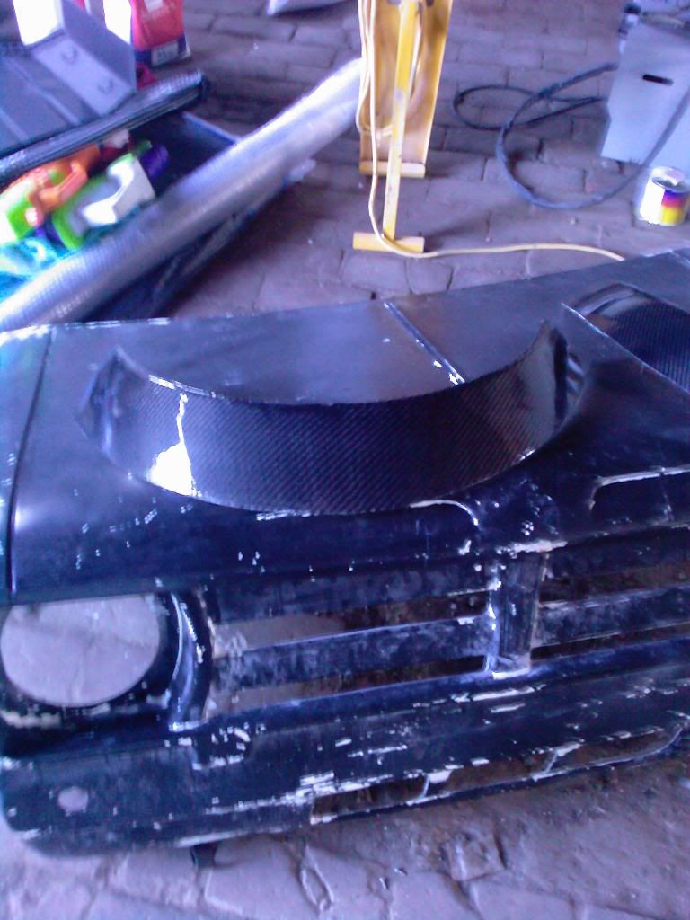

Well i went out on the *yellow human water* again last night, so i wasnt really up to doing much, but i had a shower and ate some lunch and this gave me a bit of life, so i though i go up to the mini and see what happens, so i started sanding again and got the bonnet fully flatted back and gave the arches a final flat back with 1500 wet and dry. So as they were flatted back i though well i might aswell give them a lacqure now :P
Well concidering i have never sprayed 2k lacqure i am amazed with the finish i have got, theres no orragne peel, no runs, they have come out alot better that i thought i would be able to spray, so here are some pics of them after teh lacqure had hardened :P Sorry for all the pics i get a bit exited haha.

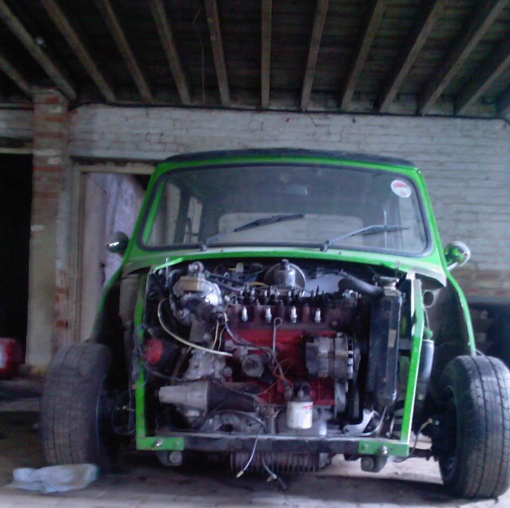

Then i plumbed in the water system to the engine and joined up the wiring apart from the starter motor, because i have to wire in a solinoid for that as i am using a different flywheel fing gear, so i have to use an inert starter.
Once i have the solinoid wire up all i have to do is set up the timing, then ill fire the engine up :cry:

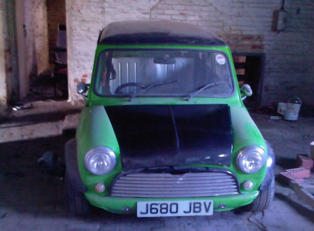

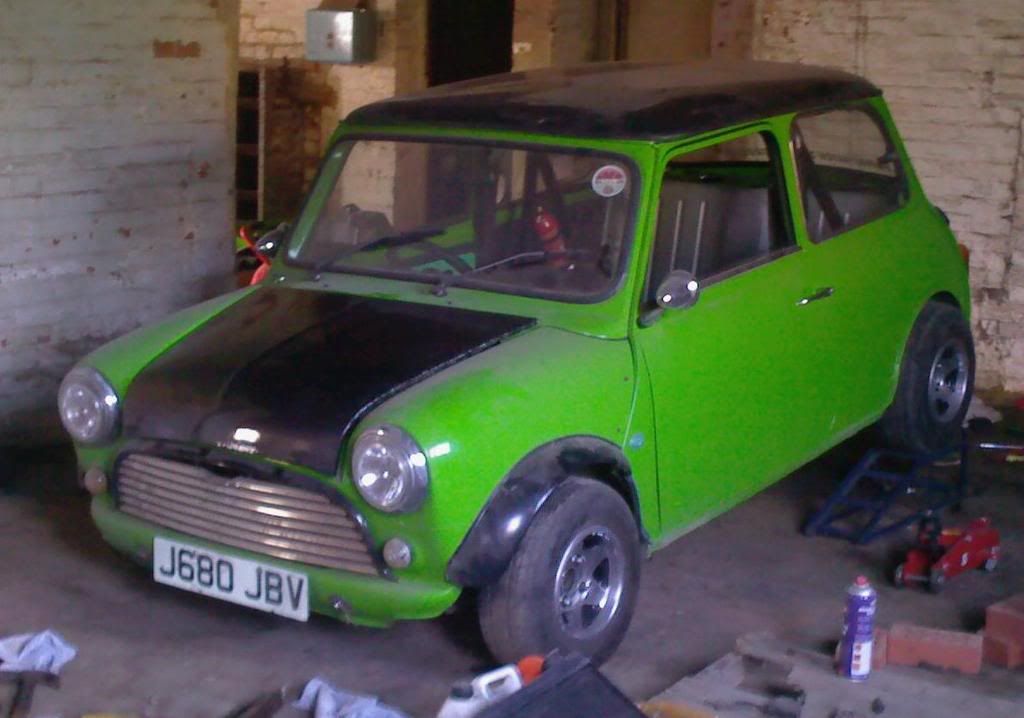

I then put the front back on just for a pic and rested the bonnet on, its sitting on the bonnet pins, so thats why it isnt sitting right.

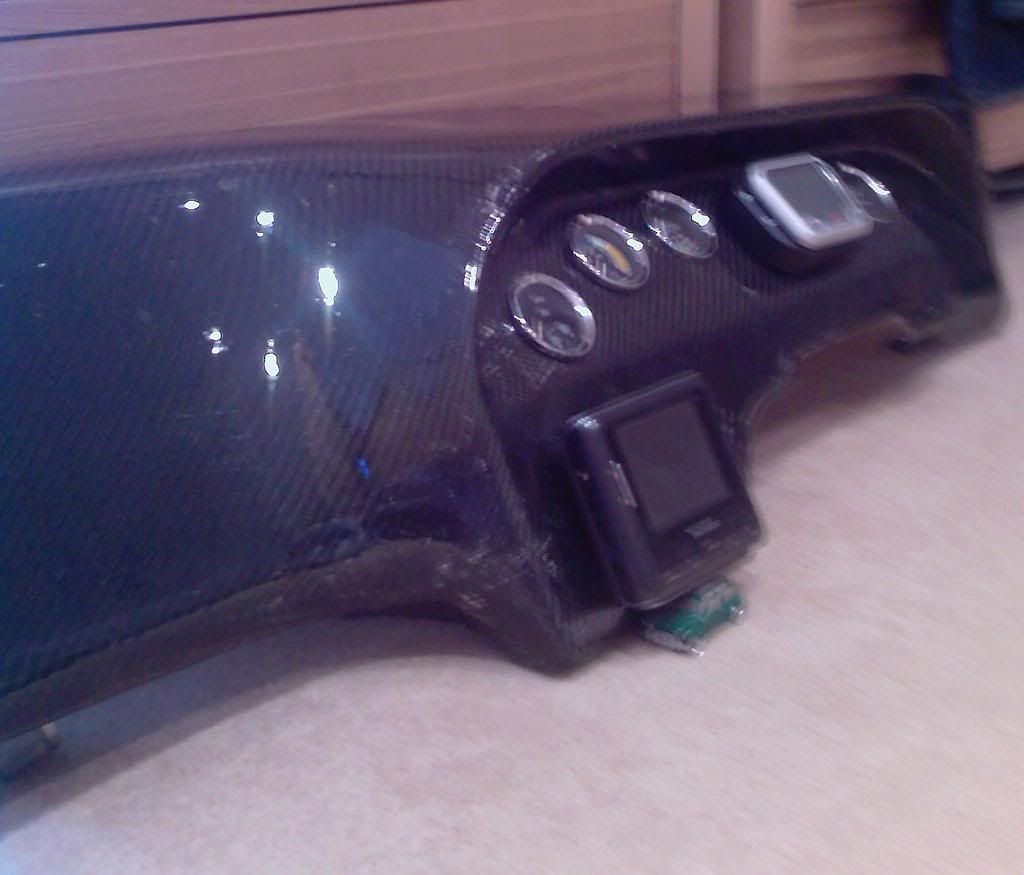

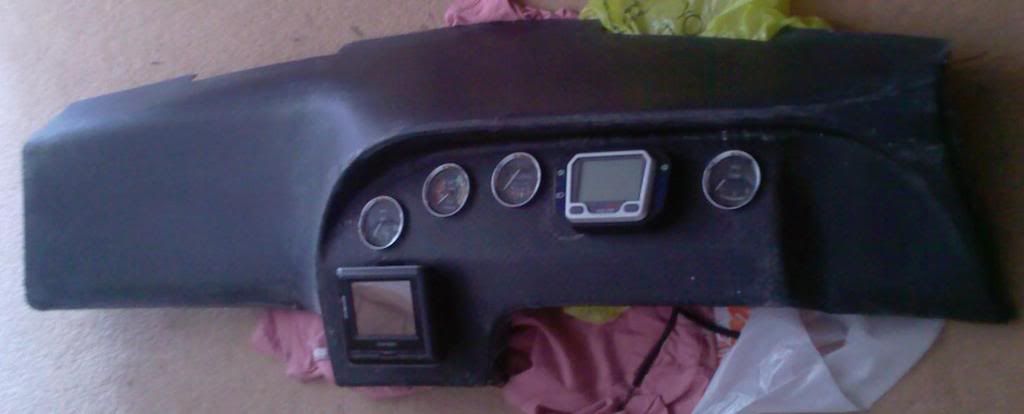

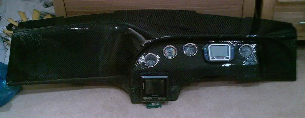

I also finished flatting back the dash and got that lacqured up and my god its looking sexy ;D
I then test fitte the gauges to see what it will look like.
i then started to sort out all the wiring for the gauges, and i was so shocked at hod bodged the wiring was behind there :P so i chopped out all the wires that had been added and started again, so now i have started adding the new wires for my new gauges. ill finish doing that and add a blade fuse box when i get the chance.

All I can say is WOW! That has to be the nicest dash I've ever seen in a Mini. Is that a Sat Nav in the center, if so, is that going to be used as your speedo?
#644 Tomf
Tomf
    Baby Tom
  • 6,440 posts
Posted 01 July 2008 - 07:53 AM
Yea it is sat nav in the middle :shifty:, well i will be using it as a speedo, but the other box type gauge is actually a digital speedo, so that will be my main speedo function :D
Thank you for the very kin workds helps give me the motivation to get the mini done faster :P

I have one of those little green Mini clocks :shifty:.
That dash is looking lovely, I'm amazed it came out so glossy after some of the previous pictures.
