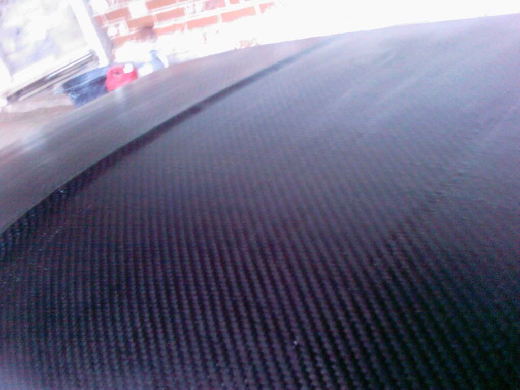

Tom, did you use the resin that you used to fibreglass with? If so does it not leave a slight greeny/bluey tint?

so have you just put the c/f over another bonnet or have you made a mould and shaped the c/f in the mould???
either way it looks the dogs

Its the same resin this i used to fiberglass and its clear... i havent ever used a green resin.
I just put the CF over the bonnet, its not the best way to do it, but i couldnt be bothered to make a mould then do it that way, although that is a far better way to do it...
well there is no way im complaining because its your car and it looks bucking frilliant

Also the second coat of resin has hardened on the bonnet now an the finish has gone really smooth, and hardly any flattingback is going to be needed :thumbsup: Ill give it one more coat just to build it up and hope it self levels a little bit more then ill flat back and lacqure :)

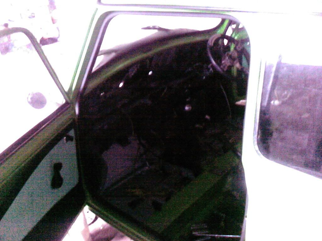

Also i removed the dash and labled up all the wires ready for the new dash and gauges, ill measure up the carbon fiber and see if i have enough to do the dash, and if i do ill get started on covering that with CF tomorrow and ill give the bonnet the final coat of resin. I think the bonnet did turn out ok, but there is one area round the passanger side edge where an air bubble has formed -_- but its good enough for me. :w00t:

BIG TIP, use spray glue to put the carbon fiber in place before applying the resin as this means you can make sure that its all inplace and you can eliminate any bubble, this would have been ideal for the bonnet, but atleast i know now.

i then mixedup the resin and hardener and applied it to everything and gave the bonnet the final coat, so ill cut that back once the hardener goes off.

did you just glue cf matting down then resin over it?
