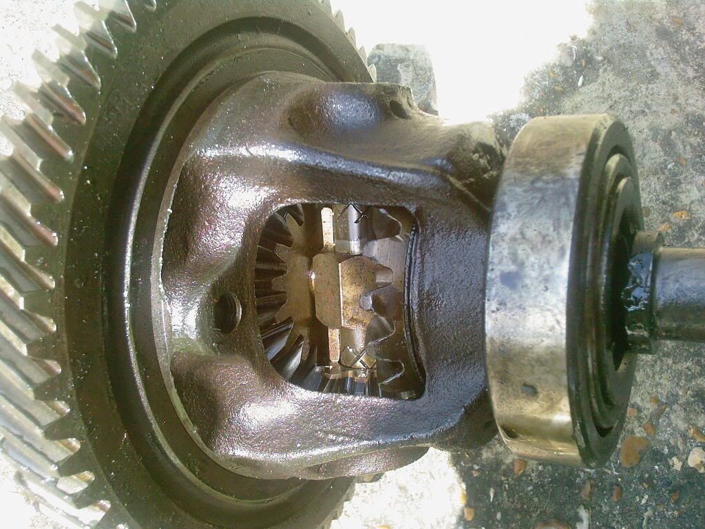

But whilst i was down there i stripped the diffs off 3 of my gearbox and one of them looks a bit different, i made a thread asking if anyone knows what it is, but this is what it looks like, as you can see it has xxxxx around the midle shaft.
Also whilst i was down there i fitted my oil pump, fitted the cam retaining cap, fitted the duplex timing chain an got the timing of the cam sorted.
Hopefull i will find out if the diff is worth using of just to use the other standar diffs i have, as if i use this type i will have to strip it back and change the output shafts as these arent pot joint type they are different. Then depending on what diff i use i will hopefully get that back in the gearbox tomorrow and get the gearbox fitted back on the block.
