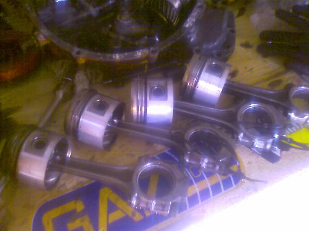

The pistons have AE 20659 stamped in the. I take it these are standard pistons, coud anyone confirm this.

Iv just typed the piston number in o google and its saying that the pistons are 73.5 POWERMAX 1380 pistons, could anyonce confirm that this is right?

well i popped down the garage tonight to measure the pistons and bores and they are 73.5 ish give or take .1 so im really happy now as it saves me buying new pistons and paying for a re-bore :shy:

Pistons
