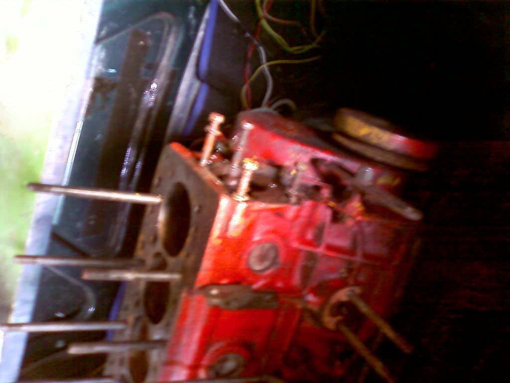

I just thought i would uploads some pics that i took of what iv bin doing.
Engine before i started stripping it:
Then then went and brought a flywheel puller and valve compressor:
After looking at i i though hang on whats going on with the oil filer... anyone know what this is off and whay it would be on this engine?
Few bits removed:
Is this timing cover normal? i cant seem to find another one without a breather fitted...
Heres a pic of the Kevlar bucket:
Mk2 fiesta calipers and carriers:
Custom hoses for the fiesta calipers, made by mini13. Cheers they look amazing :D
finally i dont know if you can see from the pics but is this head leaded or unleaded? i might need to clean it up more... How can i tell if its leaded or unleaded?

I don't think theres anyway of telling if he heads leaded or unleaded!
That thing on the oil filter housing - it looks like somebodys used the cars standard weather sheild bracket as a washer!

lol i duno to be hones, no the reason i sail about the oil filer housing is it is different to all the others i have seen, iv just got back form the garage, i still cant the flywheel off, but i managed to get the crank pully bolt out and it has got duplex timing chain. :D lets hope i find some more goodies when i strip it down further.

bro, get the pic clear
easy to look ;)

Oil filter looks like the very early canister tpe with replaceable element. Obviously this engines been butchered before as these would never have benn fitted to an A+ block as standard!
Timing cover is probably a small bore type (which had the breather on the tappet chest).

I agree with GraemeC on those points, plus - how to identify unleaded heads.

I thing the timing cover might be one made specially for the duplex timing kit.... as its got nothin on the inside that has been ground out... but this might be how the 998 engine is.
Thanks for the advice on the oil filter bit.
I think that the bits have been mixed and matched for a 1275 gt lump as this is what the engine came out of.
