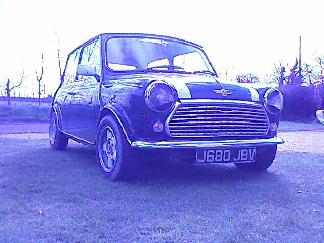

Fitted my evil eyes today, and i hope i dont have to do it again for a long time. They were so hard to get under the chrome rings but with the help from my friend we got them in, in the end.
I think they look great :thumbsup:
