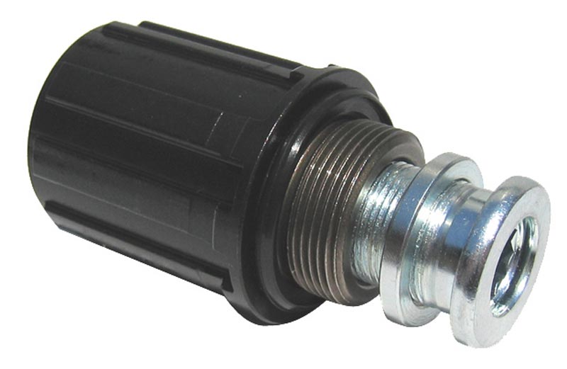

#12 mini13
mini13
  • 3,810 posts
Posted 26 July 2015 - 08:12 PM
fre hubs are normaly 10mm hex, and look like this off...
http://www.ebay.co.u...=item53f63db046
#13 nicklouse
nicklouse
  • 18,577 posts
  • Location: Not Yorkshire
Posted 26 July 2015 - 08:16 PM
Done a bit more digging and I would say up u need a 12mm Allen key in through the non drive side to remove the bolt.
http://www.edinburgh...ed-freehub-body
Edited by nicklouse, 26 July 2015 - 08:17 PM.
#14 rally515
rally515
  • 3,848 posts
  • Location: ask!
Posted 26 July 2015 - 08:17 PM
It looks very much like that mini13 yes, but I tried a 10mm allen key and it way way undersized, only hex that I could find the right size was a chisel shaft!
#15 nicklouse
nicklouse
  • 18,577 posts
Posted 26 July 2015 - 08:20 PM
And that is a shimano made shimano patten freehub. No one else uses the same fitting.
