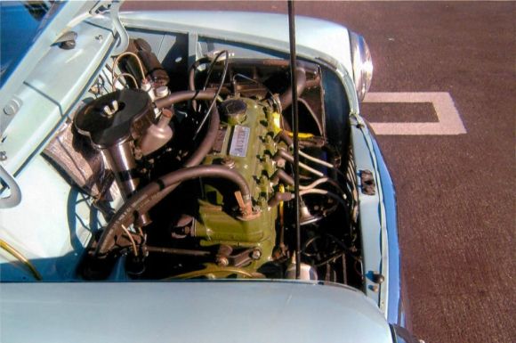

OK, here is some more info:
The nipple on the breather is 1/2" as this is the hose size I just used to renew the hose. The nipple on the carb is about 3/8" so the hose clamp has to be really tightened to make it fit tight and not leak. This seems wrong, maybe I'm missing a molded hose or something that has a reduction in it??
I found a pic of what it could be like
1960_Austin_Mini_engine_bay_resize_zps97
See how the breather hose goes to the aircleaner??
#5 Dan
Dan
    On Sabbatical
  • 21,354 posts
Posted 19 December 2014 - 01:28 PM
The right part always helps!

THIS is why I came here for the answer!!  Dan, you are the man. One last question, the cap is not vented. I tested with the old mouth on the cap test by blowing and there is no leakage. Can I just drill sa amll hole in the cap?? Any idea what size it should be?

  I can't say I know what size hole to drill but I do know it is a specific size as it is designed to allow a specific amount of flow through the engine.  Maybe ⅛ or 3/16?  The vented caps also include an inlet filter of wire gauze though.

Posted 22 December 2014 - 01:11 PM
I have a 1966 Riley Elf which has the original 998cc engine. The breather hose runs to the air filter as per the second photo earlier in this thread. I have just replaced my hose with 1/2" C-AHH8537 Oil Cooler Hose from Mini Spares which fits nicely at both ends.
(I am no expert, but I have never seen the hose taken direct to the carb.).
Best of luck.

That's a different, and far less effective and clean, breather system. The breathers were changed many times in the early years as the engines were developed. Later carbs than yours have a port specifically for the breather and where present it really should be used on a road car.
