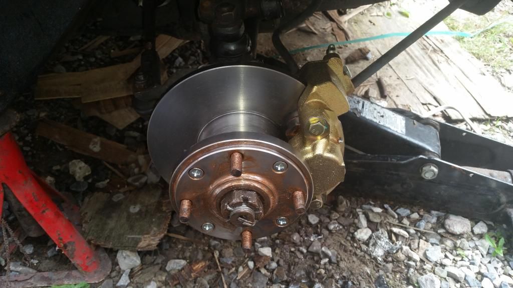

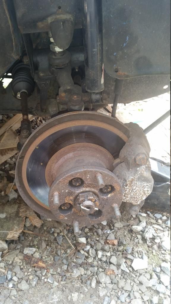

With the TMF+ discount I managed to get the full 7.5inch set up for around £170 .
Did mine recently from this
to this
Stops my 1275 SPi perfectly with the servo too.
As advised on here I did have to torque it all to the correct settings and removed the copper slip from the studs.
