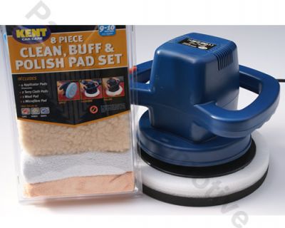

Well ive got two machine polishers soo it cant hurt to try .. Just to find the cloth that goes around them
If you mean the ones with two handles and the approx 10" disc youve no chance (like the Kent one below). You'll need a proper machine polisher thst looks like an angle grinder and someome who knows what theyre doing so you dont end up with scorch marks and holograms
