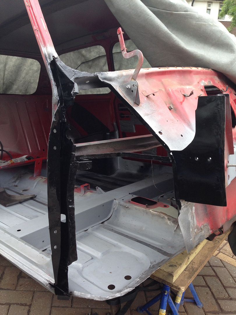

Got a fair amount done since my last update, I'll start with the bodywork.

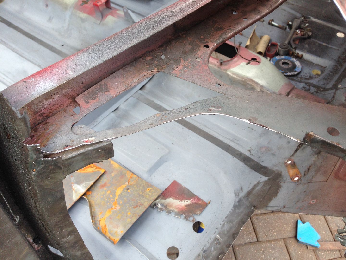

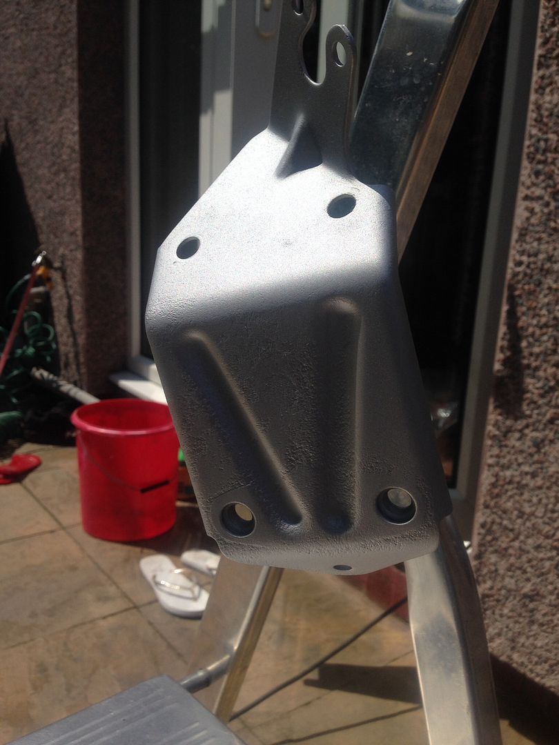

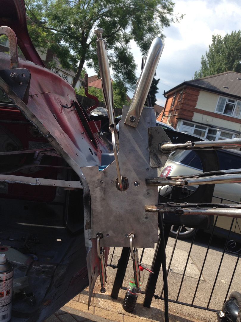

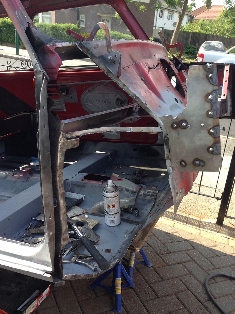

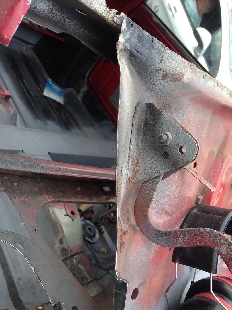

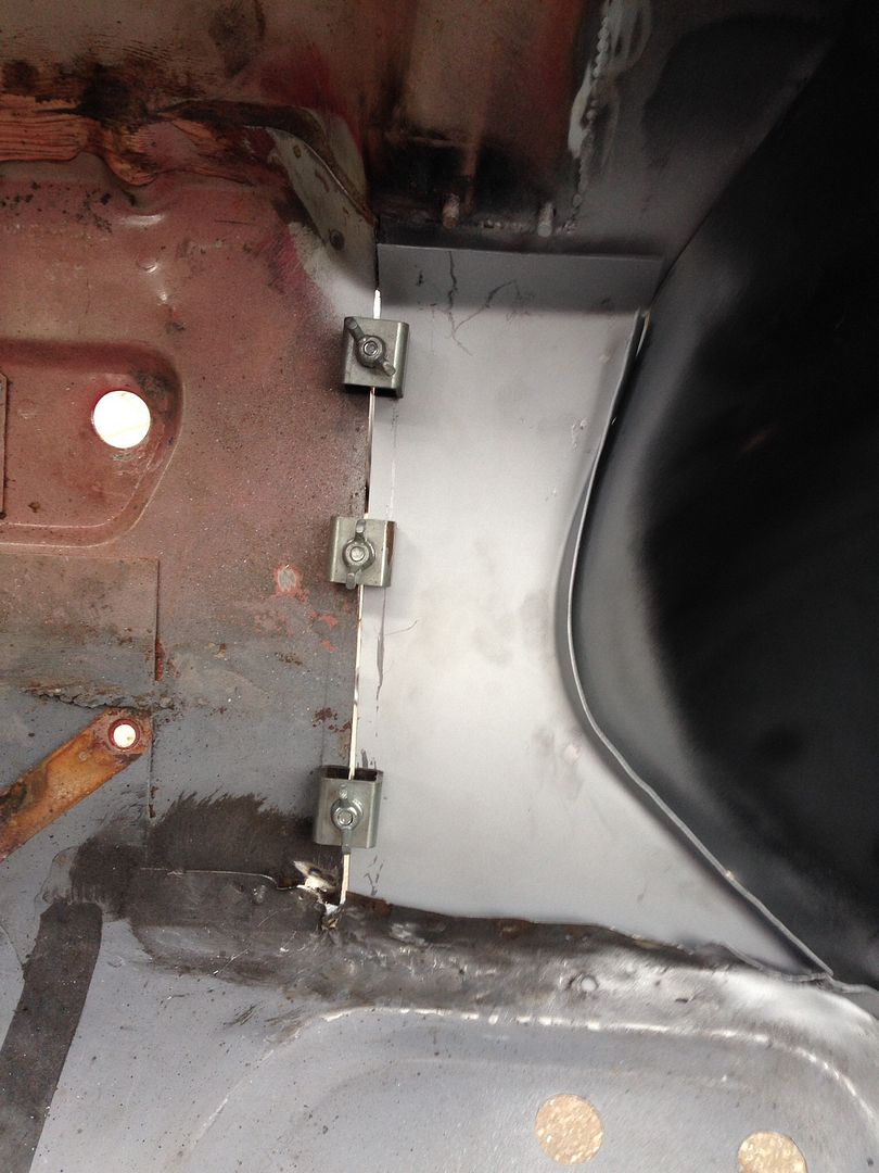

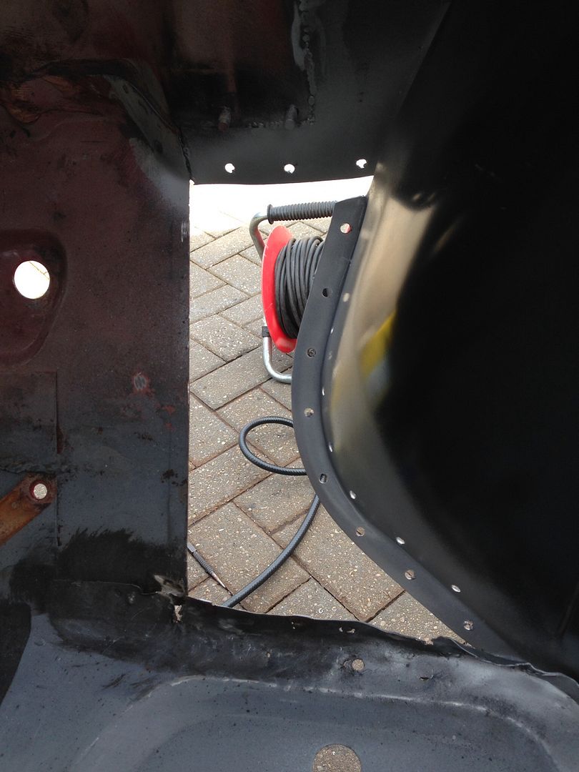

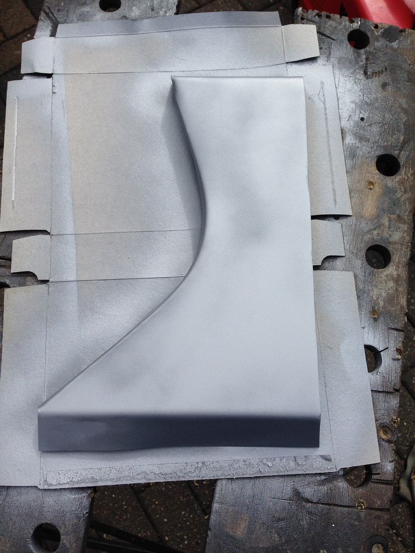

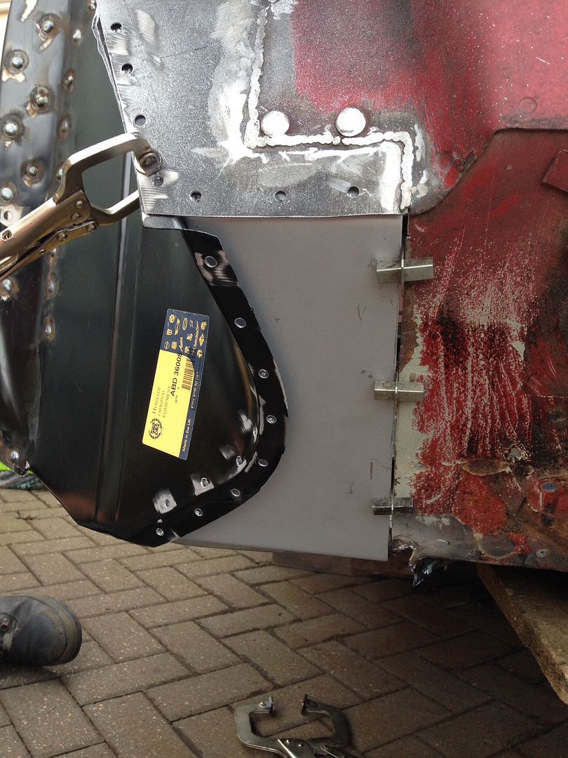

Had to remake the flanges for the dash rail and bulkhead as they were thinned out to much when I removed the old inner wing. So, chopped them off and made some new ones, then welded those in and made a new back plate for the shock mount. We clamped that in place and then welded that in place, here's a few pics of the process -
06643a9751cba45c113a20389e227879_zps461d
b5b449e07298965d5e57f00b1760f72e_zpsc063
16c0c7dce907e26d6ebf2fa698641bbf_zps3c57
e2b4f7a7d523ba18e95cb279e82e183e_zps0594
ed6c63ab61c733a8d3421fc67e3df1d6_zps558b
Ground down the welds on the flanges, and then shaped the backplate to fit nicely, then gave the whole thing a good few coats of zinc primer -
63a221df9f8bcabd685a85ad042c0ba6_zpsa59b
Then some black top coat -
0d564db76bb020796994ff2770327af7_zpsa055

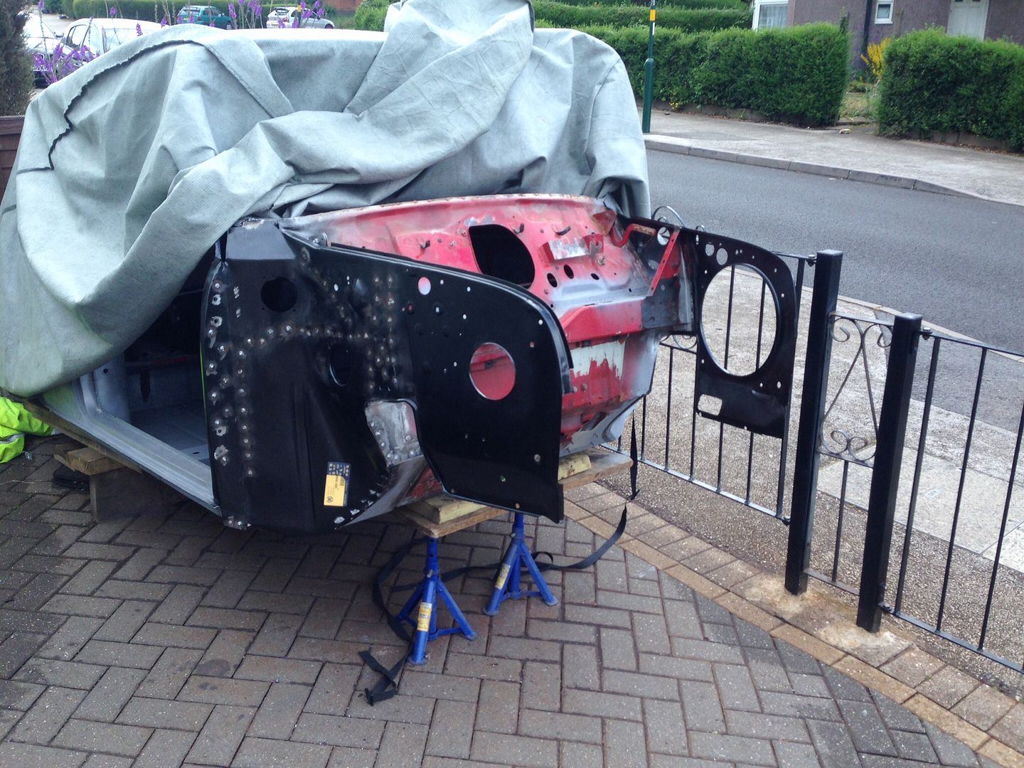

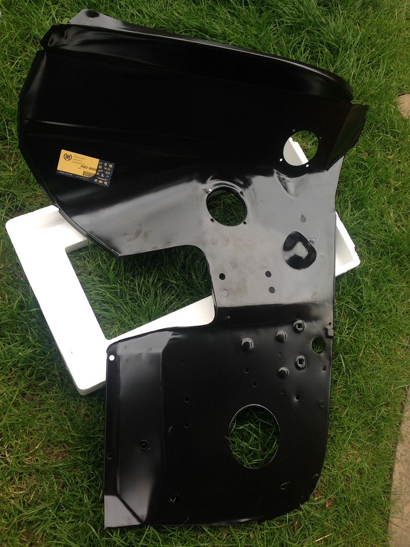

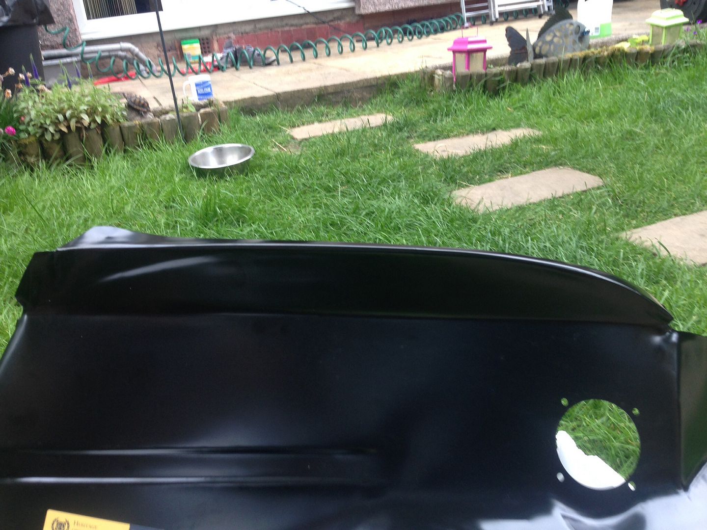

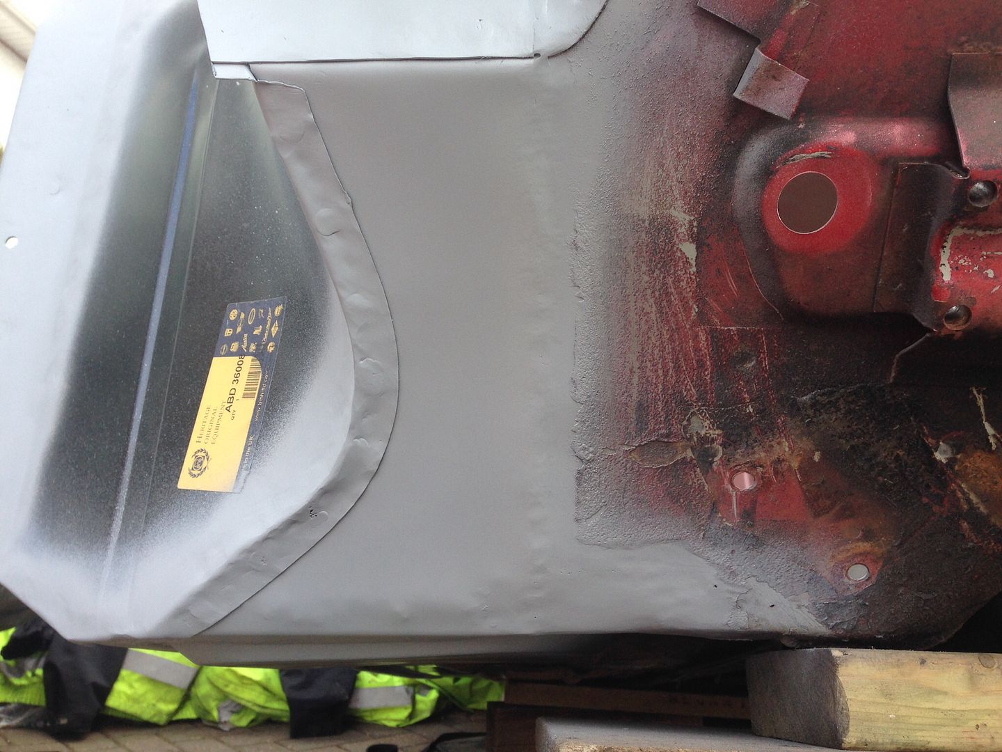

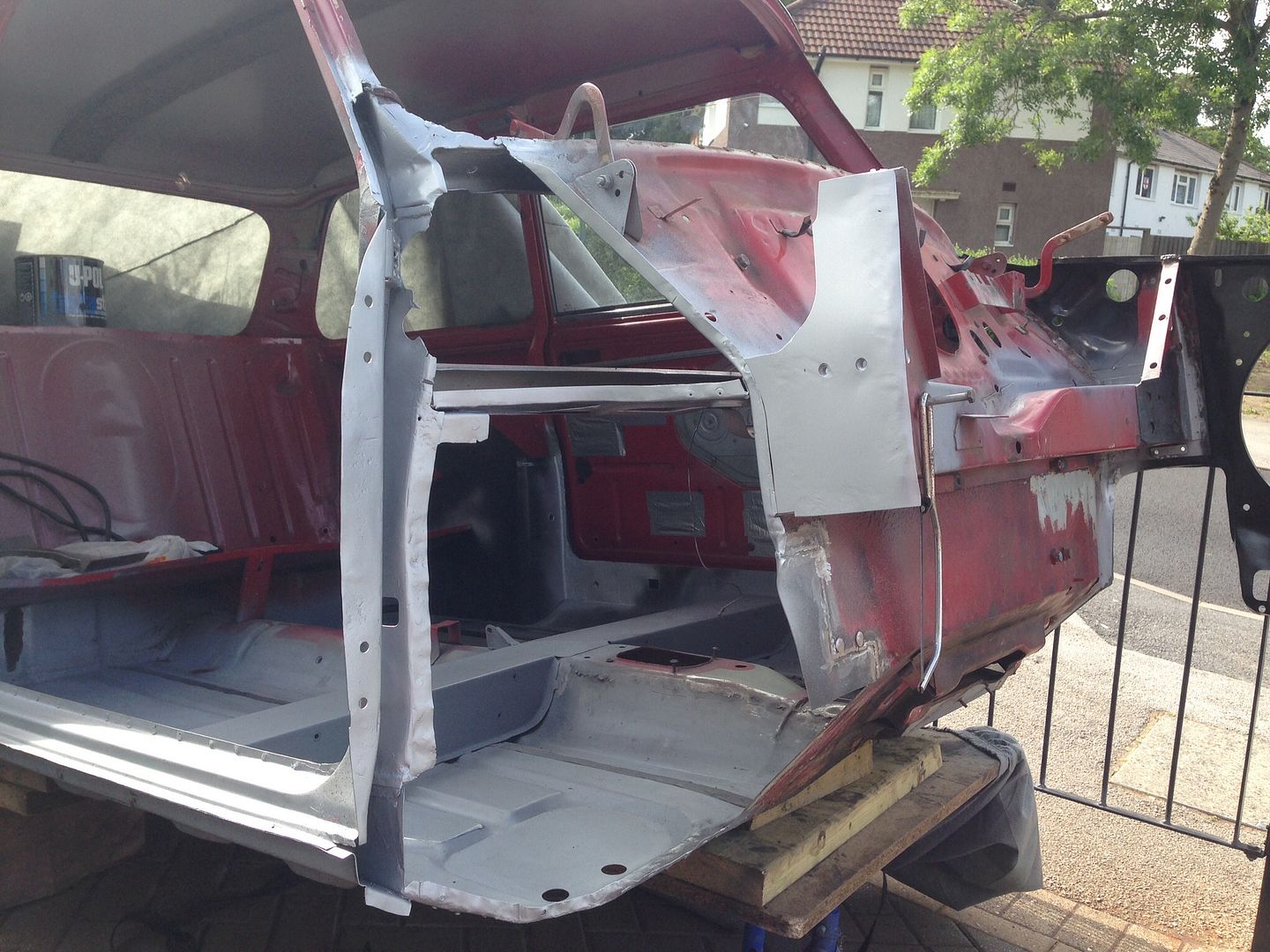

That's all the bodywork I got done throughout the week, doing a bit each day before work as usual. Also received the RH inner wing I ordered from M-Machine -
b1e67b12f1d947a48a988a7376f357d5_zps9783
e29ddb90324f3517b143facf1725fc61_zps10d0

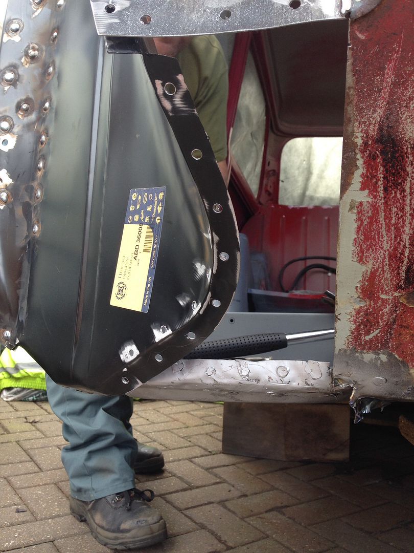

It came without any hinge holes, and after putting a question on here , nobody knew why. So after a few calls to the heritage panel company, I got no where and gave up. So I decided I was just going to fit it and take my time getting it right.
So, trial fitted and it's not too bad at all, just had to do a little fetteling and it was in place -
ee27c294dfc606a8b48440a6ca6eb5ad_zpse38e

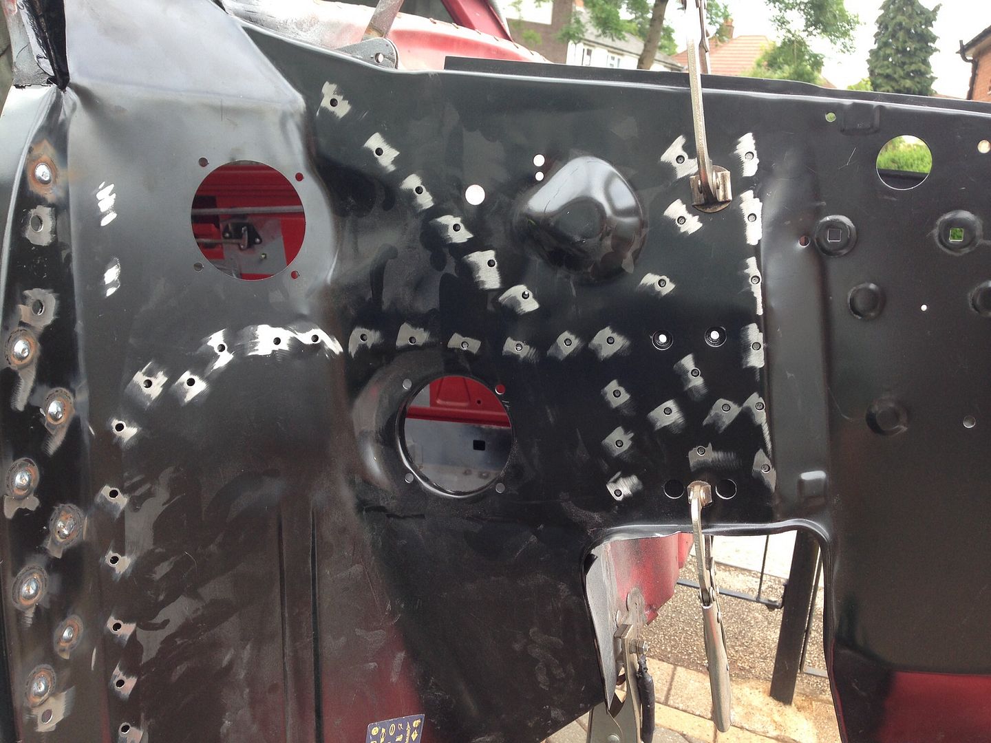

Drilled all the holes for plug welding (already started welding and then realised I hadn't taken a picture) -
d6783915e10e87da7747ef142bbaf28a_zps61e9

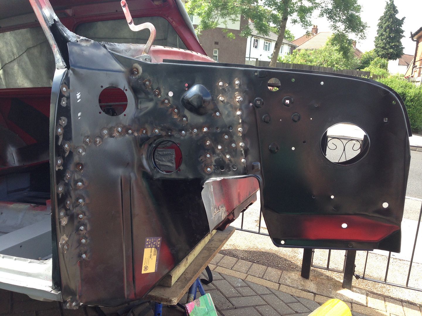

Fully plug welded -
3d087f24f5c38285085a1897982741d9_zps5f2e
0a22e7696301e3ce3bbda25e0dc86005_zps83ff

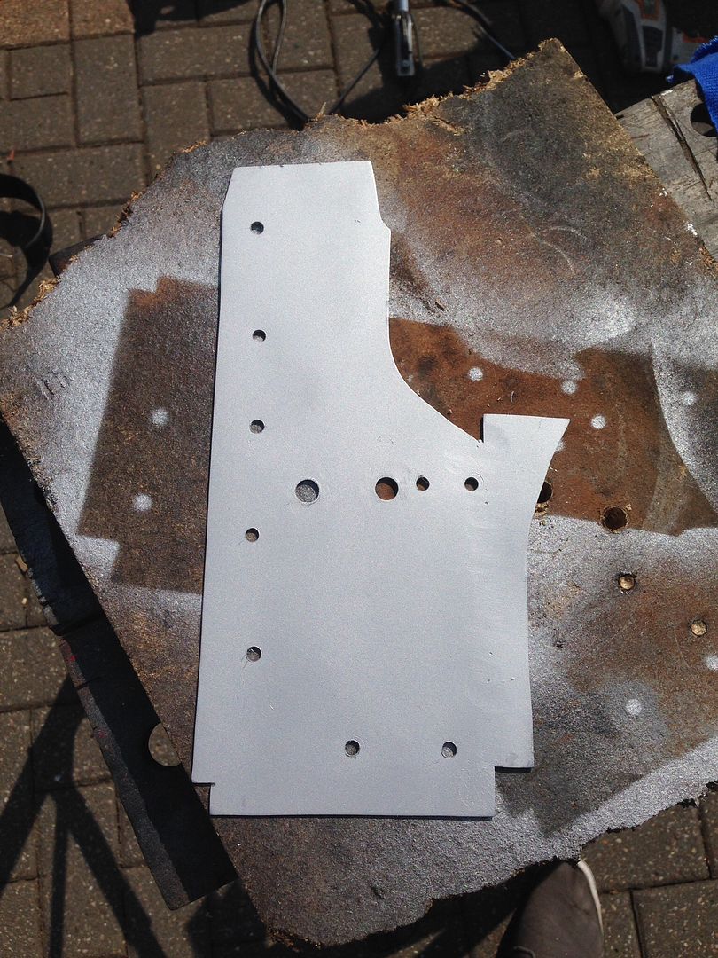

Then we got all the holes drilled and cut the toe board to fit, will be welding this in tomorrow -
60566d9f895140cfeca4ee0969ba59e9_zpsdd1e
1d0eed331bd956b633456469026f4a54_zps3696
99405c6233b56c2e32666fb50cf6da4f_zps1d33
dbf0434dcce9615ee907fc62e8e6f3e4_zps2f01
fe51bf5922caebfc3b5d21e774e548c6_zps9f68

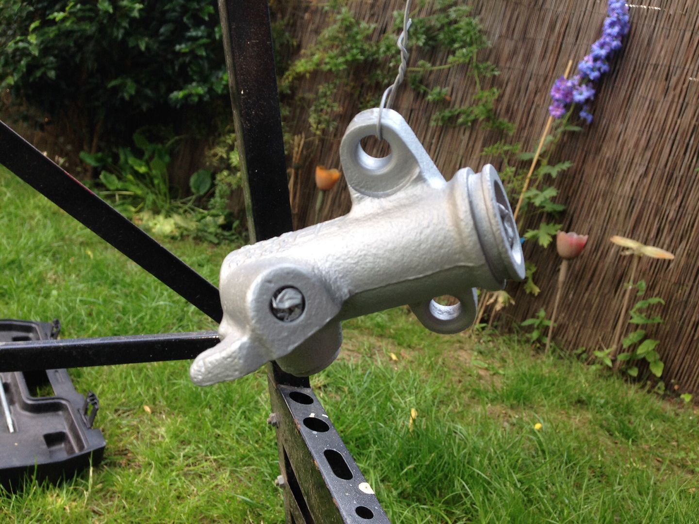

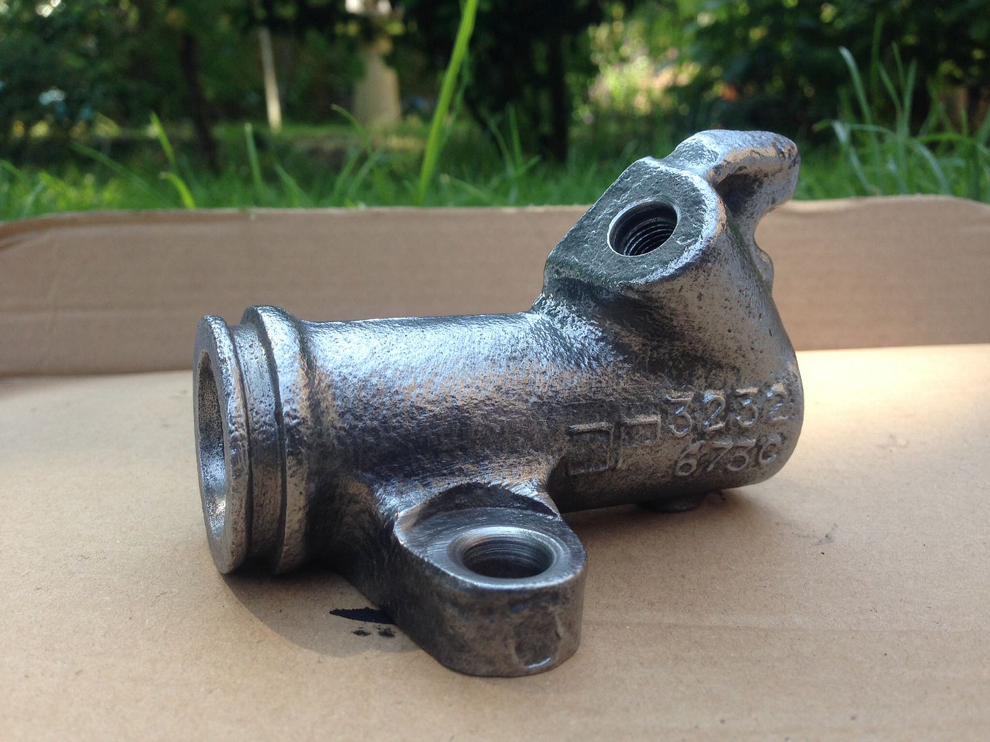

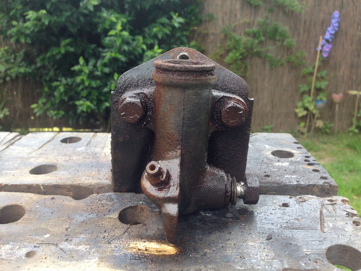

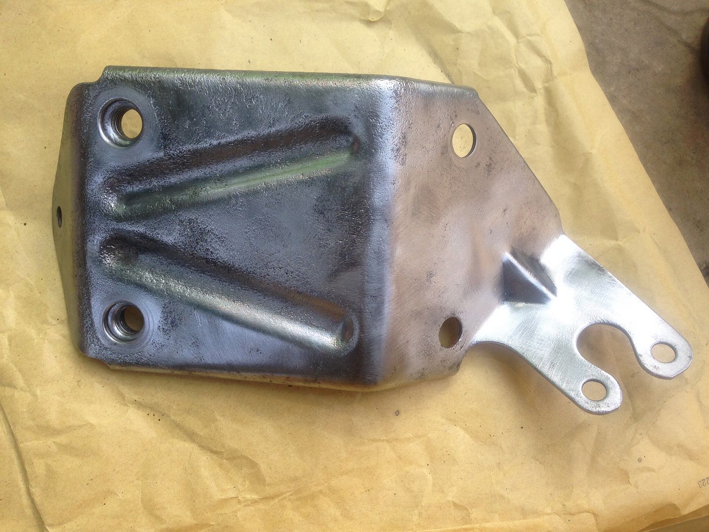

That all the progress on the body up until today. Now for the engine work. Just been cleaning a few parts up and fitting them back to the engine. Ill start with the slave cylinder.

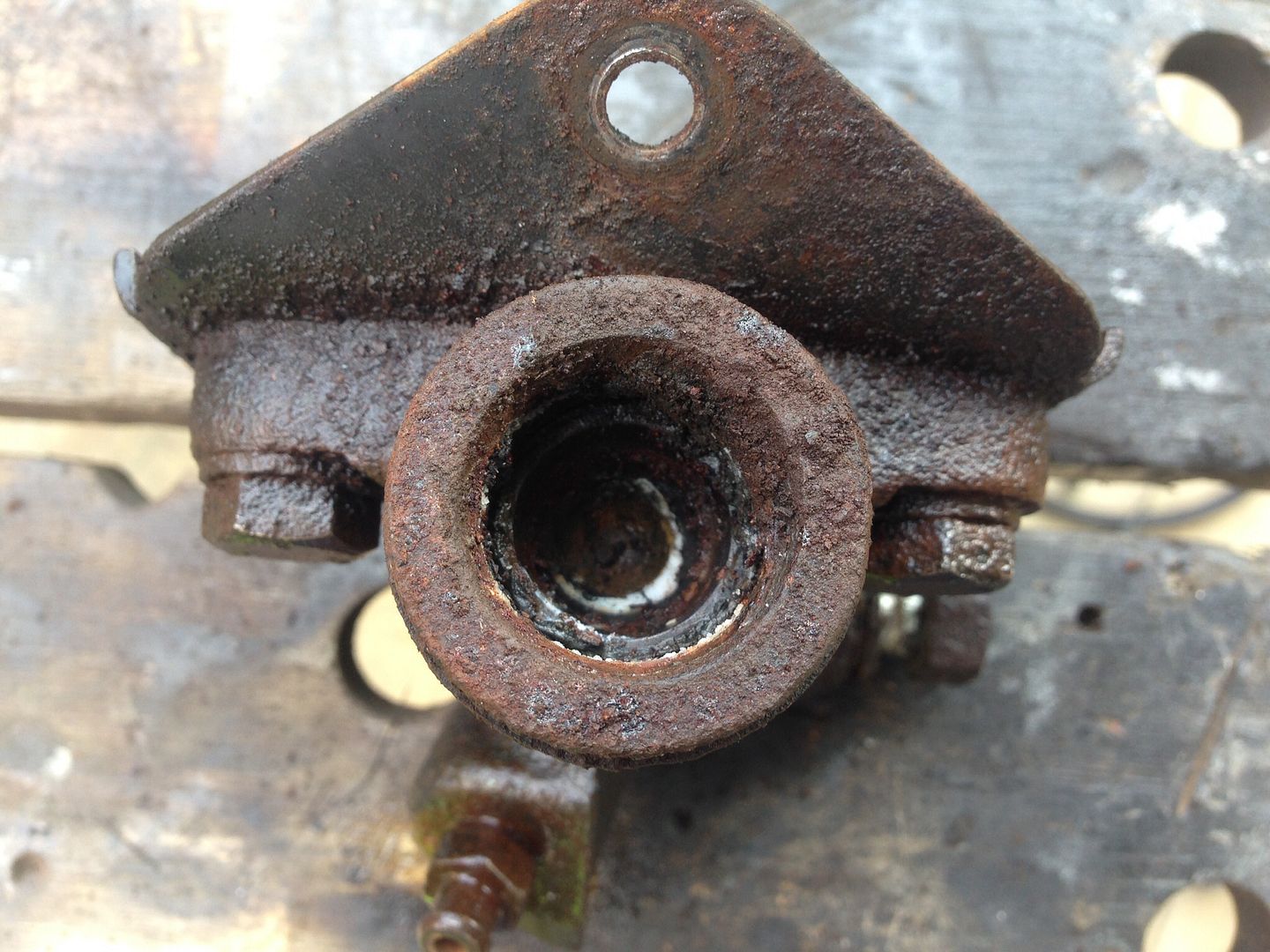

Before, very rusty and pretty much seized -
95AFDB1C-A0EB-4840-9294-4716481123A5_zps
089c24e28f731c25be9b2f7b2950fabd_zps06d2
Degreased the cylinder and the back plate, then dismantled the cylinder and gave both a good going over with the wire wheel -
afa976cb9318b8d4611c9505908defdf_zps577d
318ac9b63c74ebc4383cf220f4d321c1_zpsc710

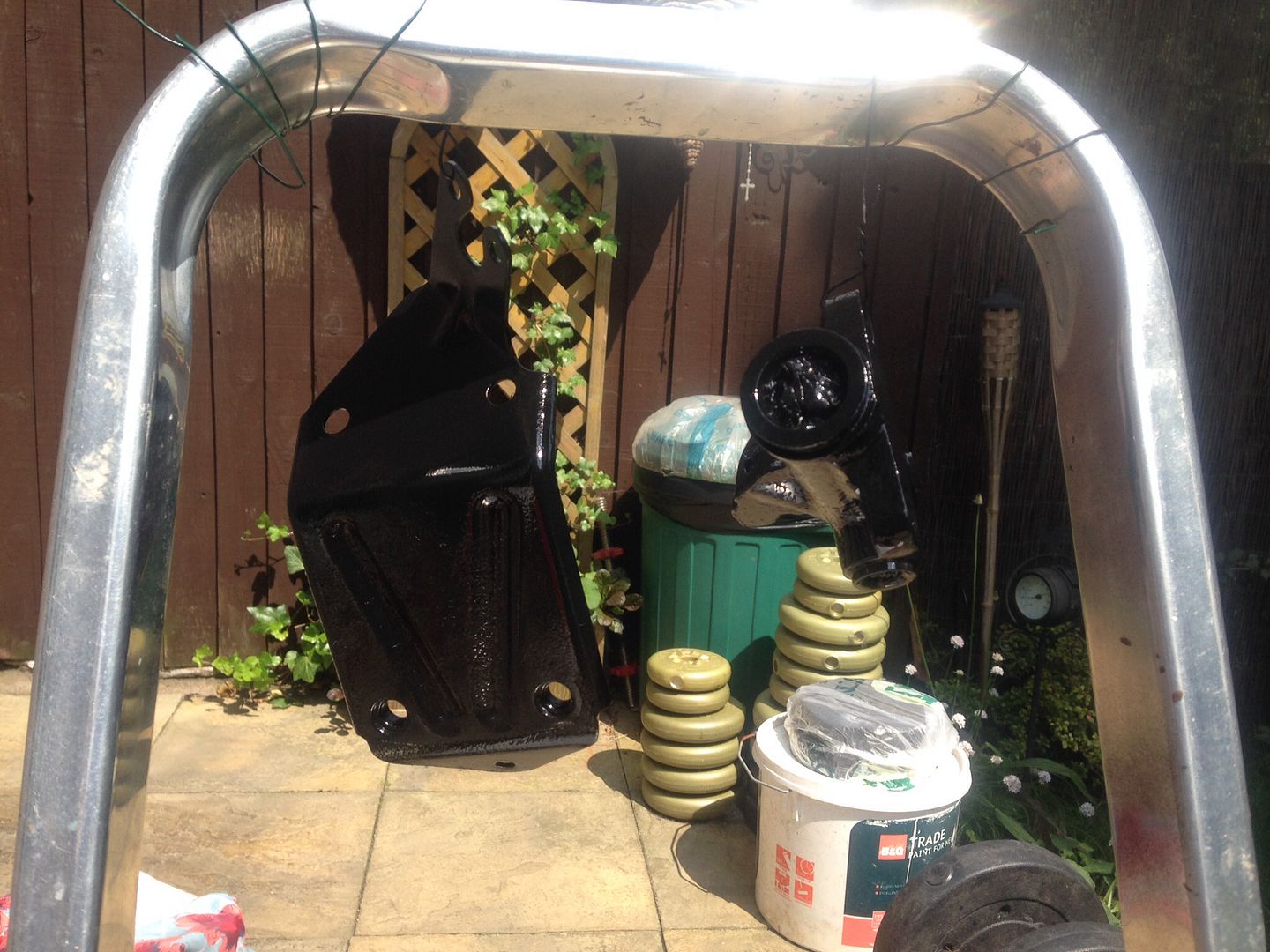

Zinc primed -
0fa519722e96906d291518b7f98fe277_zps1ac8
c6ea0dbe220fafa6b8952592738c8e55_zps7c55
Then painted with a few coats of gloss black -
4633bcedea9ecbe15191e283a620f7d3_zpsed6e

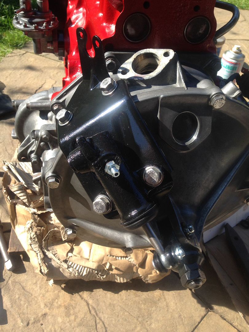

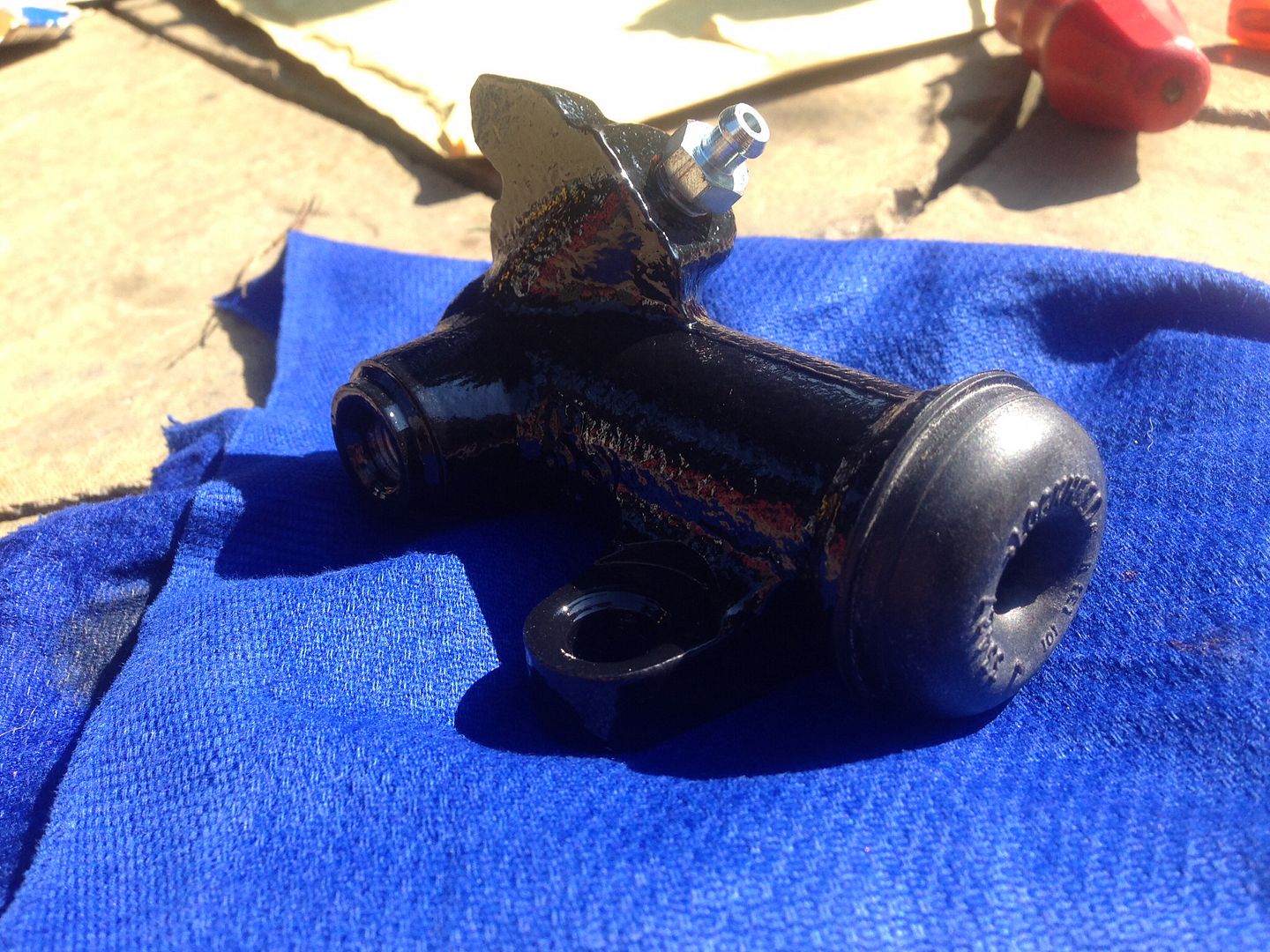

Reassembled the slave cylinder with a rebuild kit, and a new bleed valve -
dedfbba4b92eb6b370a8c8461c1703cb_zps7ea9
Then put back on the engine with a a Smiffys Bits stainless fitting kit -
26e87f52b40ae8debb704afc11f5fd5f_zps7d77

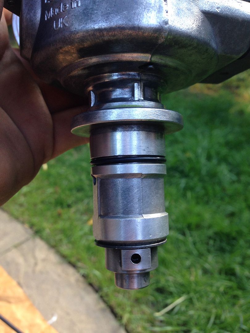

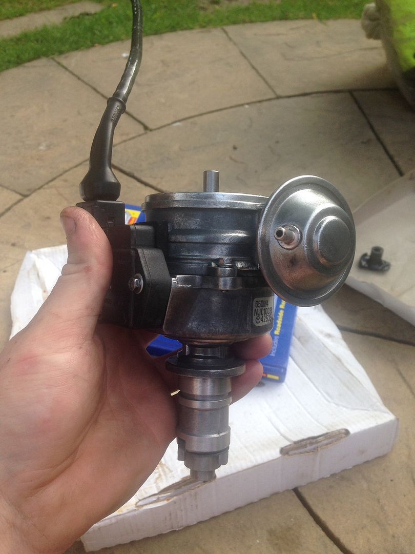

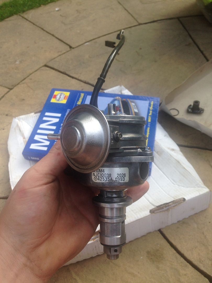

Happy with that, I got to work cleaning up the distributer -
d8076701f87608ece1b0c3fa20f70cb7_zps59e2
d93e88ca967f9f0176d14e9fcde2ebc8_zps8da0
New rotary arm -
229fb9bf10833ad6f544b9b4807966c2_zps41c6
New O-Ring -
2d44d8078eb99308c6296f8854cb21e1_zpsc4b5

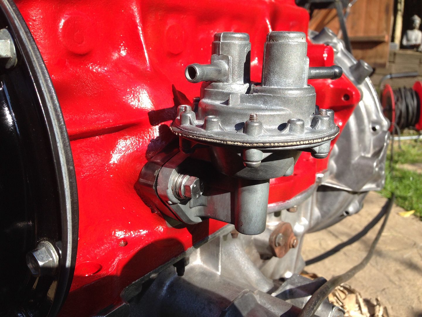

And I've also fitted a new cap as well, no picture of this though. Next I fitted the fuel pump back to the block -
495f30bd0cb9cf6a18a86f7d0541bf8f_zpsc1e8

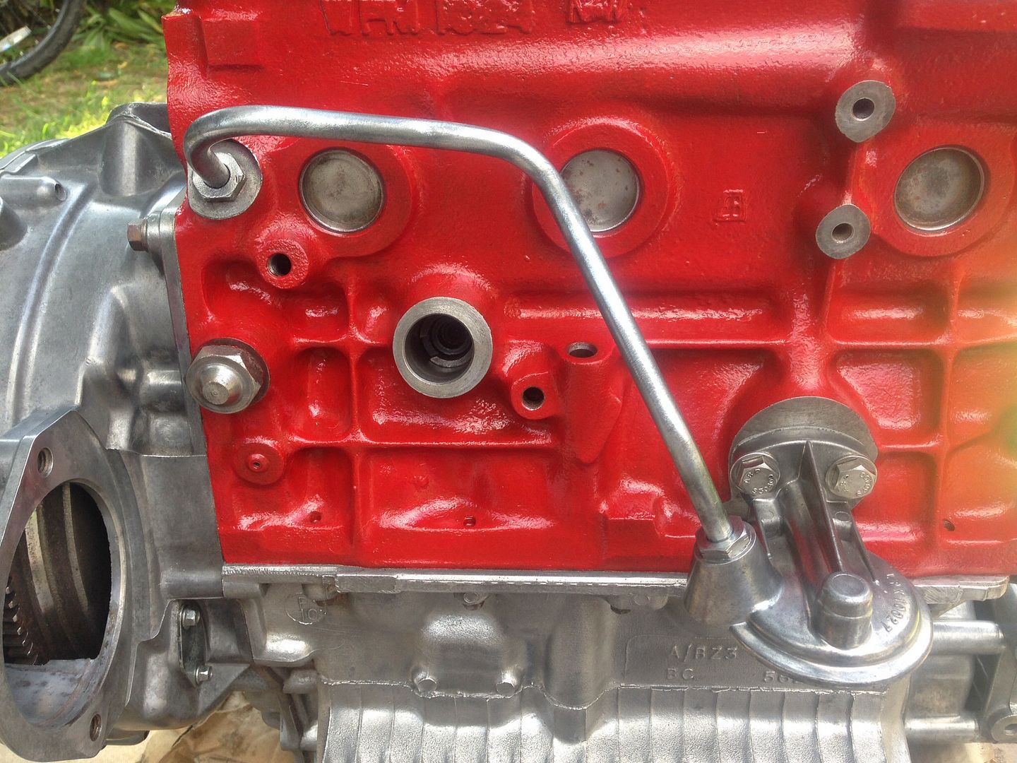

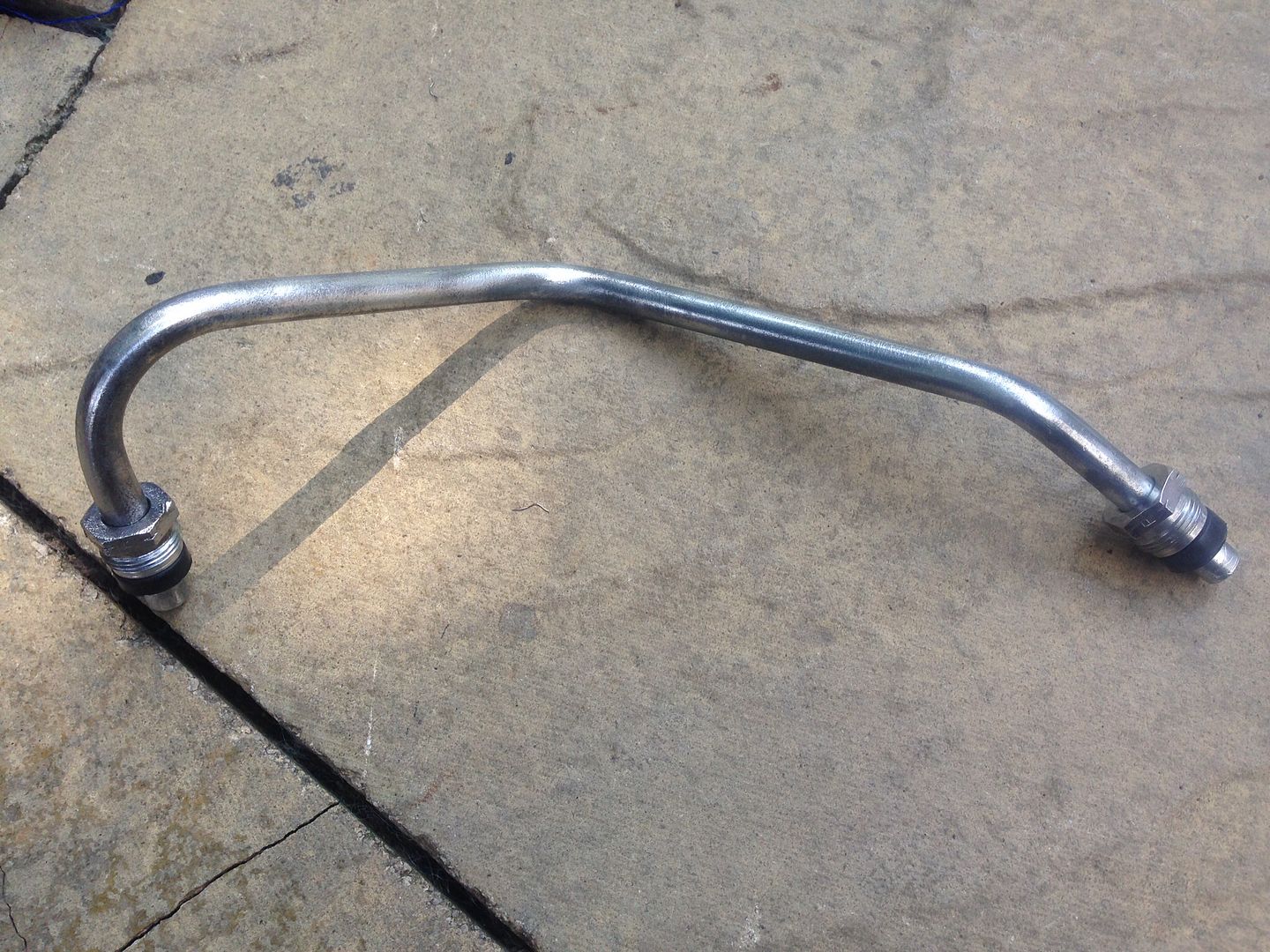

Cleaned up the oil feed pipe and fitted that back in place -
611c5c944aad49194167c174430e33f5_zps4ed8
2a9f0fac35347f81eab408c342542974_zps45fb

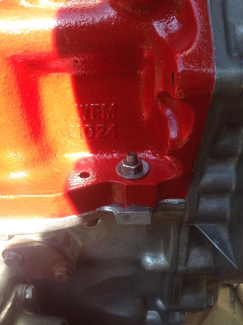

and cleaned up and refitted a gear box to block nut and bolt -
a65adfe464faa748e898cc477e752f59_zpsa4c6

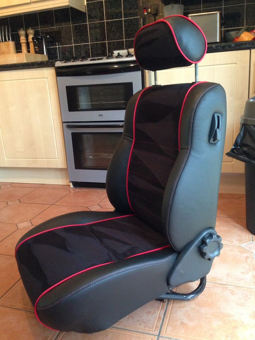

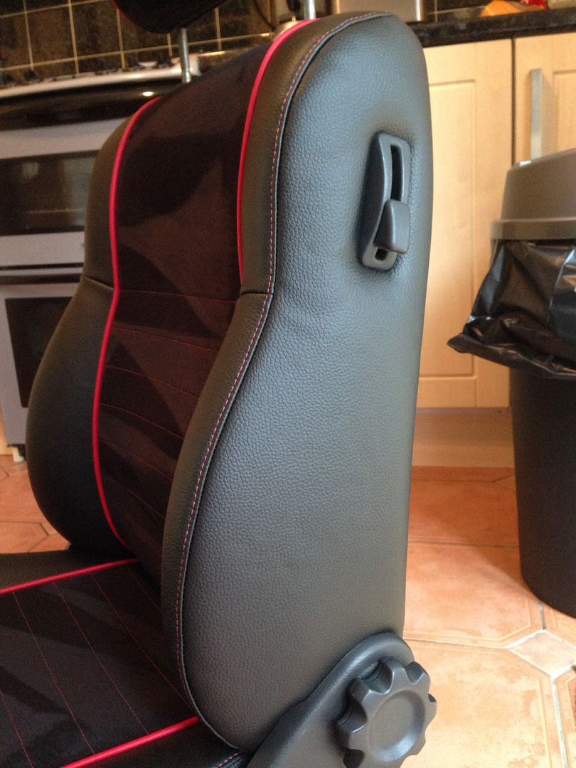

Just waiting on some bypass hose clamps then I can fit the new water pump. And finally, I received my seat cover back from the trimmers, so my dad gave me a hand and we re-fitted it, very happy with it, took some steam to get the creases out of the new panel, but got it looking good in the end -

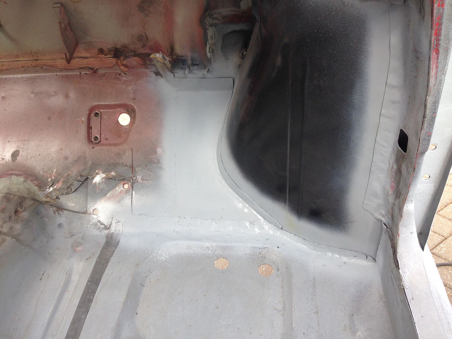

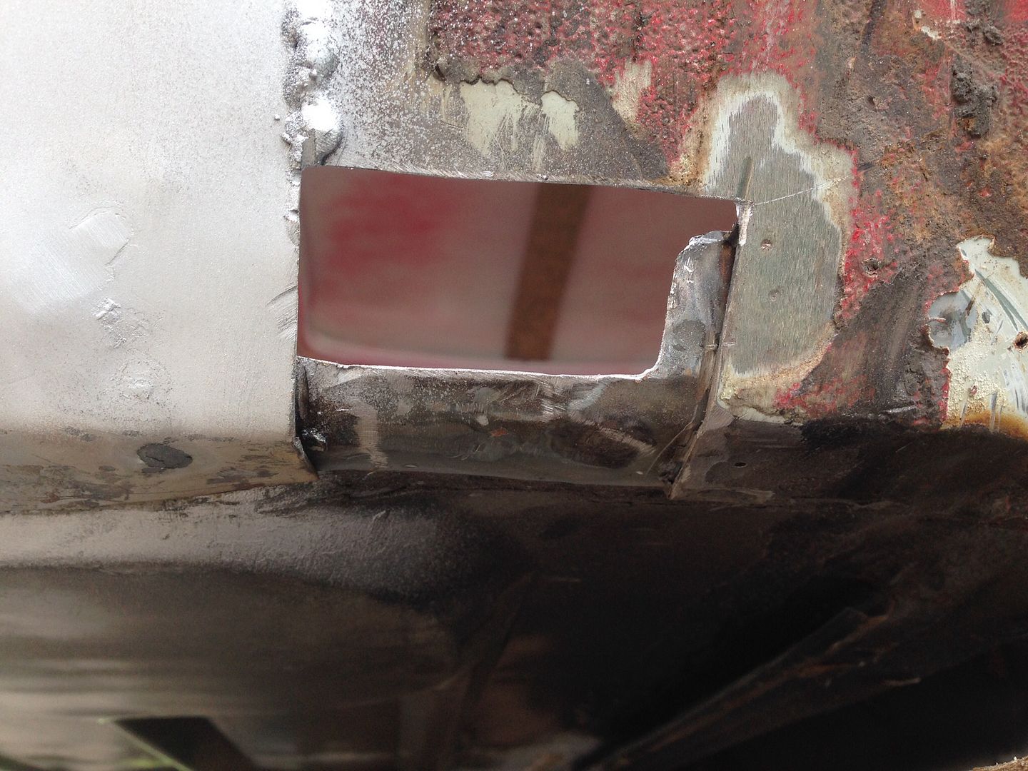

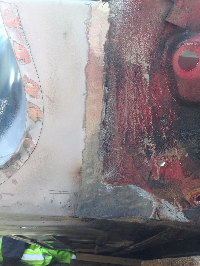

Got the toe board repair panel welded in today, some pictures of progress.

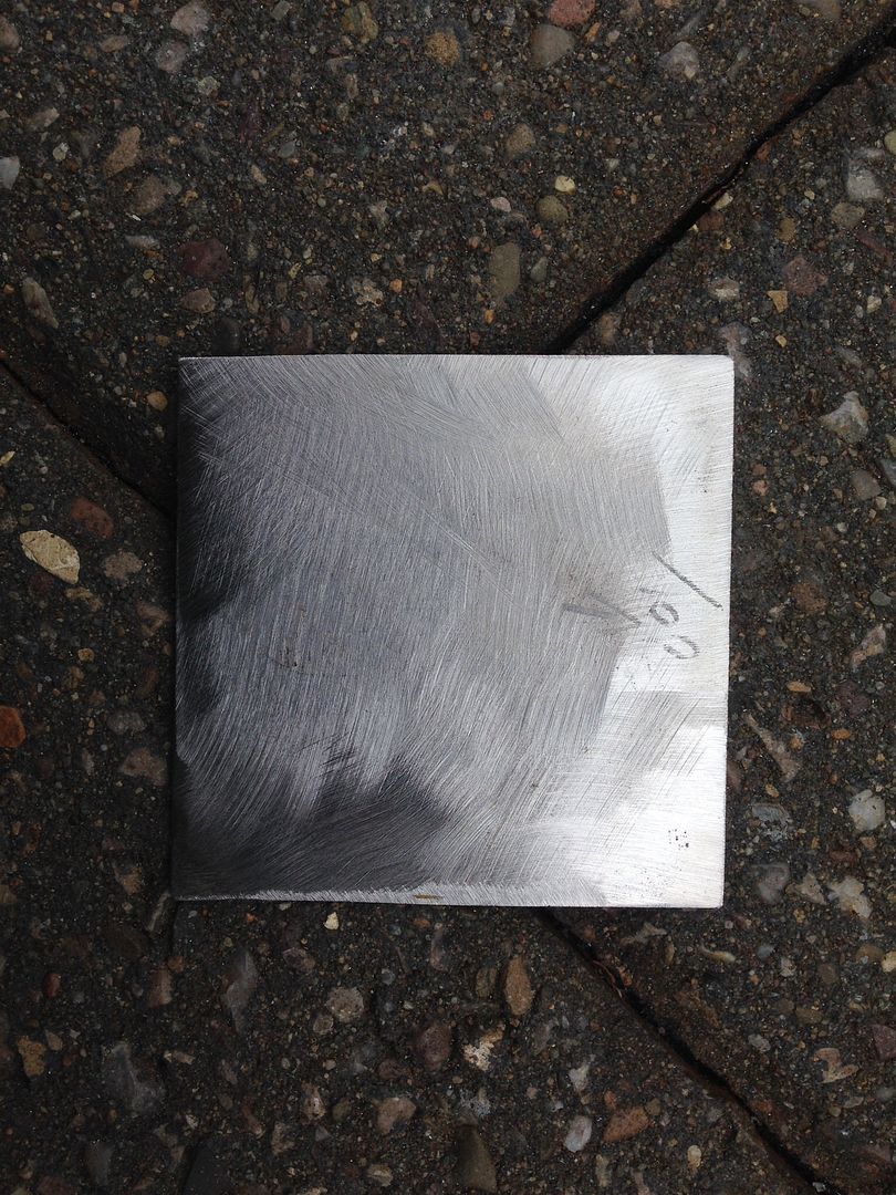

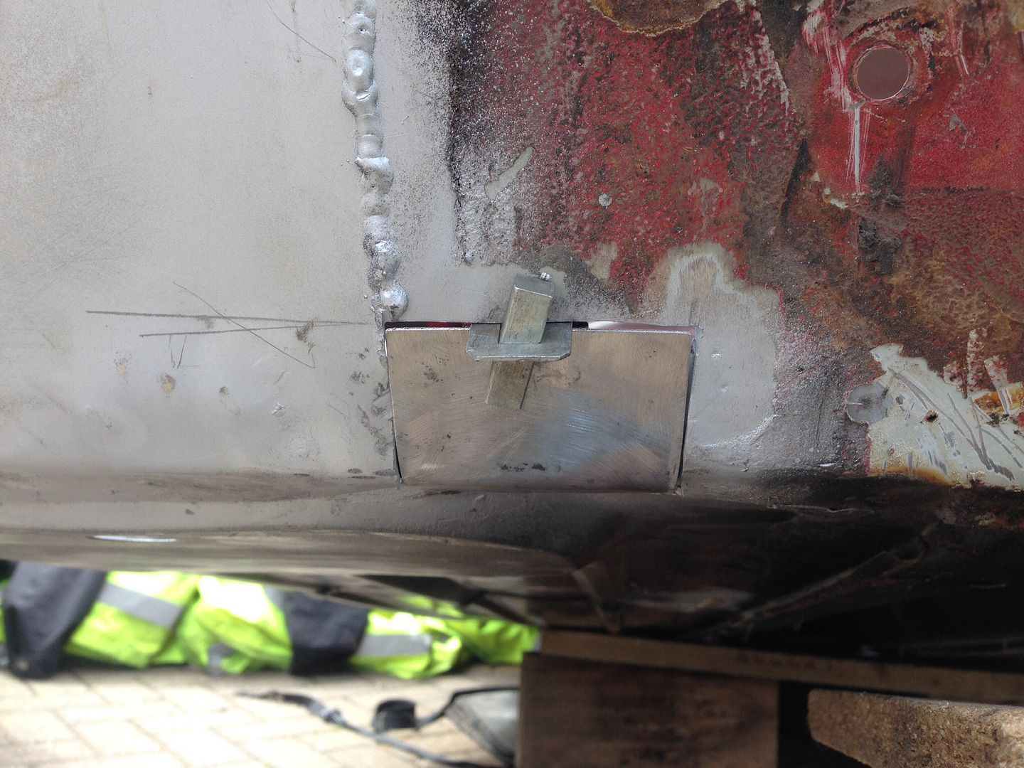

Had a small hole to repair first, hole in question -
9826a311441249f8d858626777f9f6e8_zps35ba
Repair piece made -
51b0649e415d24bfe4994b5d6b47cee9_zpsb2ea
Bend put into it and fitted into place -
94a86bbc5d8b7c760e39cd047506250e_zps2160
Welded in and ground down all the welds (I also repaired the floor pan lip on the inside on the car, no pictures of this though) -
870f7f698aa73ccfb59aa291b8c34194_zpsd539

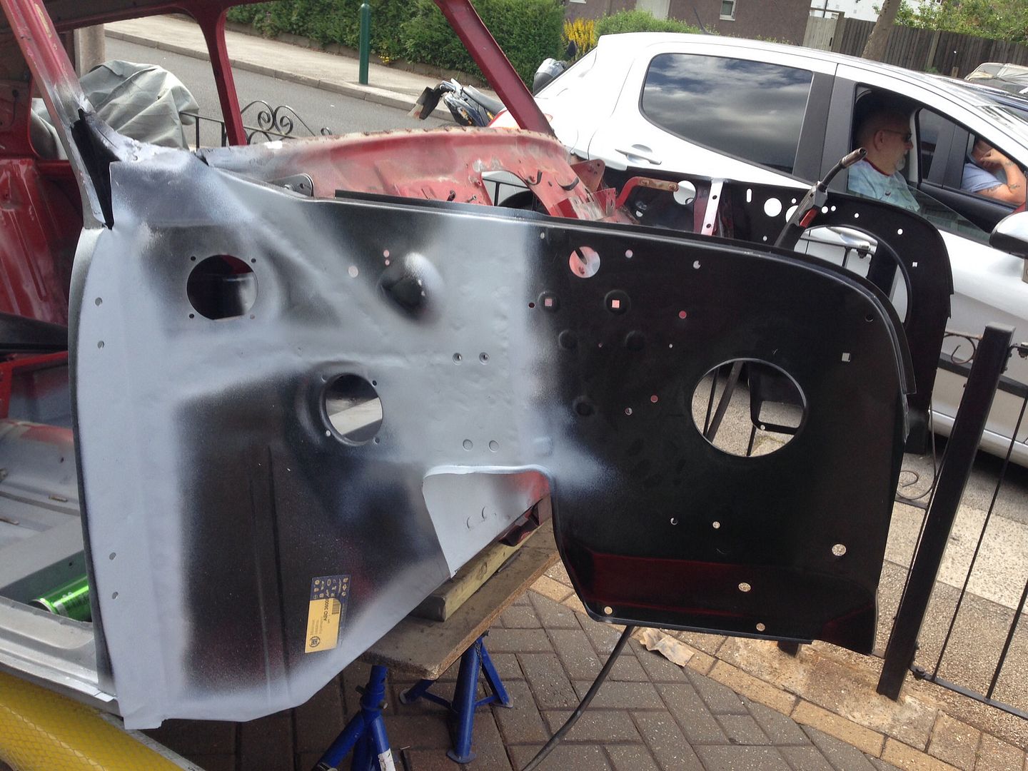

Then I ground down all the plug welds on the inner wing and applied some primer on all the bare metal areas -
4d8d89bd0df115a5c89bd511d320ed51_zps1493
d861b6d4c960ff6262f2ec94bd0a6128_zpsfcc3
9c6312bee2dd90e240f0ca1ddd815440_zpsb748
33a6b1c3f48e9c935c9fa0ff01ee0f23_zpsccd7
Really happy with this repair, looks really tidy, just got to seal it all up now and then we can start on the front end. Going to flip the car over first though and get it all primed and sealed underneath.
I also went down to the place I'm thinking of having my car resprayed yesterday, I had a look around at some of the other cars they're doing and it looks like there work is of a good standard. They've got all the proper kit, booths and an oven so ill hopefully be booking it in within the next month or so, can't wait.
They had a MK1 Fiesta which has had literally every panel replaced by the look of it, and they also had this in there for some bodywork -
e594aed32dbabb707370102939987da8_zpscf65
Very nice, I'd love to own one of these, one day maybe !
Anyway that's all I've got done today.

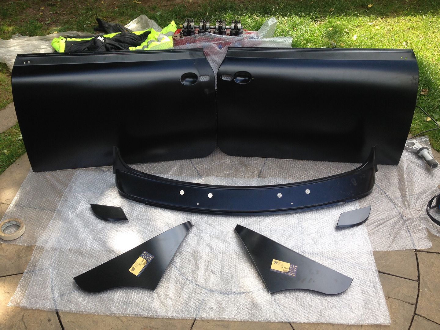

Parts update,
Received a nice big package from Minispeed today, felt like a kid at Christmas again :lol:
73fc9880721ce013a98ad0985a29bdeb_zpsb7e1
The contents -
78264d89a7c576a2aa38f8ab8297a952_zps7dd6
All my Heritage panels I ordered on Thursday. That's pretty much all the panels I need to finish the Mini off.
