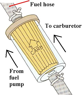

To start with put an inline fuel filter like this and run it for a few days. If this solves the problem then you can narrow it down to dirty fuel. If the problem still persists then its time to look at other things.
The filter should cost £3 - £4 from a motor factor

A see through fuel filter under the bonnet will be more use for making any fuel starvation visible than making an improvement through filtering. There is a strainer on the end of the pick up the tank inside that could be clogged, but there are other possibilities. The height of the saloon tank means in can contribute a fair bit to the fuel pressure through a syphon effect when full, so it could be the pump, or just gunge anywhere further up the line. Giving the carb's float chamber a clean and resetting the float (check it's not punctured too) would be a decent start. You can blow back along the fuel line to try & unclog the tank strainer, but it's likely to clog again, if that's the problem, unless you remove & flush the tank; there are products available to coat the insides of flakey tanks. Another option is a blocked tank breather, easily checked by removing the filler cap for a test drive - not with a fuel tank or in the rain, obviously  >_<

I've seen the see through filters just ordered one think that's the first thing I'm gona try!x
