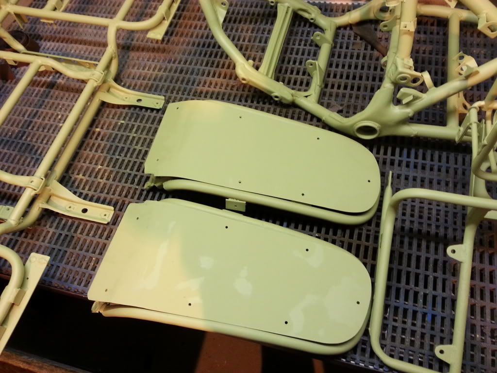

I have also fabricated 2 new fenders out of steel tube and alloy plate this is because one side had cracked off. here you can see the U-shaped parts sat on top.
Edited by dominicdee, 08 August 2013 - 02:10 PM.
#6 domdee
domdee
    Formally known as dominicdee
  • 1,183 posts
  • Location: hull
Posted 08 August 2013 - 01:24 PM
here the fenders are fitted. i used thin alloy plate.
Edited by dominicdee, 08 August 2013 - 01:48 PM.
