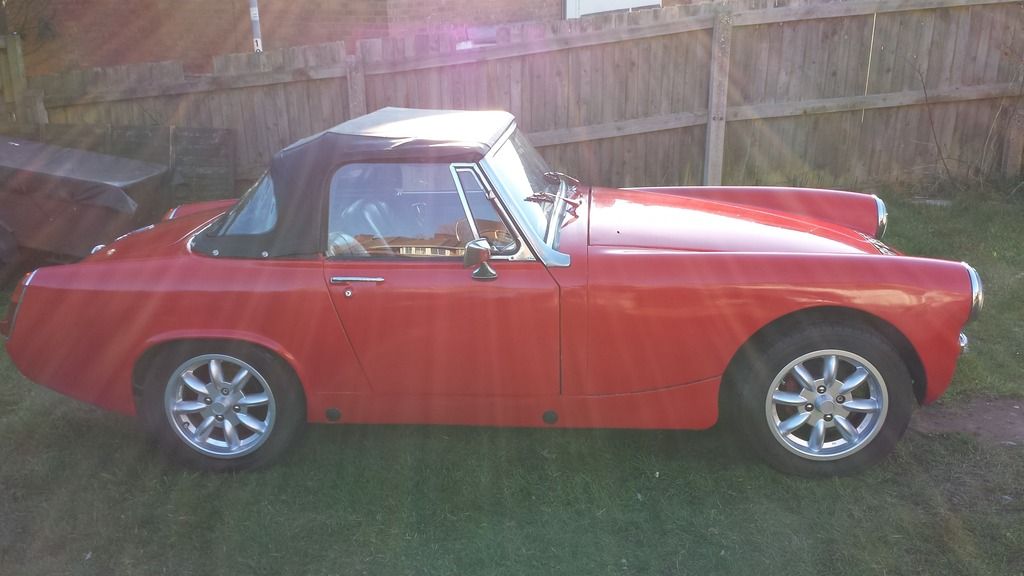

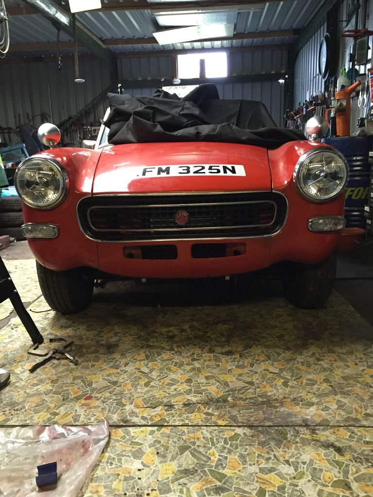

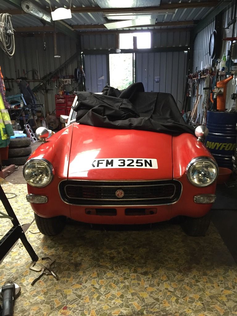

Been a while, yet again
Managed to find a 1275 Midget grille from ebay in America (with postage and import fees it was still £130 cheaper than buying one from UK)
Fitted with chrome surrounds, and sorted the large indicators for the smaller type on the 1275 :)
I also have some 5X13 minators that have been fitted with new Yokohama tyres, will get some pictures of them soon :)

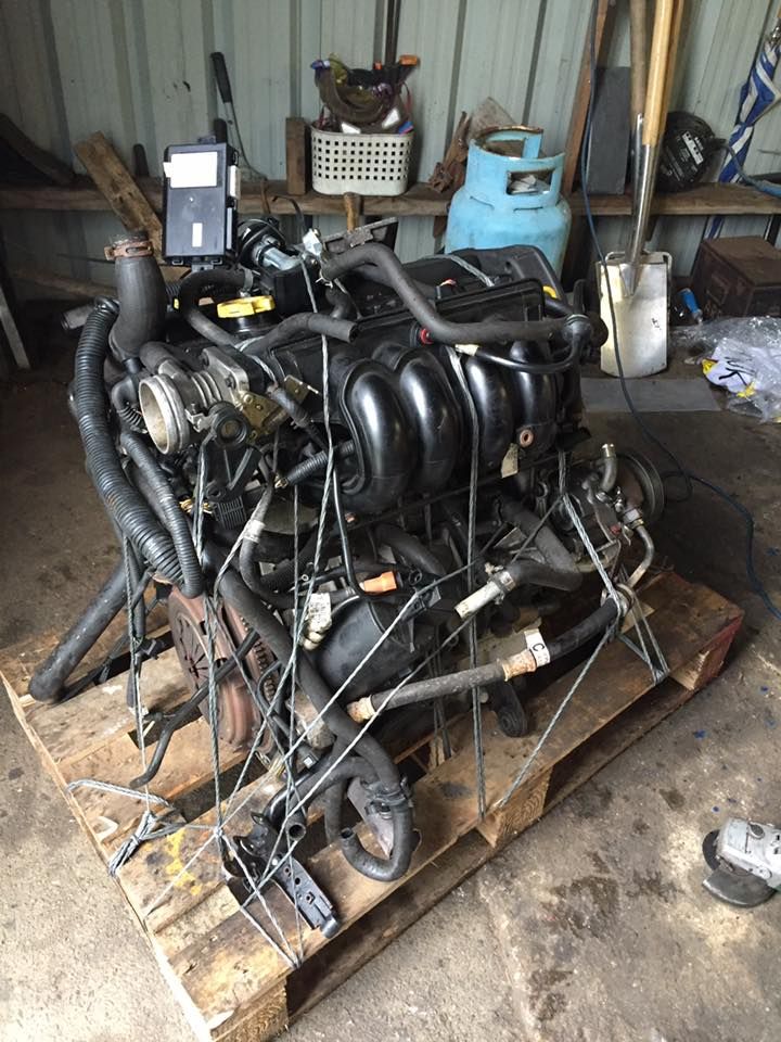

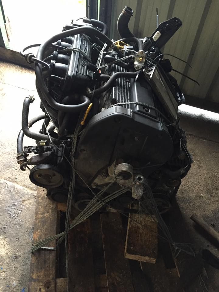

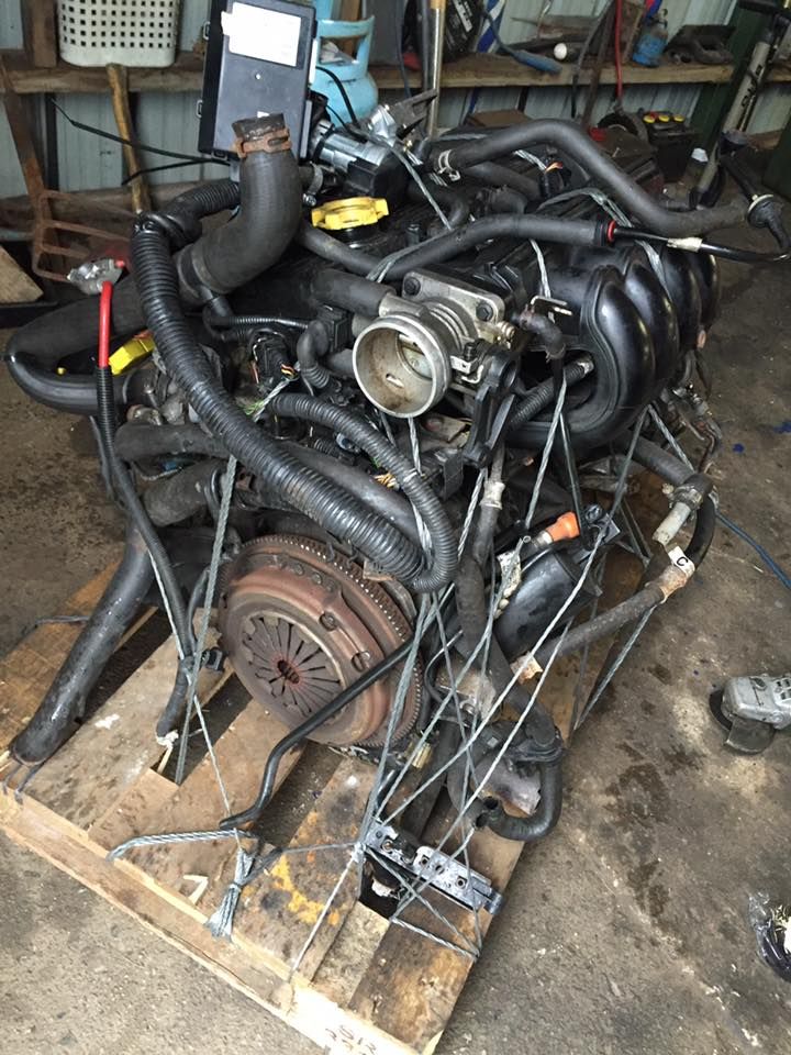

Bit of an update
Fitted the earlier quicker rack, omg...it is immense with a 10" steering wheel :D
On another note, I decided that the 1500 does provide the power I was hoping soooo......
K Series Power is the way forward :D
Managed to pick up this engine 1.4 MEMS3 for £75 and bought all the necessary parts to go with it. Timing belt, oil pump, water pump etc etc
Decided to buy the N Series upgrade kit, which consists of stronger engine bolts (rated at 10.9 instead of the original 9.8. A MLS head gasket and stronger oil rail)
On stripping it I found no signs of HGF and quite possibly it's original gasket (engine has done 58k)
Currently on the lookout for a Type 9 box - they seem to be quite expensive >.< I did toy with the idea of keeping the original triumph gearbox but thought it wouldn't last very long.

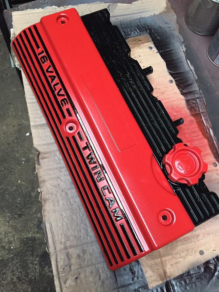

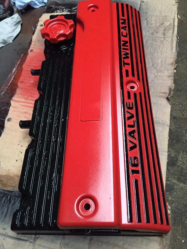

Yeah this is very true, the main reason I went for the 1400 is that that's the size the K Series was designed to be, and is supposed to be more reliable than the 1600 or 1800.

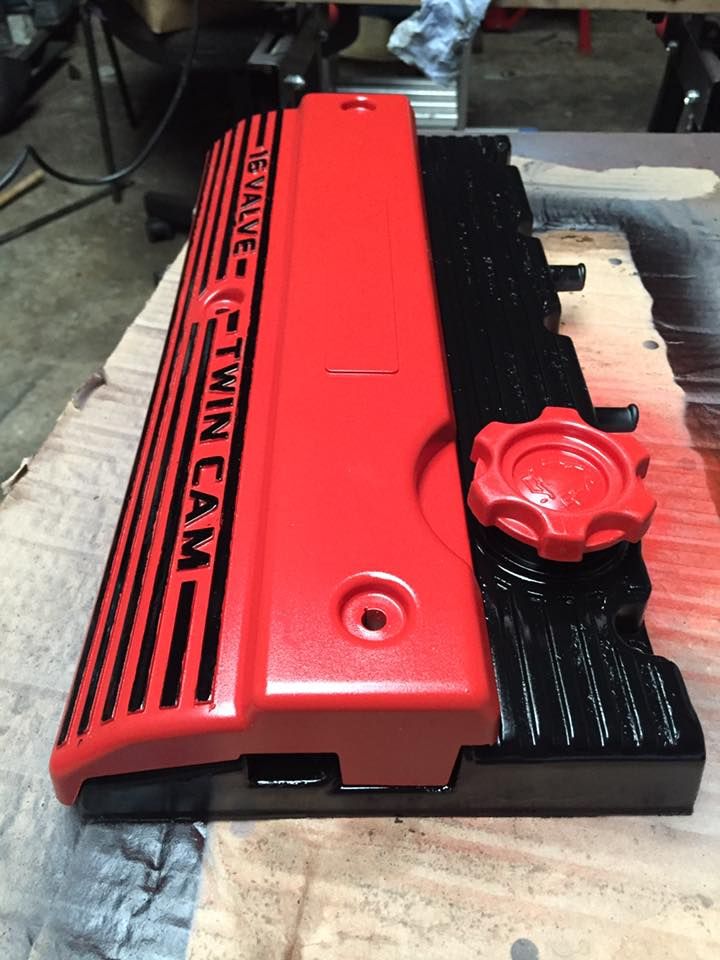

I've done some other things in the meantime, I know it really should be the last job to do, but I couldn't help myself.
Oh and yeah, the colour looks like a red/pink, but it is in fact Flamenco which is the same colour as the MG. :P

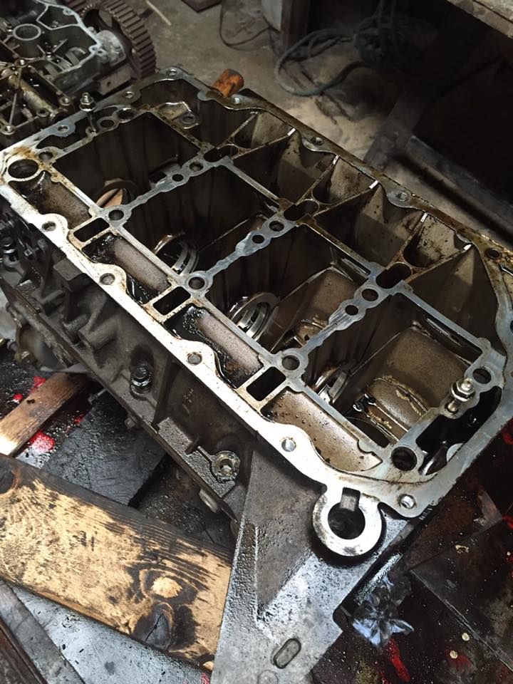

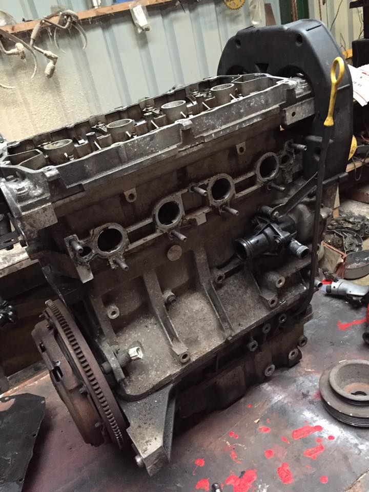

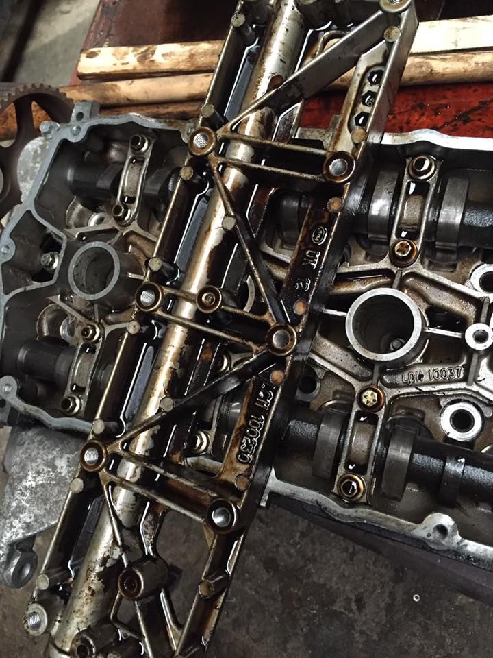

Posted 22 July 2016 - 09:28 PM
Managed to get the block stripped down completely, sump and rail. Gonna take them to work where I can steam clean them :)
Whilst it's stripped even though the bearings are in good condition, I am going to replace them.
Not sure whether to paint the block or not....
13754558_1264627636888773_43162625300821
13782084_1264627593555444_21719147536035
13697072_1264627603555443_32740661542437
