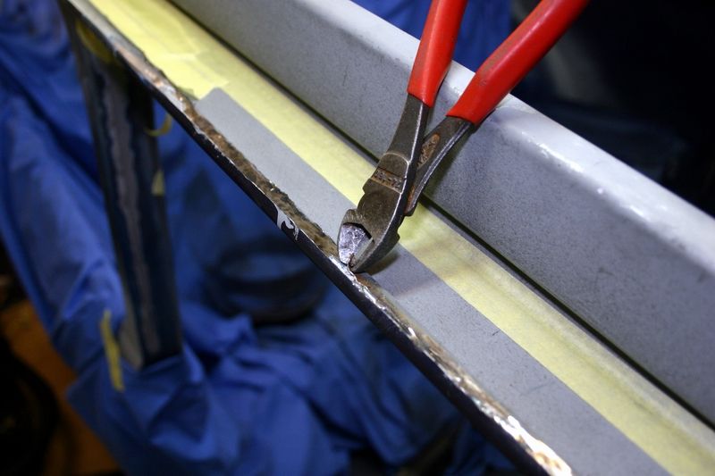

Now I have a bit more experience with the angle grinder, thought I would grind the remainder of the roof skin off. I prepped the roof surround and poured zinc primer into the seam
Then using a grinding disk, "thinned" the metal to get to this. Pic is from the top of the shell
Then peeled it back like a tin of corned beef with wire cutters. Note the masking tape to prevent swarf getting into the seam
What's left is the continous weld
Here you can see where I ground out the weld
At the rate I'm going, it's going to take about 8-10 hours to sort this. It's also a right PITA to do so the plan is to do a bit every day.

That’s the best way Ben but I wanted to get it done and all the grinding dust cleaned up - it made a right bloody mess! Once I got cracking and got a feel for the grinding depth it was pretty easy
Used this tool to peel the old skin back
It’s easy to do a half arsed job of this but I wanted to completely remove the old skin. This will allow the new skin to fit properly and avoid distortion. Managed to peel it all off
This left the roll welds just proud
Dressed them up and the jobs a guddun
Glad that lot is out of the way
