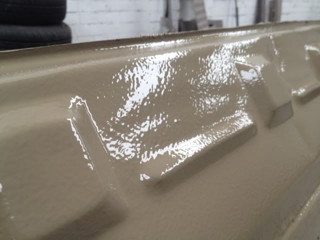

hi i have just restored my mini and have given the entire under car 3 coats of schultz (for protection) then painted over in body colour no problem , the only draw back is the schultz stays soft so can be scratched off easily while reassembling the car as i found out :ohno: ,but no problem with the paint over the top .

You fitted oversills :-( usually it cant be overpainted you will find problems in the future

You can't paint over schultz (well you can but it's not going to come out well).
You can paint over stonechip - which is usually applied with a schultz/schutz gun.
Are you sure that what's inside is schultz? I would have thought it would make a horrible mess on the back of the carpet. Minis were mostly fitted with bitumen sound deadening pads in the floorpans - you can paint over these.
Stealth05 - Coversills are a bad idea and I bet you'll be replacing them again 2 years max unless it never comes out of the garage. Very foolish shortcut.

sorry my bad didnt realise you were doing the inside ,its a no for interior even with out being painted over
as for oversills , cheers guys but the past owner had fitted these while restoring it before he passed away with cancer , the old outer sills had been removed before these were fitted and all rust cut out and bare metal treated :X
