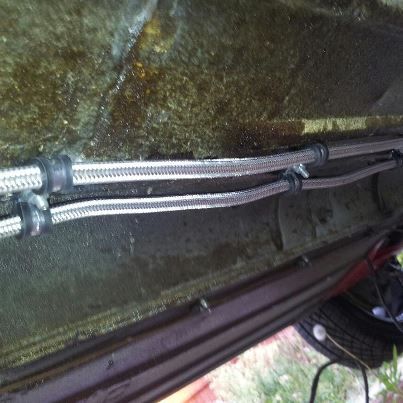

I had this very dilema a few weeks ago and after ruining the first copper pipe I installed I gave up and went braided. Wasn't too expensive in the end. 8mm feed and 6mm return came to about £30 in total

and thanks for the pic Stu, whats the return pipe for? i thought theres usually only the one pipe?
