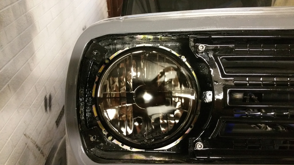

You can see the front of the mounting ring here it's just bolted to the light pods in the shaped hole o cut
And the back this is where it's too big for standard mini fitment

I'm glad it ran even with no exhaust it was still exiting. It was fibreglass dust from where I installed my headlamps last week

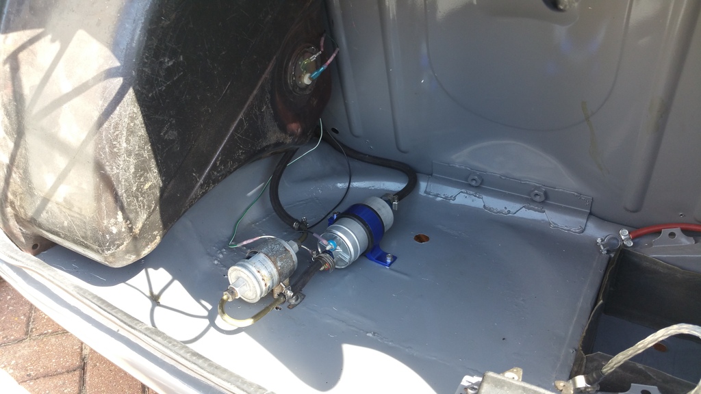

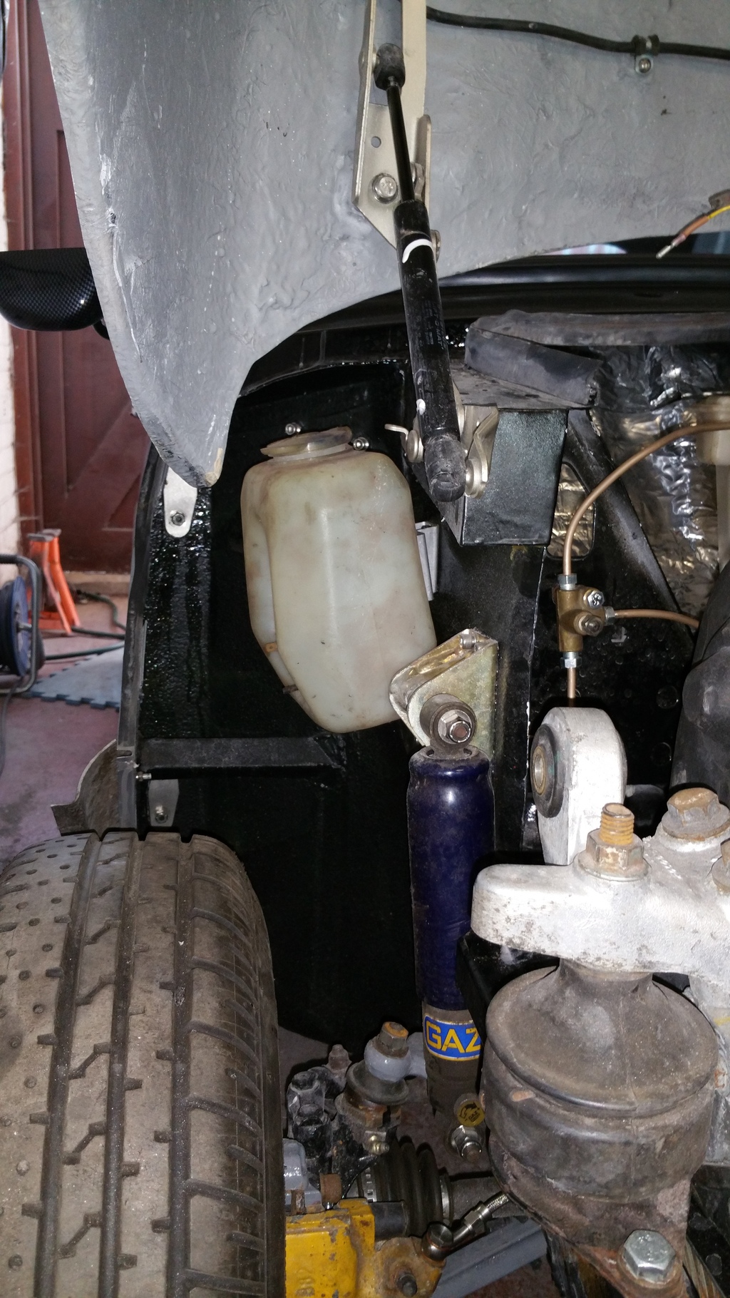

Still plugging away
After giving up on my fuel tank I got a 044 pump and mounted it in the boot along with the filter to tidy up the bulkhead
Finished off the exhaust

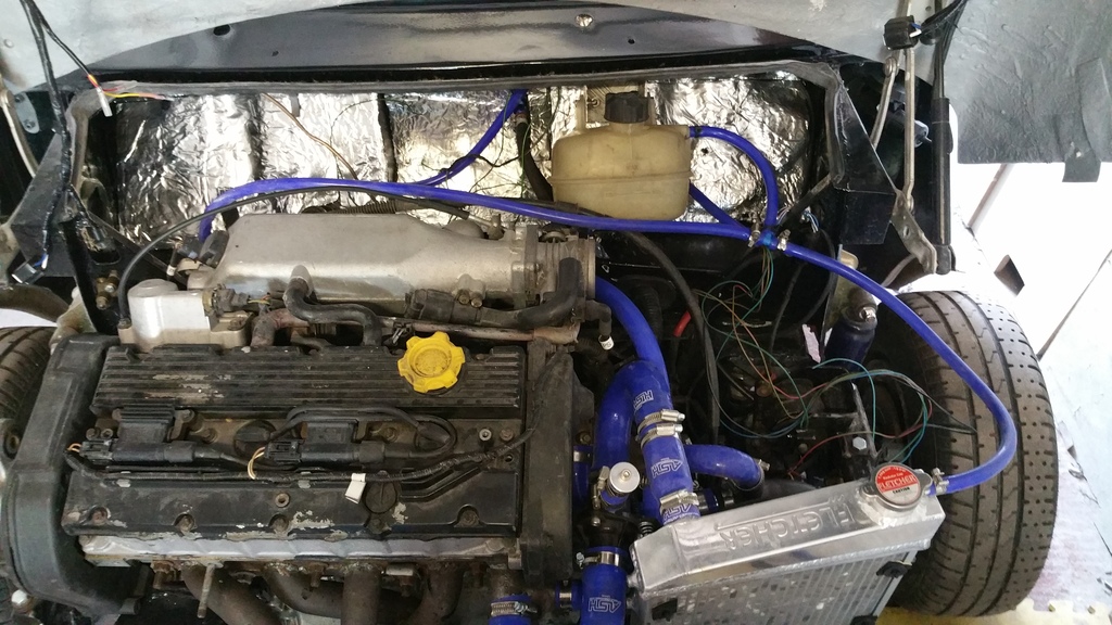

Fitted some sound deadening to the bulkhead and made a bracket for the expansion bottle and fitted it and plumbed in the rest of the cooling system I've just looped the heater for now leaving it out

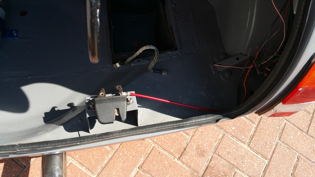

Fitted a boot release cable

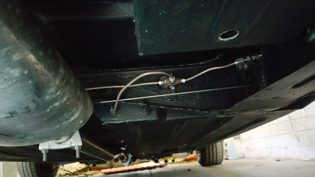

Rear brakes all done
And finished off the gear linkage and fitted

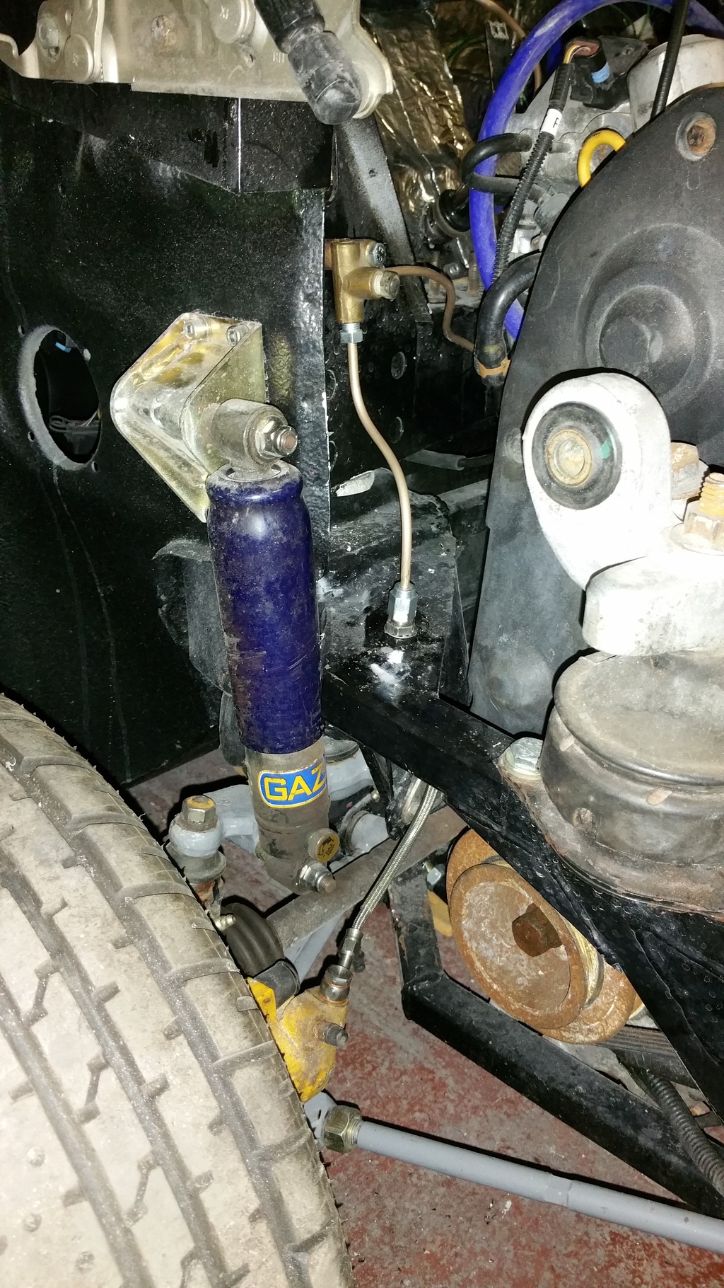

Front brakes and wiring the wiper motor and washer bottle left then tidy the inside

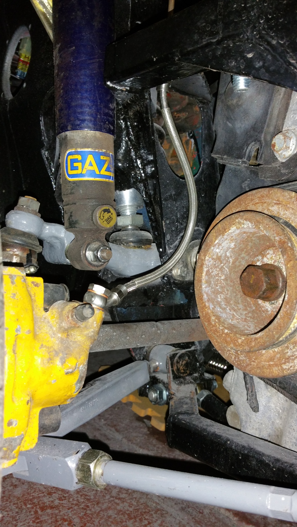

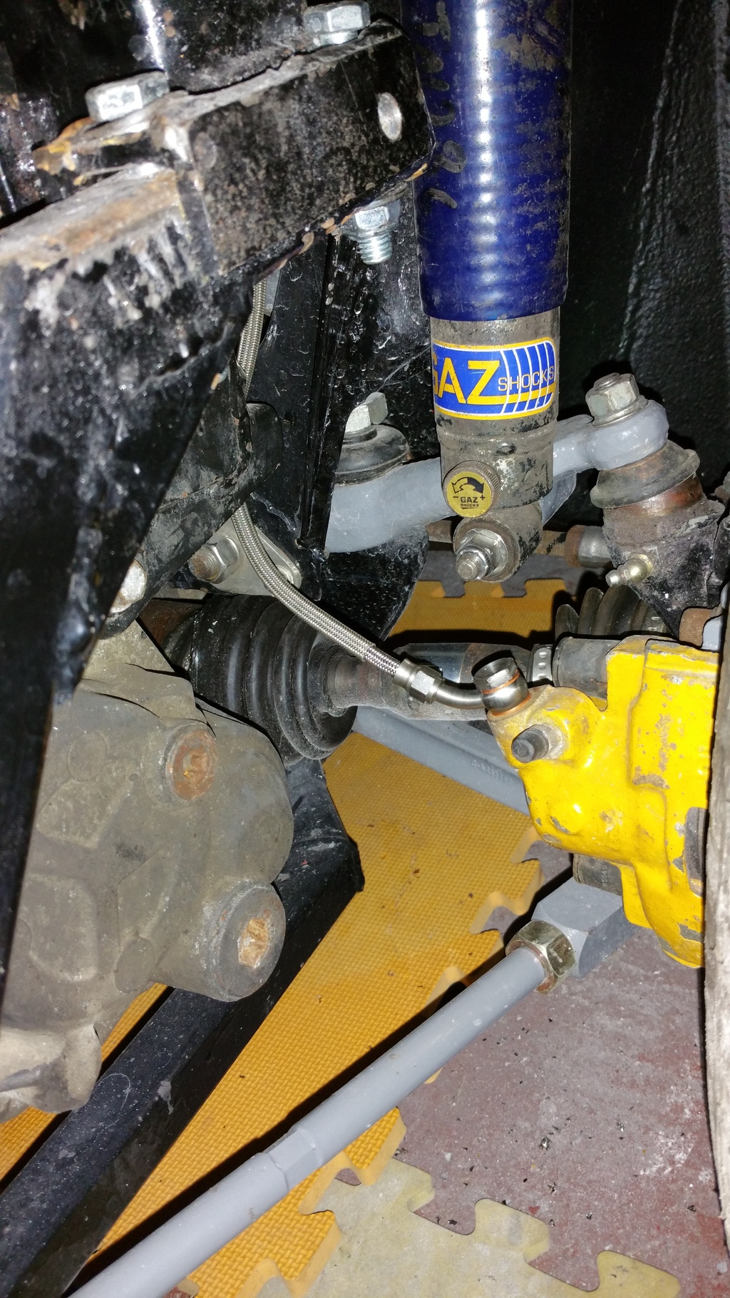

Posted 17 June 2015 - 06:31 AM
Front brake lines sorted

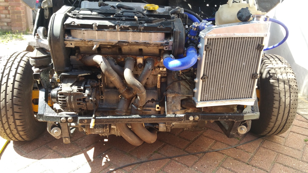

Posted 19 June 2015 - 11:39 AM
Got a few more bits done
Made a blanking plate for the heater air intake and fitted washer bottle and Brake master
Then took it for a little drive no videos of driving but got one of it running up to temp

Then disaster struck

sorry, what was the disaster Darren?
Water was coming out from the spark plugs!!

Posted 19 June 2015 - 03:23 PM
It would seem to be standing water from when I jet washed the engine down I'm going to run it tomorrow and let it get to fan cut in temp and see what happens
