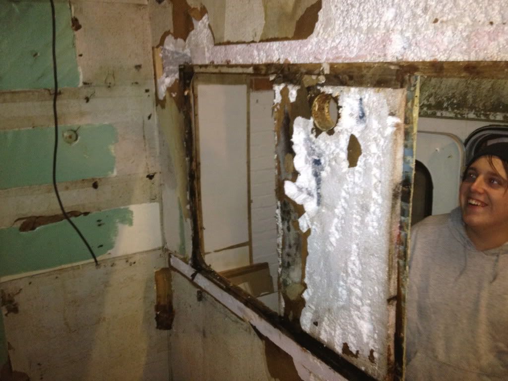

Its odd, the blue aluminium didn't match the rest of the ally on the right
In fact, since the wood was rotten it seemed to just start peeling away... so i gave it a little encouragement
Edited by maryquant, 04 April 2012 - 11:15 PM.

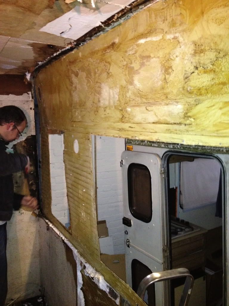

More cabinets out
Posted Image - ally definitely doesn't match
the rot extends right to the back of this wall
Edited by maryquant, 04 April 2012 - 11:24 PM.

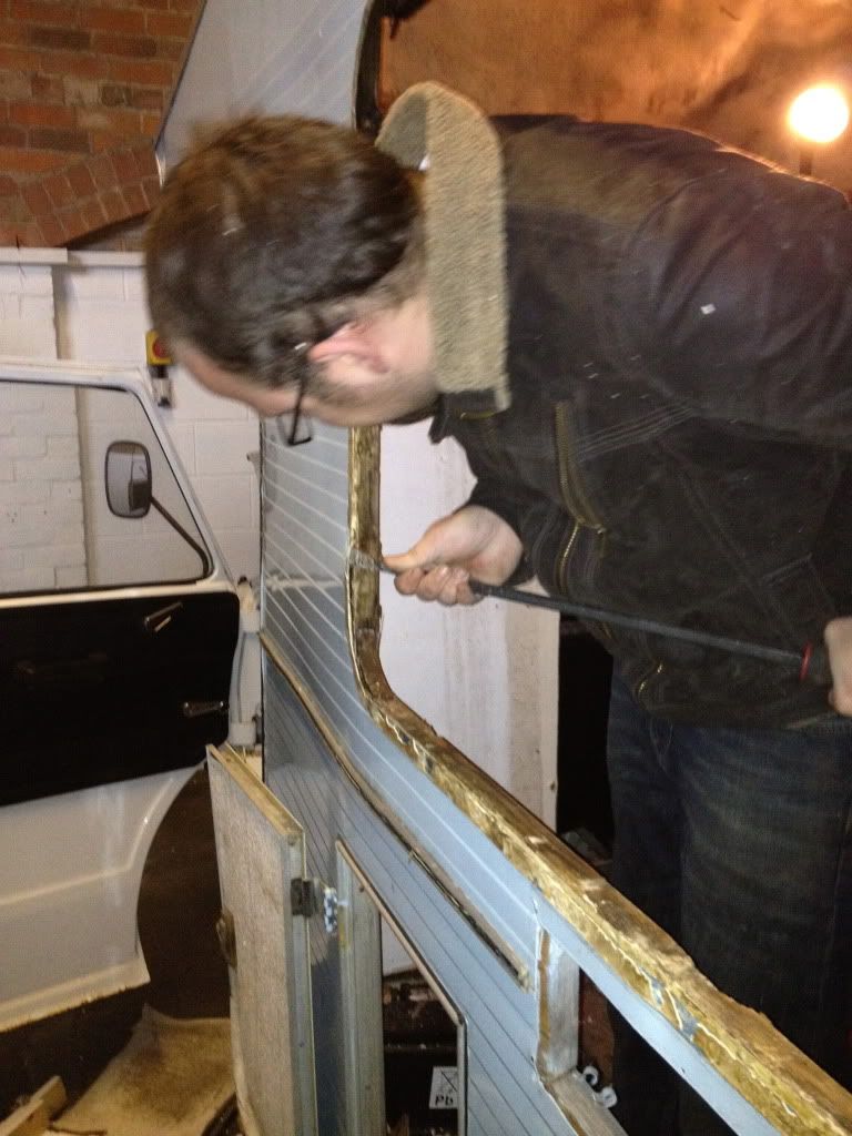

Separating the panels is still proving difficult
I better be careful i don't slip with that crowbar.....
Edited by maryquant, 04 April 2012 - 11:46 PM.

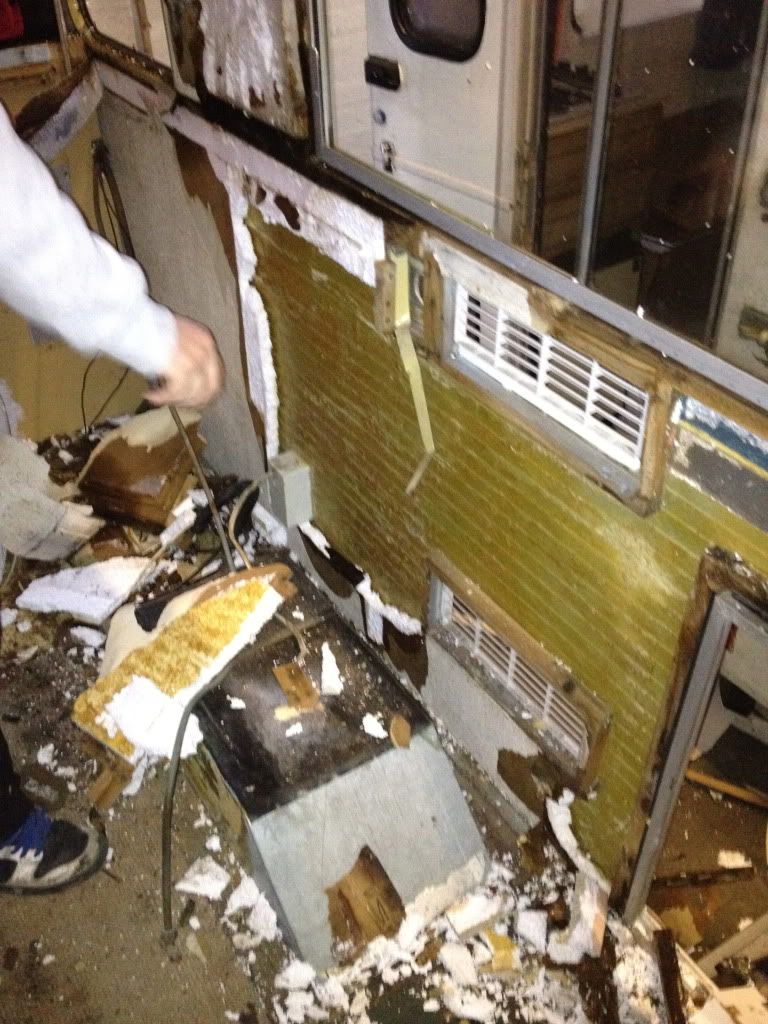

This is just awful
Its coming off..

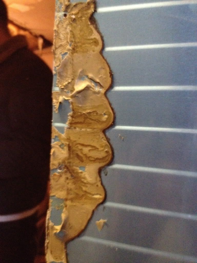

Thats a bedford stripe - which means that used to be the outside :o

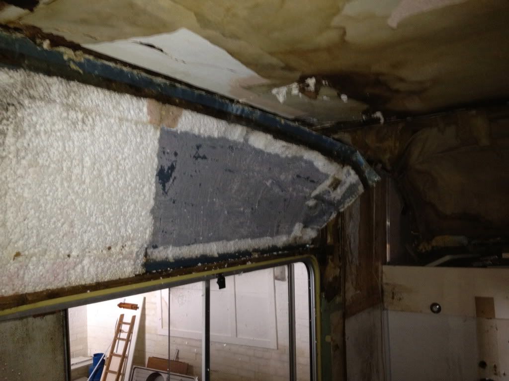

Posted 05 April 2012 - 12:09 AM

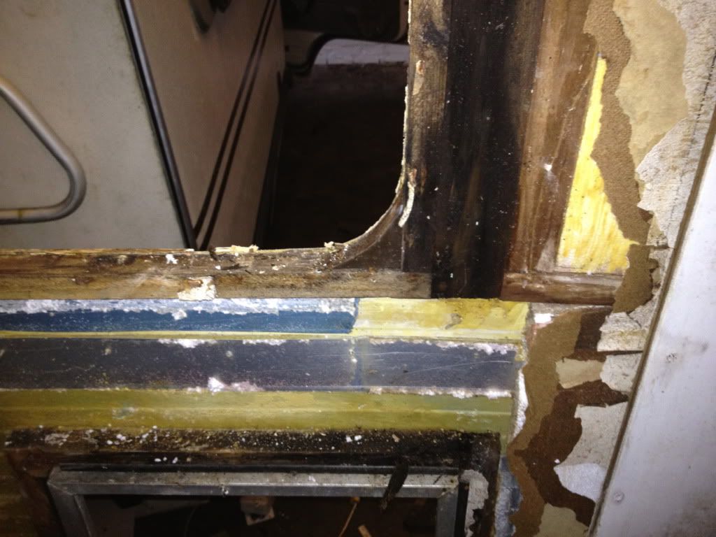

This is the external skin now exposed, its clearly not the original and has been literally nailed in over the old one.
The top and bottom wooden rail that it was supposed to be secured to have decomposed, so it needs some major work to make watertight and sturdy again.
Edited by maryquant, 05 April 2012 - 12:10 AM.

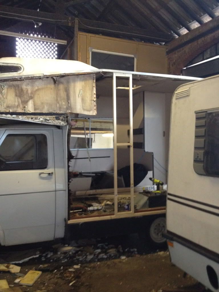

Had a nightmare today with angles/measurements/cutting tools so didn't get as much done as I had hoped.
Managed to build a little wall to support the roof while we reframe the bulkhead, the chipboard is being replaced as it is completely rotten but there was nothing left to measure from so having to do it by eye, which means cut, fit, take off, cut, fit, take off, cut, fit, take off etc.... Hopefully this weekend I will get it all back in line.
The section over the cab is literally hung from the main framework of the van, which is fine if you have a 4 year old climbing up there but not great for a teenager. I want to fit a better way of supporting the bed without it affecting the roof panel - should prove tricky.
Dinner is ready and photos uploading, so will post pics here shortly.

Now you can see the bottom rail, which is starting to be affected by the damp. Im not a welder so ill have to protect and bodge this rail...
Much better, bit of red oxide on there.
And the first guide piece fitted. Finally got some new wood to measure from.
Simple wall installed just to prop up the roof, this will probably end up coming out to take the window.
Sealed with CT-1 Snag list illiminator. Awesome stuff.
Wide angle shot...
