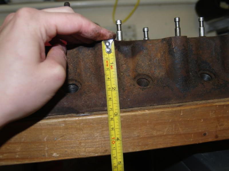

Right,
I have the measurements and some photos to assist those who are as unsure about these things as I.
Measuring the total 'head' height
uploads/monthly_10_2011/post-52659-0-53004900-1319113693.jpg
Measuring the depth of the oil hole
uploads/monthly_10_2011/post-52659-0-95657600-1319113701.jpg
uploads/monthly_10_2011/post-52659-0-23924800-1319113700.jpg
uploads/monthly_10_2011/post-52659-0-84133400-1319113696.jpg
uploads/monthly_10_2011/post-52659-0-47293500-1319113698.jpg
So in conclusion
(A) Total head depth = 2.750''
(B) Oil hole depth = 2.530''
(A) - (B) = 0.220''
So my oil hole is not as deep as it should be - is this wrong or within a margin? Also I have a very wobbly themostat stud, is that fixible with a helicoil?

0.22" between bottom of hole and faceof head is just fine.
At 2.75" total head casting thickness it looks as though it's never been skimmed, so you have a really good head there capable of being skimmed to get the comp. ratio exactly as you want it.
In all, a result!

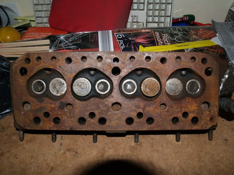

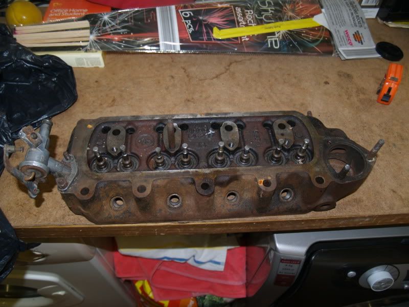

ive just got the same head and seems to be pretty similar to this one,
dont think it skimmed,
dont have any calipers so i roughly measured it with a tape :L
will have to get my hands on a set of calipers from my old school, im sure they wont mind haha
what do you think?
needs a good clean..
and is ther another way of increasing cr without messing with the head??
Edited by coopdog, 25 October 2011 - 08:45 PM.

I think your cylinder head looks much better than mine. Mine is much more rusted - notably around the area of the thermostat. I think D-top pistons are the way to go without skimming the head or even more raised ones than d-top ones (ready to receive corrections on that assumption)
