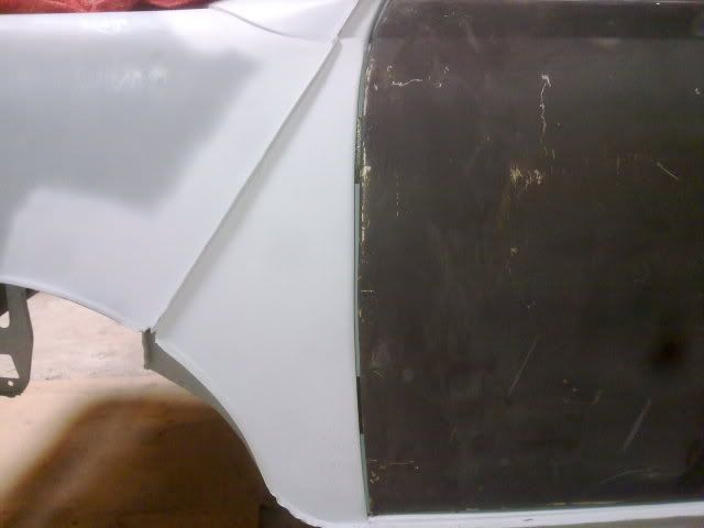

right then with the time booked off work the 4 day push is on from the 17th to the 20th of feb. so the plan is to reskin the new n/s door , finnish the repair to the n/s qurter panel and fit the new back panel , and if i get time spray the underside of the car and engine bay .( well heres hopein )

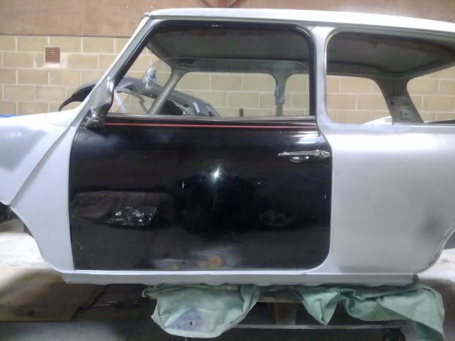

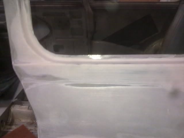

day 1of 4 of the big push part 2

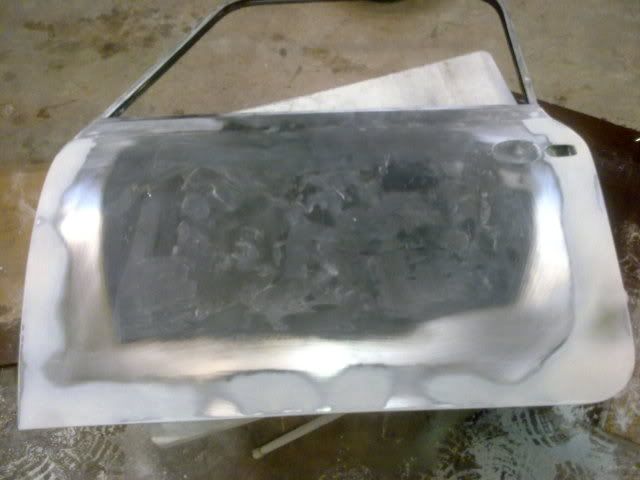

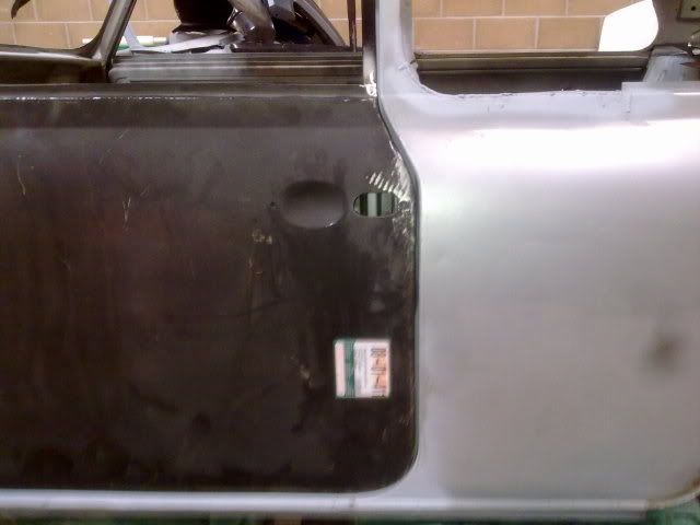

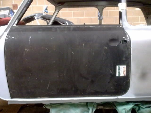

well a good day test fitted the new door i got the the show and it fits well so with the rust on the botttom i had a skin from the old door so thinking it best i fitted it . test fitted the door back on the car and alls well so put a little filler in it just to take out my hammer marks , and will prime it 2moza

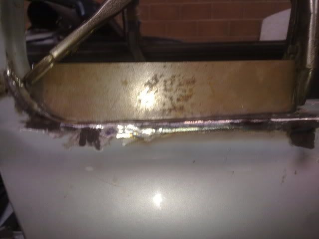

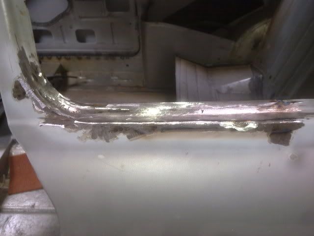

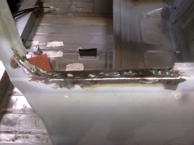

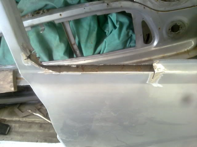

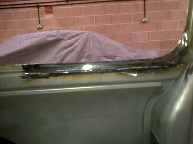

if you look back at my old posts you will see this started but not finnish as i ran out of gas lol
so i got round to finnishing it today put a steel plate in and welded but needed to make the lip for the window so what i did was welded a bit of steel upright and then cut it down to suit grided it all down with a skim of filler and got this whitch i think looks good

looking good that door, shame about the hammering marks, are you using a rubber dolly to absorb the hammer tapping?? because that is required doing a job like that,.....filling is ok but try and avoid that
