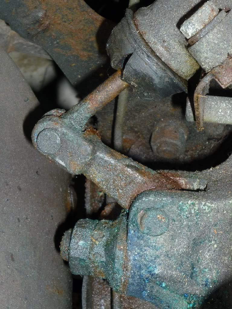

well im about to start taking bits out around it to try and find the fault. heres some pics just incase anyone can see any thing that looks not the norm.
what direction will the lever move when the clutch pedal is pressed down, just want to i know im wacking it the right way.
also im failry sure the fluid in the master cylinder is right but if that was low would it have this effect out of interest.

Looks like the rubber boot has split now, im guessing it didnt like the penetrating oil. it only gets better still no clearer on whats seized

It looks like it would be a minor miracle if it moved at all!
Unbolt the slave cylinder & sit it so you can push the piston back down the bore. Lever, or hammer, the pushrod & clutch arm back & forth until they are free too.

from the pic can you tell me what way the lever should move so im hitting it the right direction

You can see the ends of the clevis pins that the mechanism pivots on. Slot a ring spanner over the rod and rotate it about the pin once that's free slide a bigger spanner over the arm & do the same.

right have operated the lever and now clutch pedal goes down and back up again. the clutch big bolts on the end of the housing have now moved out but there seems to be no spring return, so guessing clutch is now stuck in the out position
