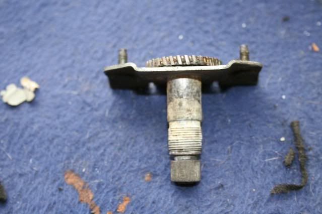

all out and started to clean it up, stripped out the chain cable and tested the motor, all fine. However thi part is seized and I can't seem to get it apart to clean and free up
A few pictures if someone can point me in the right direction.
Thanks,
Graham

That's a wheel box and you've pretty much stripped it as far as you sensibly can. If it is seized and you can't free it with penetrating oil/WD40 and working back and forth then it will need replacing:
http://www.minispare...=...3422&title=

brake cleaner is good for cleaning...like mentioned just keep working the spindle back and forth it should free off.

it's freeing up but I will try the brake cleaner,. Do I dunk it in and leave it of just spray and wipe??

spray it into the seams ;D and try turn the spindle
What is brilliant stuff is paint thinners, 5 litres about £10 ^_^ that you can pour in a pan and soak it :wub:
