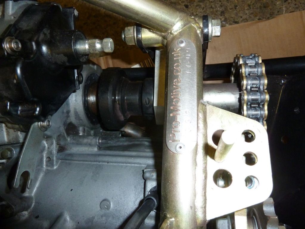

So, as I may have said, engine work pretty much done - barnett clutch, new rotor, stator, plugs and baffle in. Still need a voltage regulator and the coil sticks and waiting for a new air temp. sensor but have got hold of the coolant sensor and exup servo and all the mods are done for the pro-m kit. Got the baffle from Johnathan Rarity who was really helpful and Larry at PDQ in Taplow has worked on the engine and been brilliant - they've got a rolling road there specififcally for BECs which they put together themselves so hope to get it set up on there in the end.
In even better news, Dave Kimberley, who I bought all the GRP from, has now built up the engine and frame - I hope the pics below go down well. The more people work with the pro-m kit the better it seems they like it and comment on how well thought out and made it is. Few bits outstanding on this part of the build but getting there.

I've got some lowered ball joint spacers too :)
I don't know if that is just a mock up but your steering arms still need a locking tab under the bolts

Good spot on the steering arms, that was part of the reason I posted so many detailled shots, just wanted to make sure all was well... I'm missing the spring from the tensioner at the moment as well.
