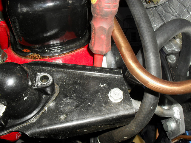

3) Undo and remove the 2 bolts in the top radiator mounting bracket that go in to the Thermostat housing

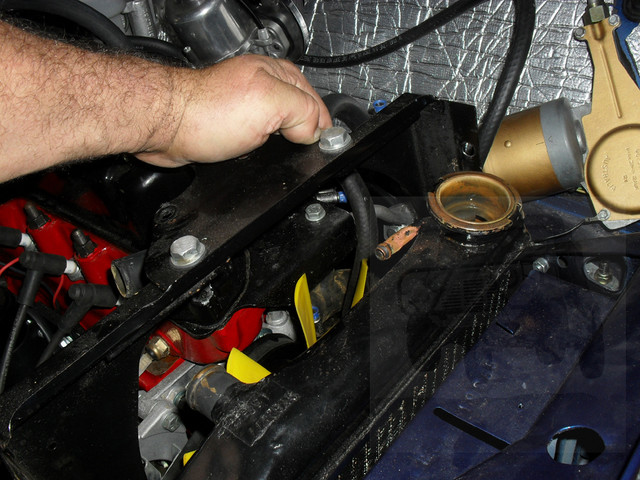

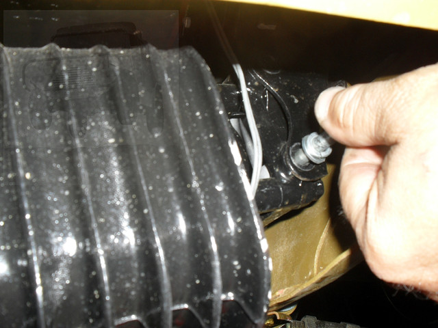

8) Remove the screws that hold the TOP only of the Radiator Cowling in place. Most cars have 3 screws at the front and 2 at the back. This car has been modified and used bolts.
Rear bolts
9) Remove the top radiator cowling. Should just lift out, some need a jiggle.

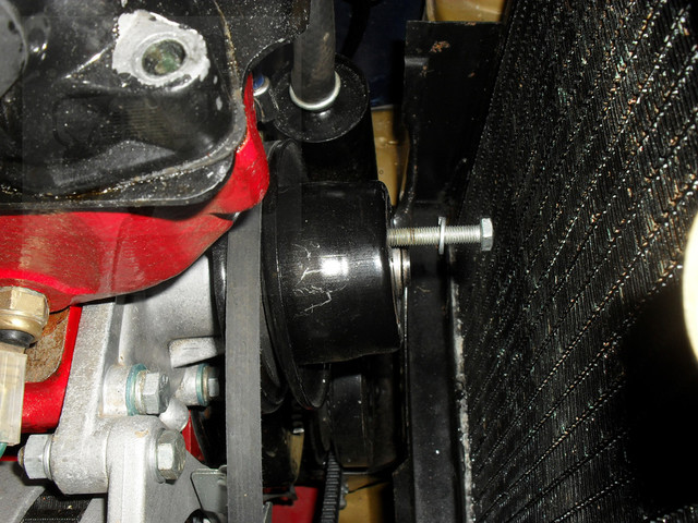

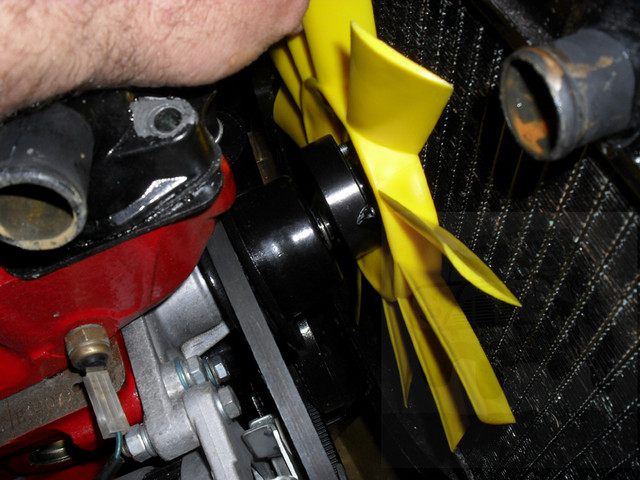

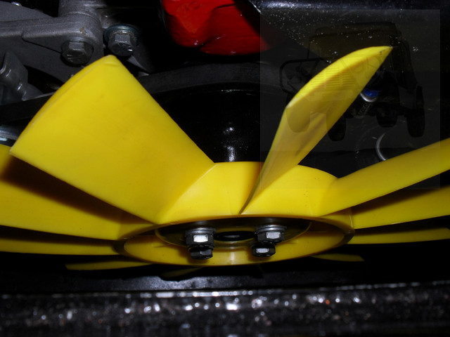

10) Remove the fan. I like to do this to avoid damaging the core, it’s only 4 bolts
And there is plenty of room to get your hand and a spanner in there
Careful when taking the fan right off, it usually has some spacers in there. This one has one big fat spacer.

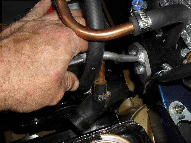

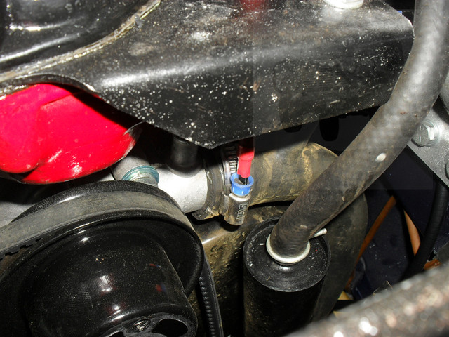

11) Undo and disconnect the Heater Hose (if fitted). Some connect, like this one, to the Bottom hose and the later (Australian) Clubbies & Mokes connect to the front of the Radiator. either way, it needs to come off.
12) Undo the Bottom Radiator hose from the Water Pump (This one has the Australian LH Engine steady fitted).
Bit of a wriggle
And off she comes

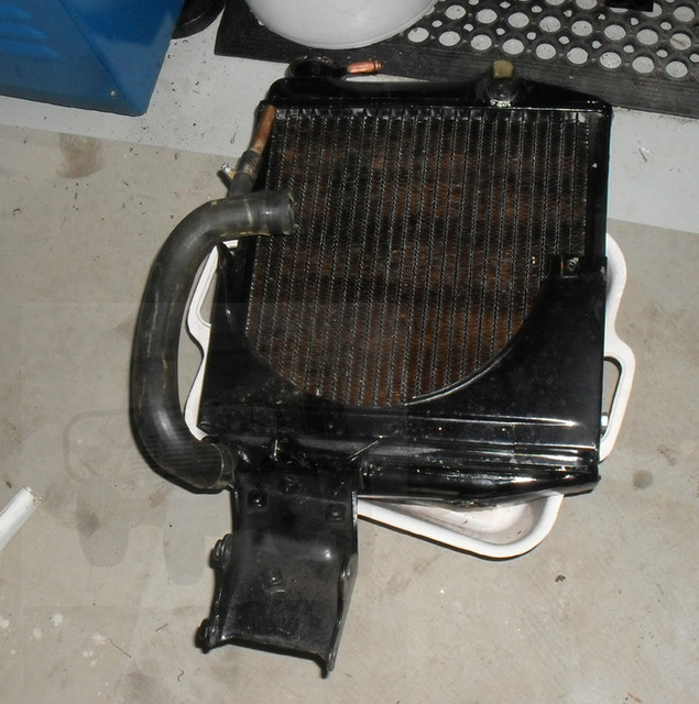

13) That bolt we left in the lower engine mounting bracket, now we take that one out
14) Then we lift the Radiator out!
Easy as!
