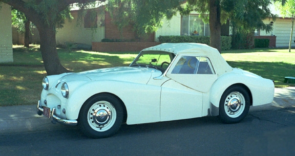

Does anyone here know if there exists 12" steel rims, on which you can put hubcaps, that will fit a mini over Metro turbo 4-pot calipers? Preferably they should be 5 or 6" wide but the width can always be modified. I'm after 12" rims with a nice retro-look. Something like the rims in the picture:
http://www.dctra.org...7/07/tr2-v1.jpg

To fit hubcaps to 12" steel wheels you need to have three tabs welded onto the wheels, similar to the 10" steel wheels to hold on the hubcaps. Also im fairly sure if you do that most hubcaps of that style will fit aslong as they are for 12" wheels such as the hillman imp.

Hillman Imp wheels & hubcaps >_< They'r almost identical to the Mini's 12" std. steels. But they have 3 lugs for a hub cap.
But they are - like the Mini wheels - only a mere 4.5" wide. Maybe you could get them banded.
The following pictures show Mini steel which have been banded to 5.5 or 6" and Austin Healey hubcaps of some sort. No tabs have been welded on, but screwed.
-> www.custom-minis.de
