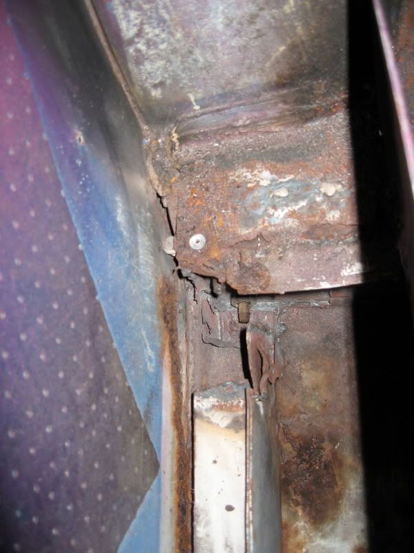

we decided that if we were going to do a decent job on paint, we ought to have a bit of a dig into the filler to see what was going on underneath.
guess what - it was rust. Rot and rust - and lots of it. The poor old girl was in terrible shape, most of it hidden by an extremely poor quality body kit.
anyways, we've dug out all the filler and decided best course of action is to chop out all the bad steel, and the bad repairs, and at least try to make a decent job of it all.
Dot as ever is very patient, and agrees the final result is worth the wait. Its gonna take a bit more steel than we originally thought...............

Those pics that Roofless put up don't really do the rust justice!!
There's extensive rust in the roof/scuttle/companion bins etc
Also poor repairs on the inner and outer sills, accident damage on the rear 1/4's
I would guess I've got about 50hrs of welding and rectification to the shell just to get it to the stage where Roofless can start being able to prep it for paint.
