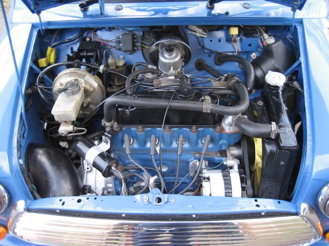

There should be a plate to cover that......
Can just about see it in this pic.
Paul.

Yep, my 1979 Saloon as this plate behine the air filter case. My 1978 Pickup for some reason does not have this, but is has the centre speedo with the plastic cowel. I guess I will need to remove this anyway if I am fitting a full dash board.
