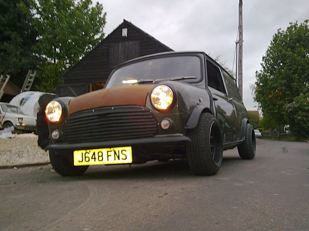

Not sure if there P5000 but there certanly stretched :D there on Samozzies van :P

http://www.tyrestretch.com/
The stretched tyres arnt too small diameterwise just on width
tyres these days have incredibly strong sidewalls also when you run higher pressure in your tyres they seem fine
if you want to see dangerous check out some off the extreme ones on the website
im running pirelli p7000 165x55x13 and they seem fine :D
i love it as im the only one i know off running stretch on a mini :P
