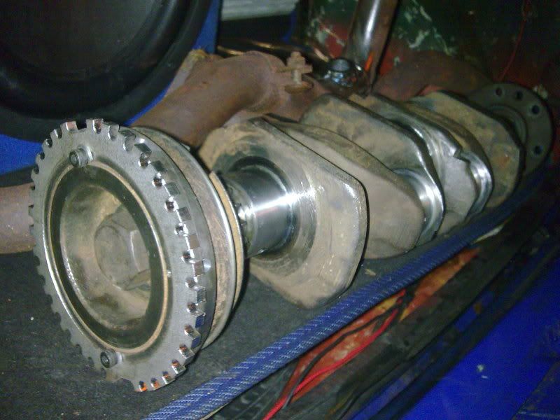

Jackman runs this trigger set up, I set it up for him, as does another club member. I am now not keen on any trigger wheel that is fixed with the pulley bolt since mine moved and retarded the ignition by nearly 30 degrees.
The only real advice I would give is make the trigger wheel adjustable and use a fixed sensor bracket, and then adjust the air gap from sensor to tooth to <1mm it makes life so much easier to set it up correctly. As said previously you need to remove one other tooth directly oposite. You can see that in the picture below
Such trigger set ups are easily achieved like the one pictured below and available from here http://trigger-wheel...ore/index1.html The pulley was machined down so the trigger wheel would fit and sit just a little proud, the bolts then clamp the wheel onto the pulley. I used three bolts, I didn't like the idea of only two bolts.

When you set up the trigger, set the engine to TDC on number one cylinder, then adjust the trigger wheel so that the sensor is dead center on the gap of one of the missing teeth. Again make sure the missing teeth are direct (180 degrees) oposite each other. job done :turtle:
