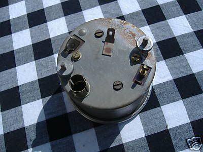

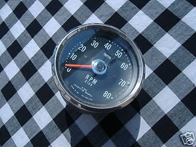

Ah so would this one work on electronic ignition?
#5 dklawson
dklawson
  • 10,923 posts
  • Name: Doug
  • Location: Durham, NC - USA
Posted 27 April 2009 - 12:41 PM
There are always exceptions... but I'd say "no".
You are showing an RVI tachometer. You should find the letters "RVI" on the bottom of the face. The other tell-tale bit is the threaded brass post sticking out of the back on the right side. That post is for the clamp that holds the inductive loop to the tachometer.
As mentioned in the quoted text above and several other threads on this board, RVI tachometers generally do not work properly with electronic ignitions. Like I said... there are always exceptions, but I wouldn't count on this working with anything but points.
Thanks, it was on eBay and wanted to make sure!
