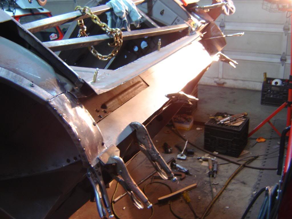

this is the bit in behind the rear quarter... had to build 8 peices to get it back to the original shape you see there....

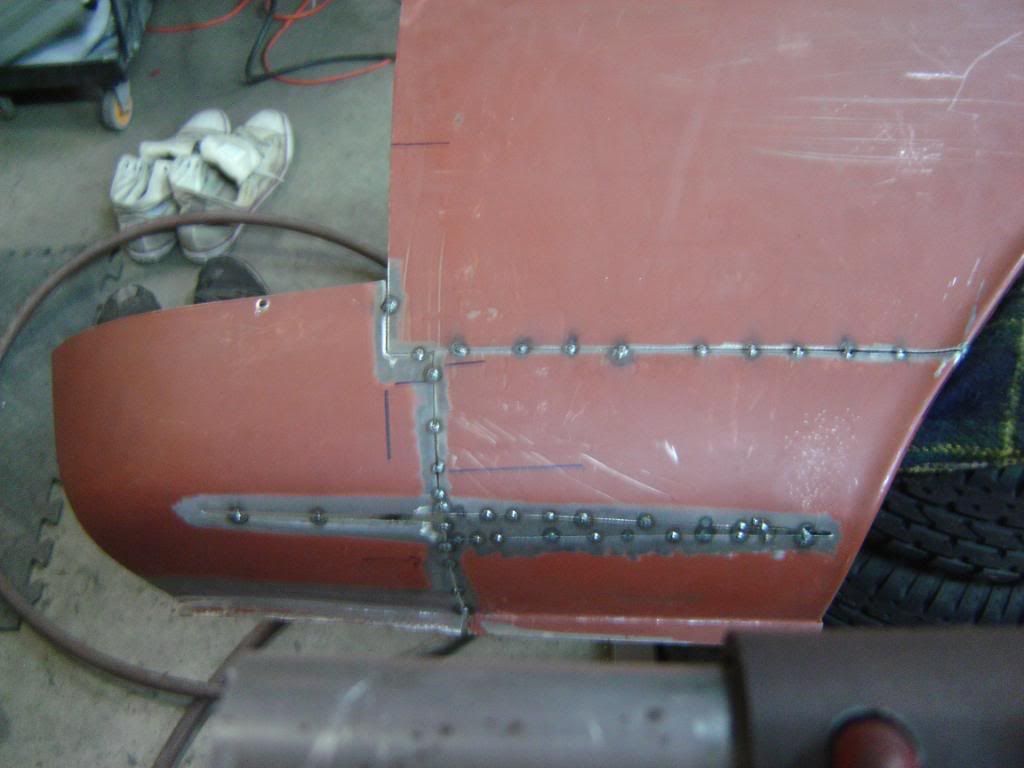

this is a better picture of the quarter i had to section/splice togetehr to make fit... going to grind the tac welds inside and out and hammer and dolly it perfect and then tig weld it so i can get a perfect shape...

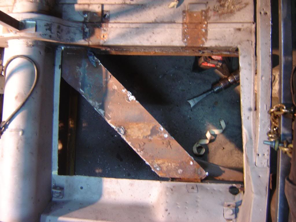

mock up of the 1st of 2 inner sills and the front section of the inner rear wheel well...
front part of inner sill again....

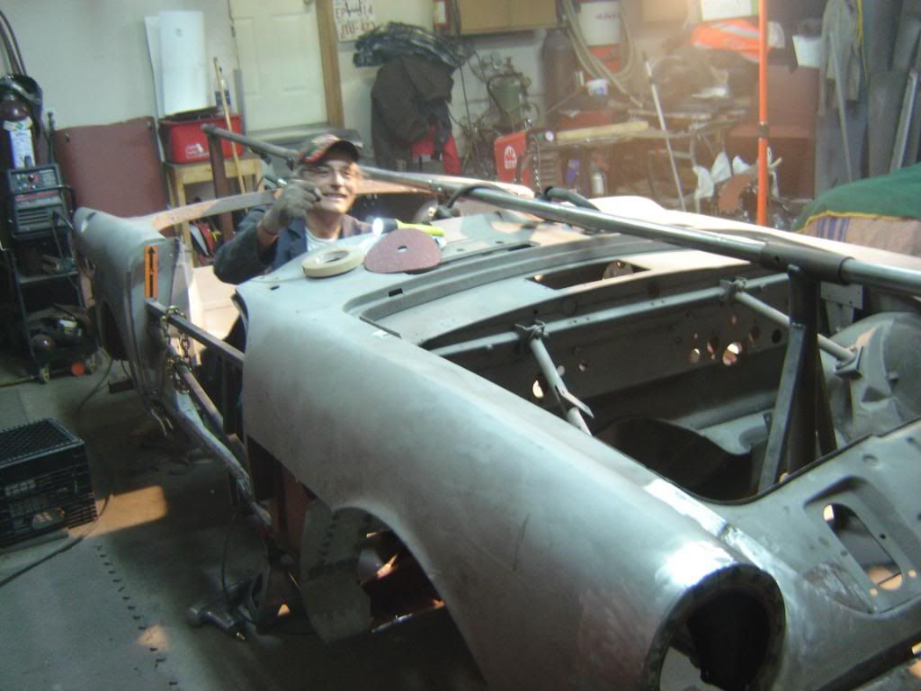

yeah so worked on it a bit today and my dad had the day off as well so he was out there working as well...
inner wheel well i built.. ready to be welded in..
inner wheel well patches built and tacked in place... little bit more work and it will be done..
tipped it down to be able to work on the floor pans a bit easier..
my old man grinding on the rear floor pan... (so many spot welds)
rear pan out...
a comparisson showing the useless purchased rear floor pan going to have to hand make the rear in the same fashion as the front...
dad getting a wee bit ahead of himself here making car noises....haha
