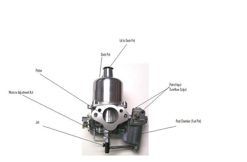

if you have a clubbie it may well have a HS4 SU carb, take the lid off the fuel pot and see if its all working ok. you may find a brown silt in the bottom ( I found a pot screw once) this silt can get into the choke tube and it play havoc with setting up the carb clean it all and bobs the neigbours dog!

Thanks for the help. Still new to carbs, is the fuel pot near the dash pot? With my next order, I was planning on ordering some new leads, cap, and rotor. I have never replaced the contact breaker points or condensor in a car, what are those?
#8 liirge
liirge
  • 4,097 posts
  • Local Club: EDMC AND MMC
Posted 26 December 2008 - 07:54 PM
If its an HS series Carb its the pot to the side of the Carb, the lid is held on by 3 screws, the fuel pipe will attach to it.
