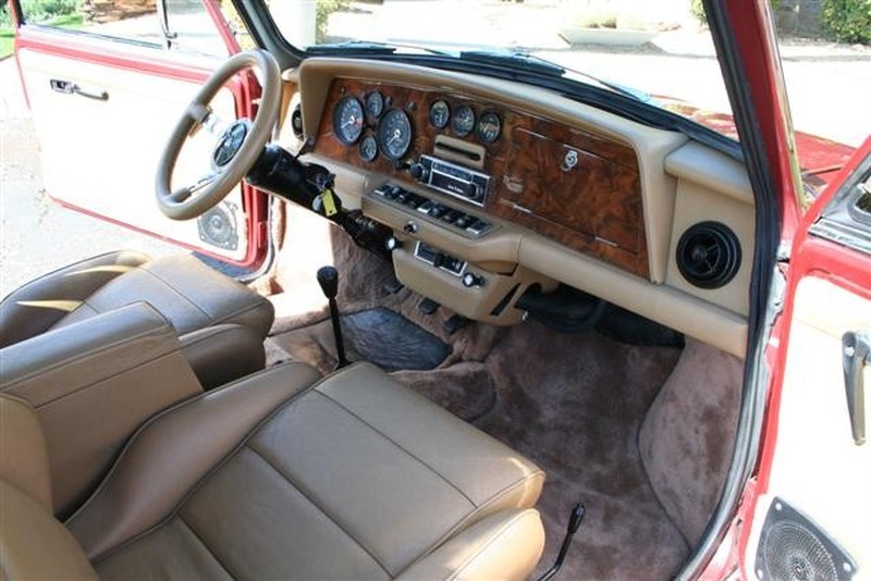

Not going to lie I think that dash looks a bit of a mess. I much prefer the first picture shown of a nice wooden one showing some nice grain and keeping everything in order and methodical as opposed to what seems to be sporadically placed dials, but of course this is just my view.

So what kind of wood are you using there then?? X
Errm, i think its laminated chipboard to be honest but not to sure, problem with chipboard is if it gets wet it'l swell up and render the dash useless
MDF is popular for homemade dashes, sub boxes, bootliners ect.. but i think its too thick for whats needed, yes MDF does need to be about 10-18mm for strenth but if you're covering it id get some perspex sheet and make it out of that, upsides to perspex is its waterproof and need no sanding of dust residue being left over (wear goggles when cutting holes in it though SAFETY FIRST )
If you want the luuuvvly wood effect of the dash i first posted then get yourself down to B&Q and ask what finishes of laminate they have, buy the one you fancy and get some bonding glue and stick it to the perspex (Jobs a gooden )
